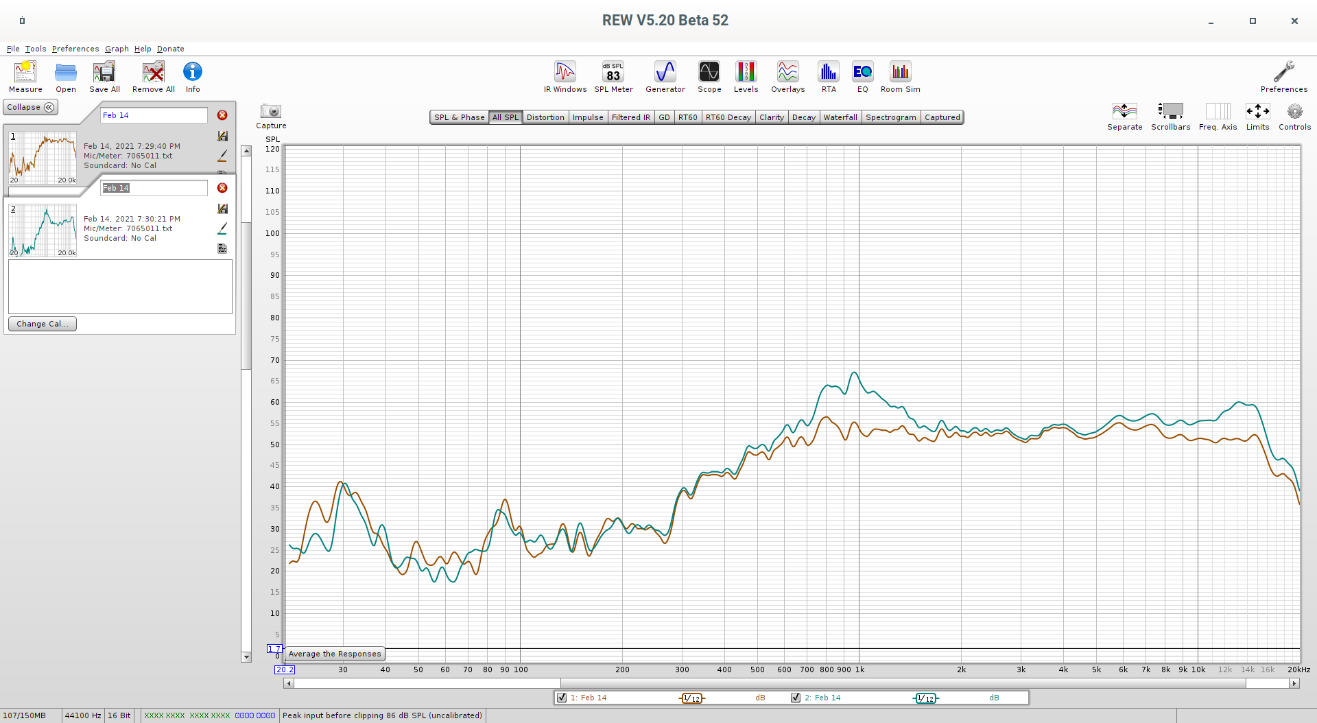

A promise is a promise.
I've measured the frequency response of a Sounderlink AMT-300-02 with back cup.
Green trace is unfiltered, brown trace is with some equalization.
The peak at around 1k is worrisome, I've found it's audible without eq.
