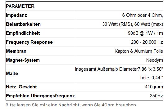

the are only 30W RMS / 60W Music Power and not 50W/100W like the B&G that Parts-express are selling...
and their sensitivity is 90db and not 93db like B&G...
but at their prices you can buy almost 4 drives for the price of a single B&G so i guess you can use lots of them...

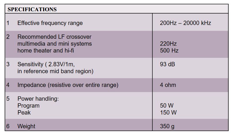

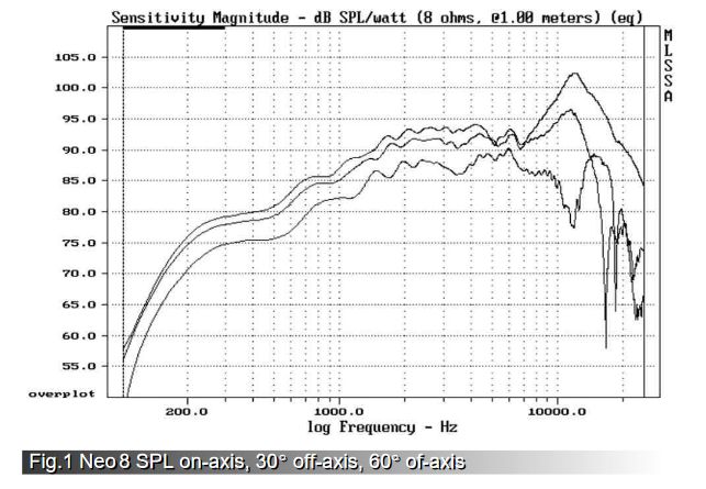

The B&G NEO 8 is 4 Ohm and measured at 2,83V (2W), the Sounderlink 1 PC is measured at actual 1W/1m. The response of the B&G shows you'll only get the 93dB/2,83V from ~1,7-2kHz up. At the suggested crossover frequencies of 220Hz and 500Hz you'll only get 85dB respectively 87dB. On 2W, that is because it's 4 Ohm. That means, you'll lose a lot of spl and can't use the higher efficiency at all. The Sounderlink is available in 4 Ohm too.
The B&G is stating 50W PROGRAM which translates to -3dB = 25W rms. Compared to the 30W (that is at >350Hz) I doubt there's much difference in real life scenarios. Much more important is if the distortion and response is on par or not. The B&G got high order distortion quickly with rising spl.

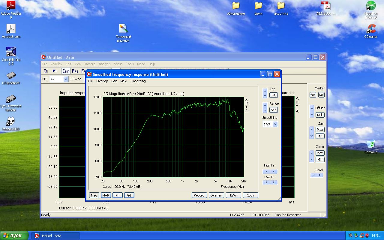

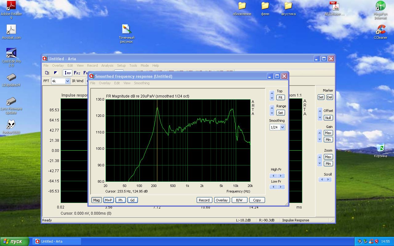

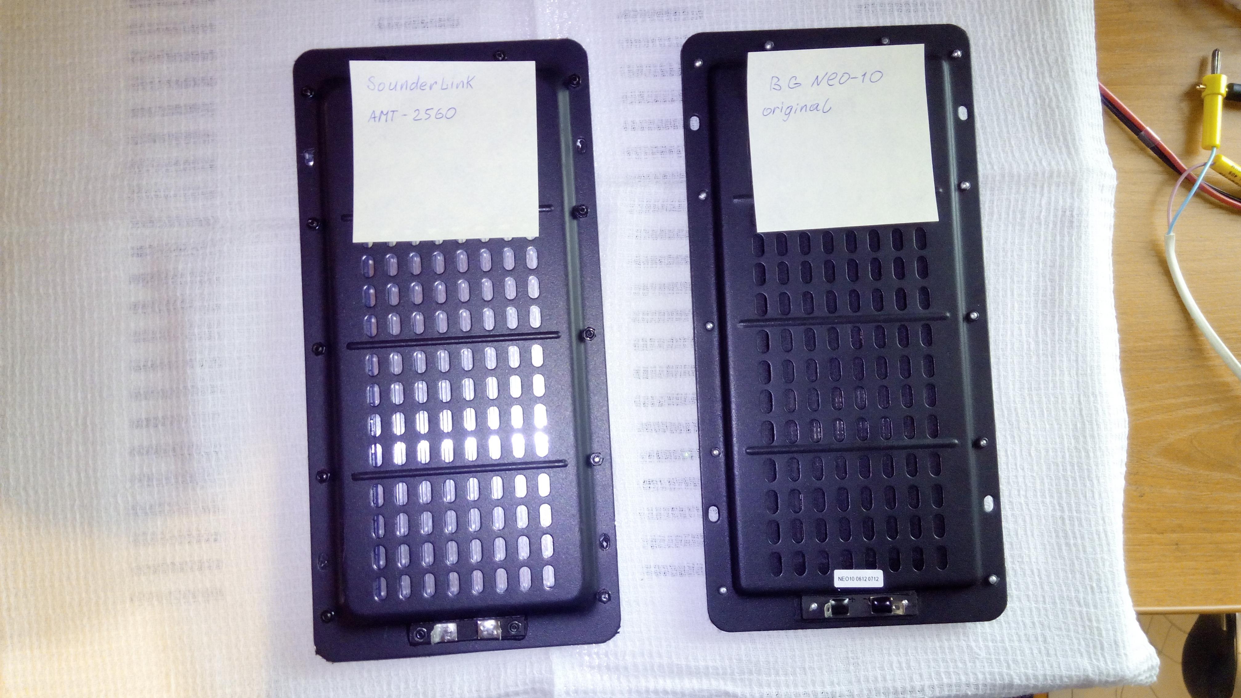

Hello. I had a negative experience when I bought neo 10. They are different from the original, the amt2560 has a different membrane (without horfication on the long side) and there is no damping inside. The flat membrane is very stretched, because of this there is a resonance of about 235 Hz. This is very well audible. The body halves are fastened with screws, not rivets
Did you try adding some external damping? For lightweight diaphragms, even a layer of grille cloth on each side can make a significant difference at resonance.
To push the resonance as low as the original will probably require something more restrictive though. Thin felt on the back side may be an option.
My experience is with electrostatics, but I'm assuming similar results will occur with planar magnetics.

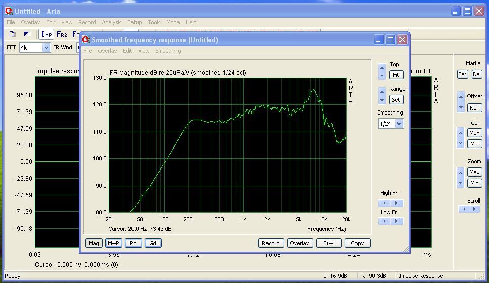

I tried damping the back side of the amt2560. Used fabric for an air filter and non-woven material. The frequency response in such damping still falls short of the original. Perhaps you need to damp two sides. The rise from 1 to 4 kHz is high. I tried turning it on in the 200Hz-5kHz range. Sounds worse than the original.
The frequency response in such damping still falls short of the original . . . I tried turning it on in the 200Hz-5kHz range. Sounds worse than the original.
As long as the fundamental diaphragm resonance is that lively, you don't want to run the input near that frequency. A more realistic comparison of the character of the drivers would be running both units from 1 kHz - 5 kHz (with 24 dB/octave crossovers on both ends if you can do it). You need to push the resonances way down to not hear them. Up to now, you may have mostly been hearing undamped resonances vs. a damped ones. It definitely colors the sound.
When using external damping, you typically need more of it than with internal. If you can make it fit tightly to the driver, that can help.

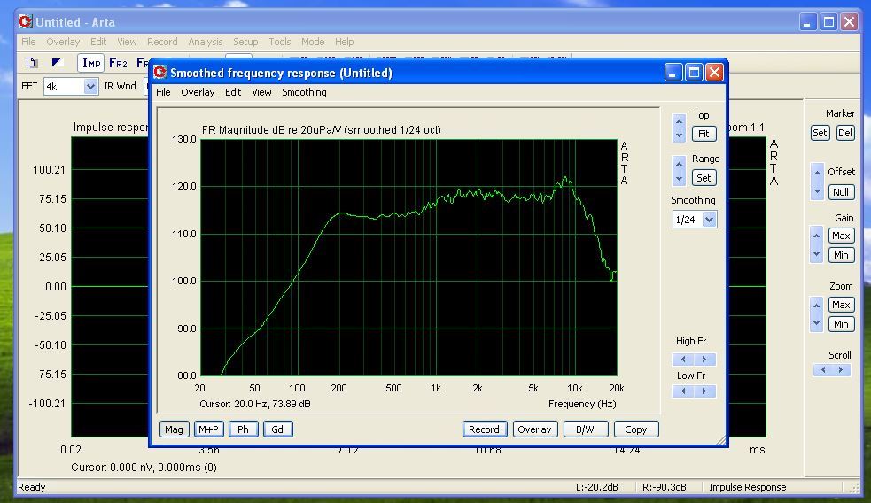

I can press the damping material on both sides with a rigid metal grill with a high throughput coefficient. Here is what the frequency response was when damping from two sides. For comparison, neo10 under the same conditions
Big improvement.
That looks like a good result for suppression of the fundamental diaphragm resonance. Was the sound quality improved (more like the Neo10)? Do you still find it lacking?
The peak at 7.5 kHz looks a little worrisome if you are trying to use the driver to 5 kHz. You may need a very steep crossover at 5 kHz to push that down to inaudibility. I was hoping that region would improve more with damping.
