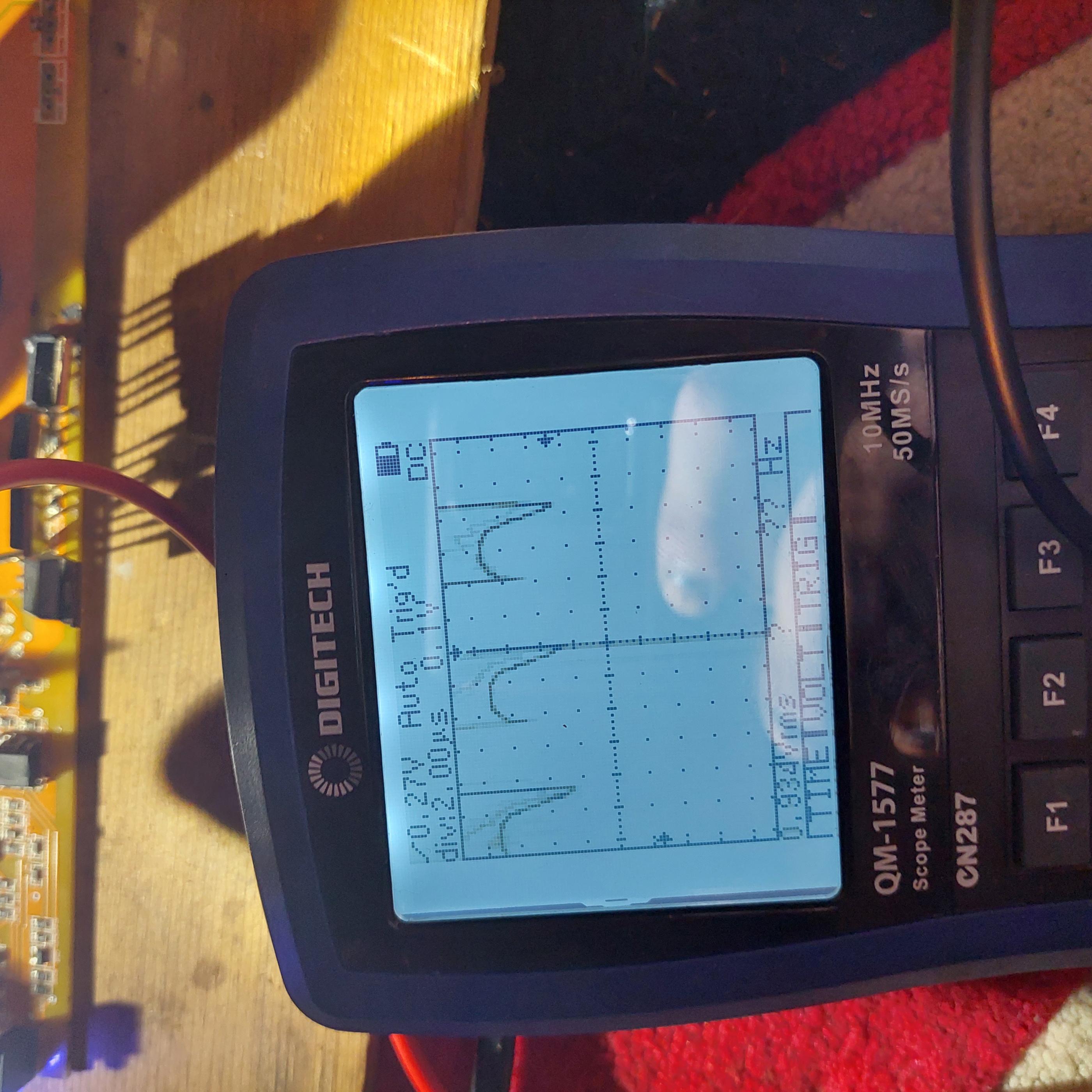

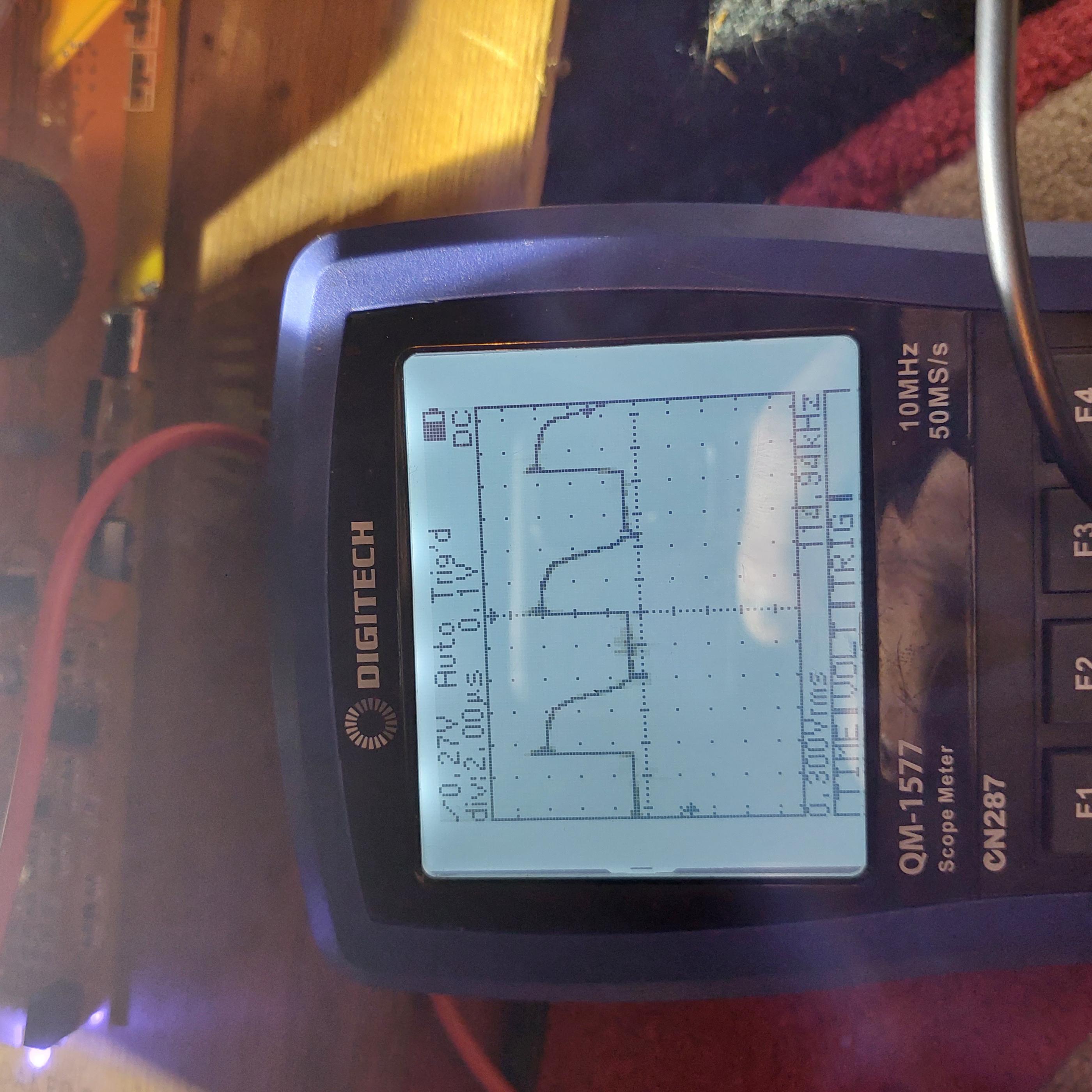

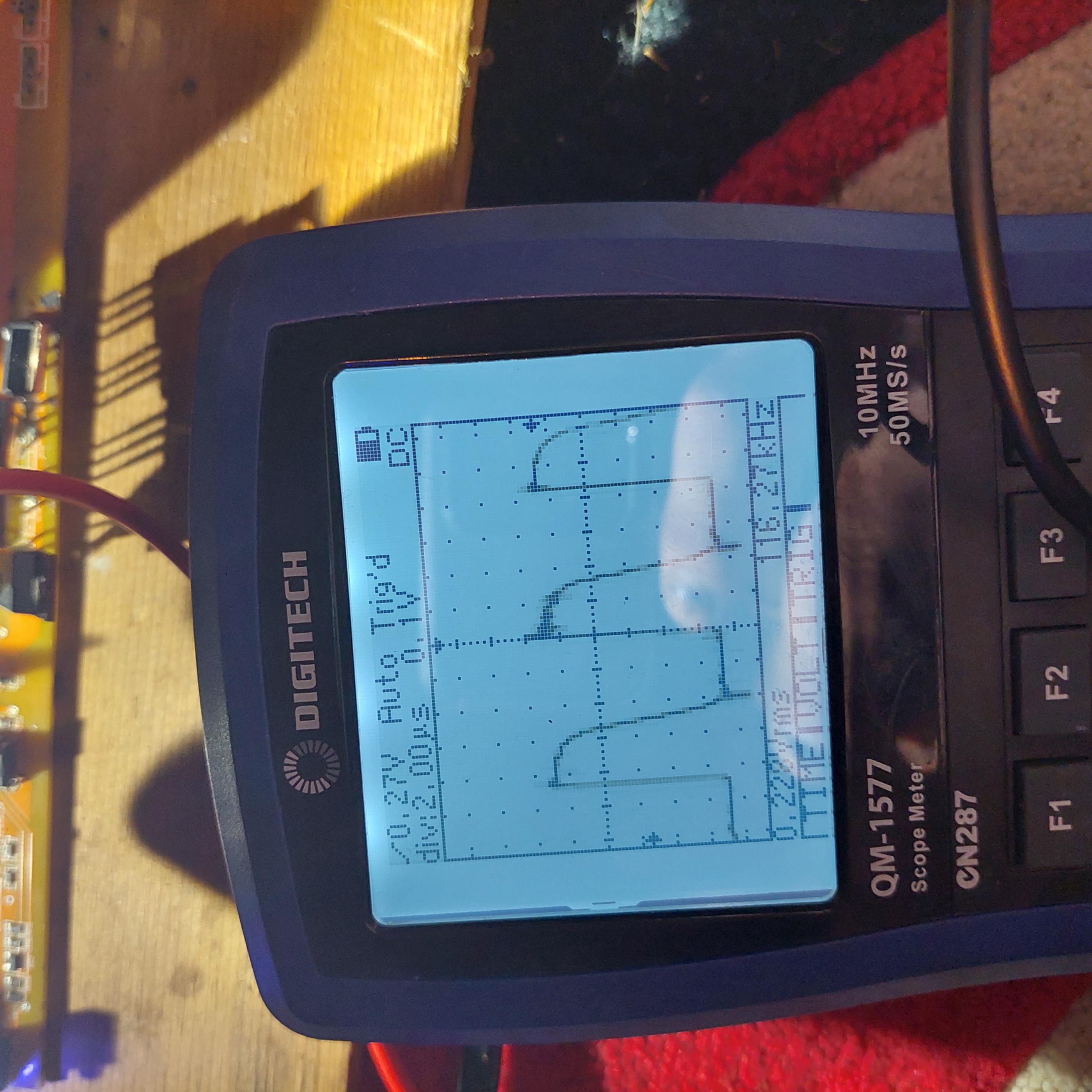

You need the scope ground on the high-side source and the probe on the gate.
Do the same for the low-side components.
Thanks for ya help Perry. Got it up working fine . Turned out there was a faulty 2X drive buffer on the low side that I missed. Swapped that out and working great now. Fets stay cool under load so very happy and a big thankyou
