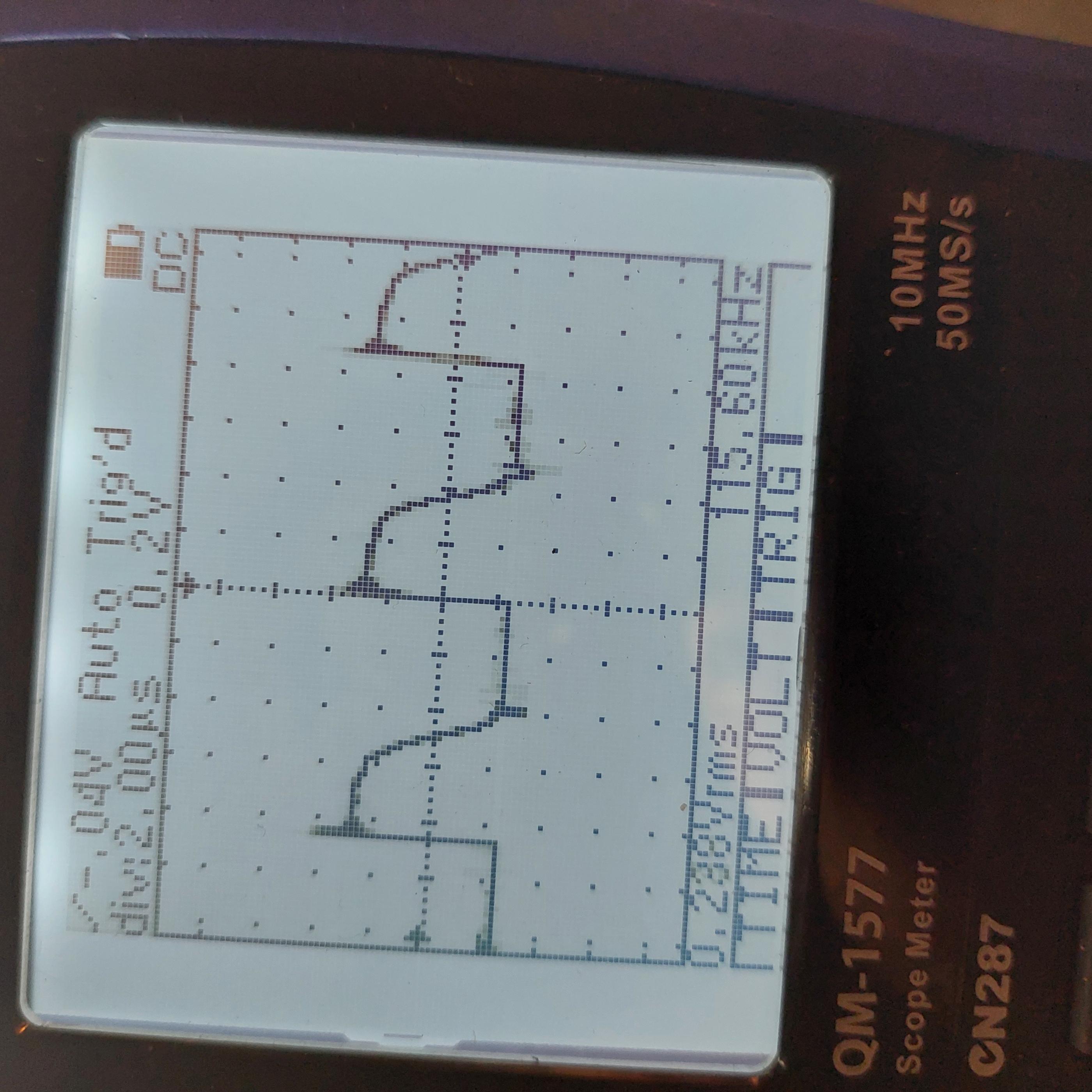

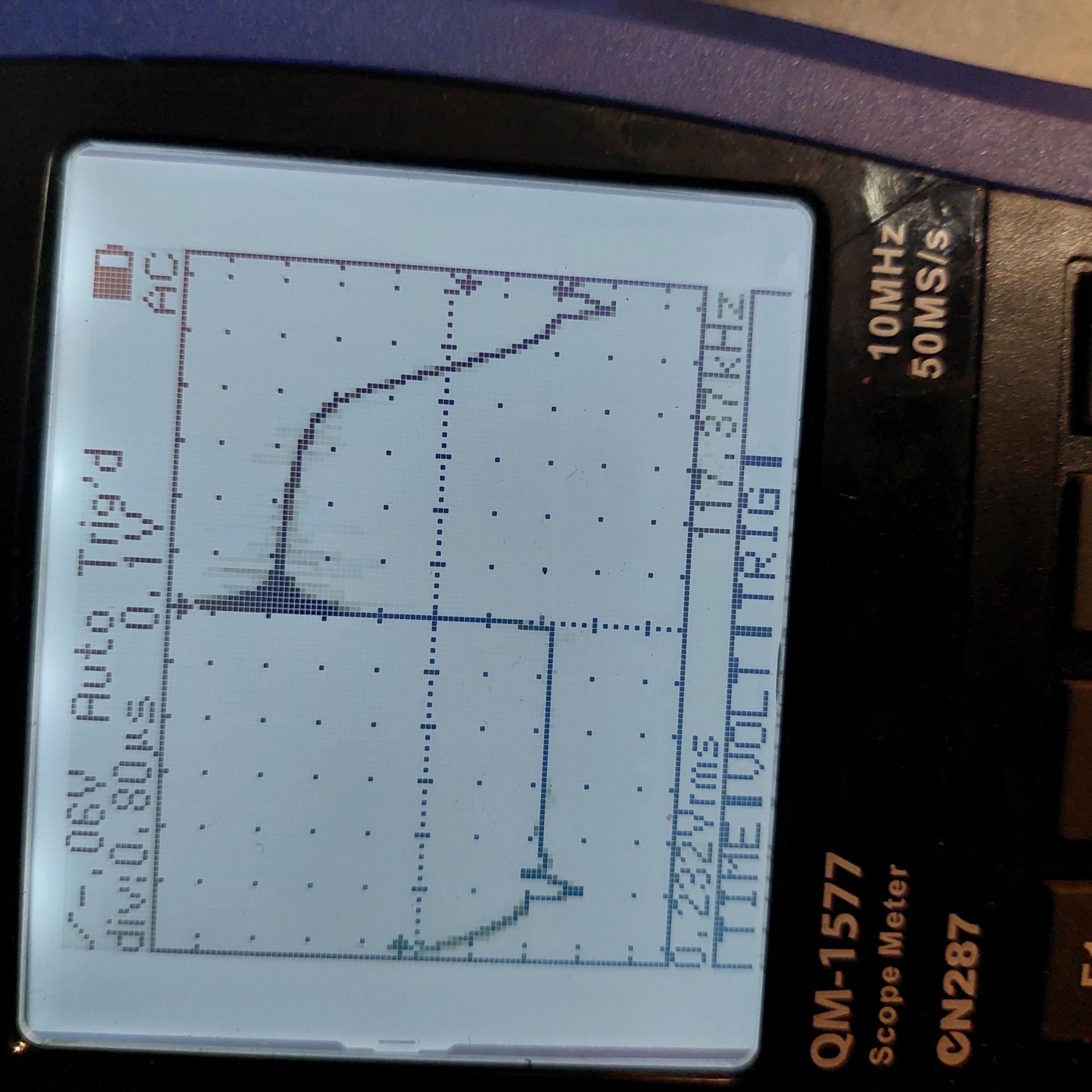

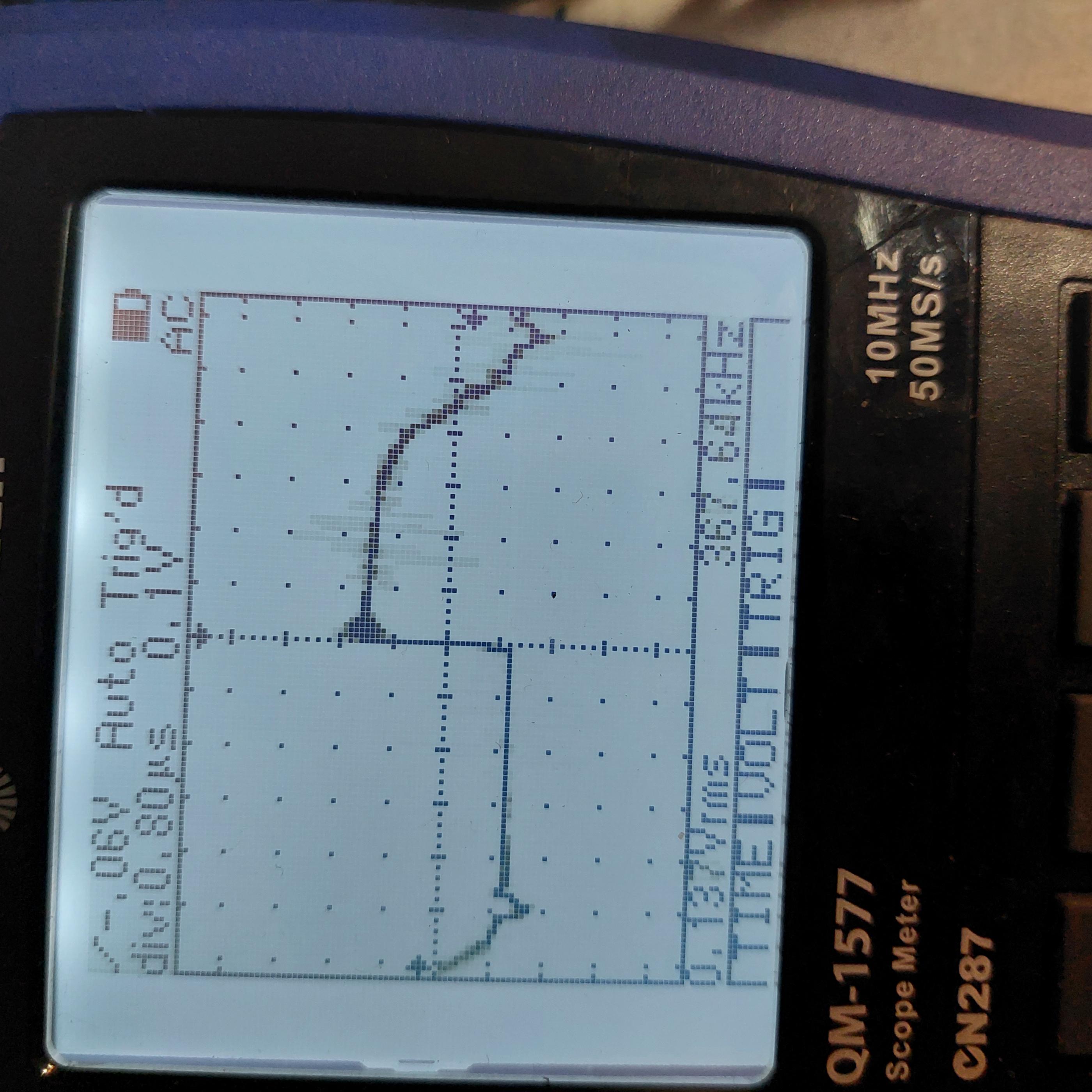

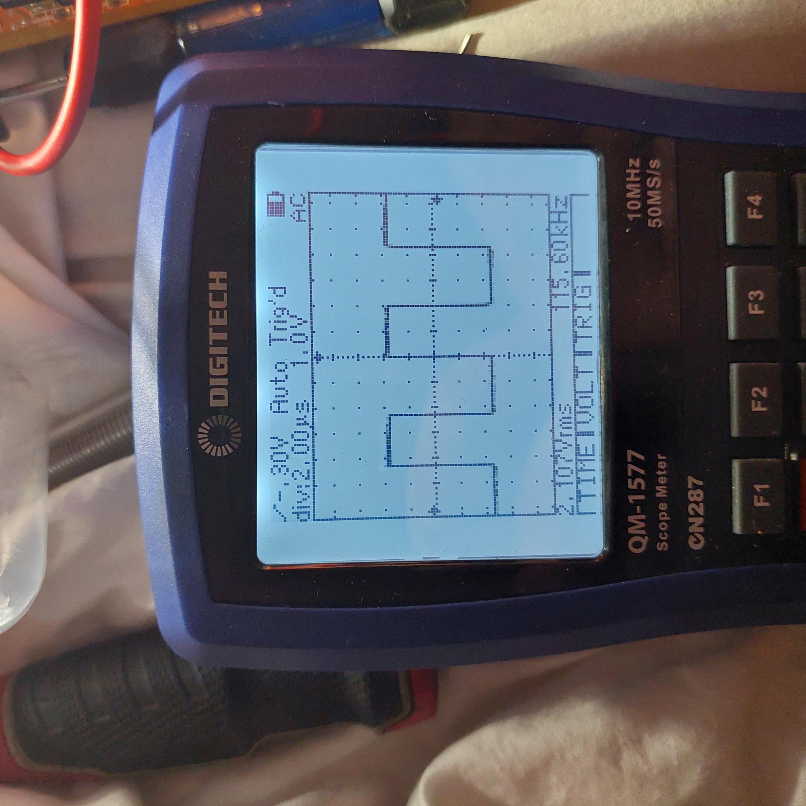

If the mosefts still get hot after this what else should U check. I've checked most the resistors around the output area. Diodes. Capacitors. Replaced gate resistors.

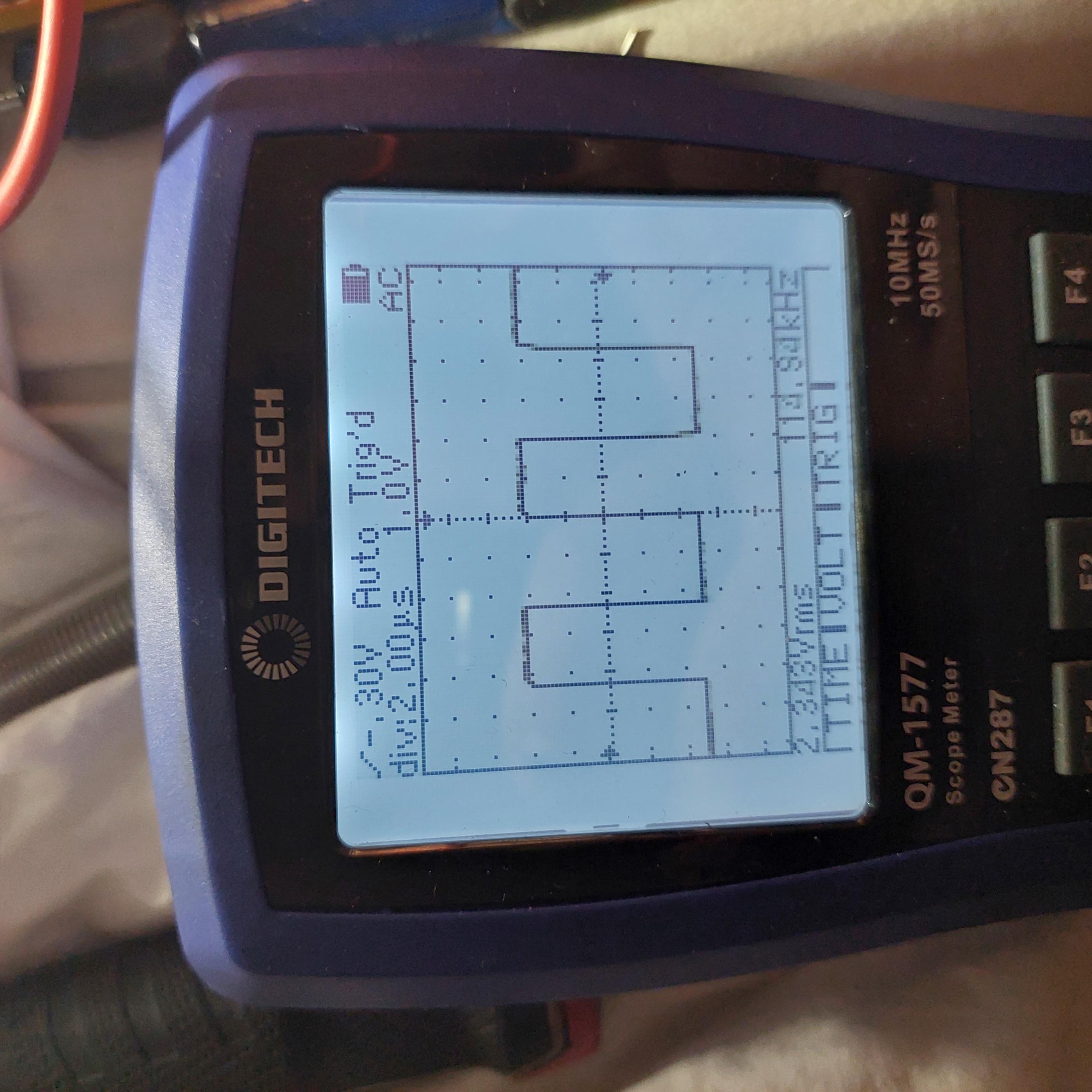

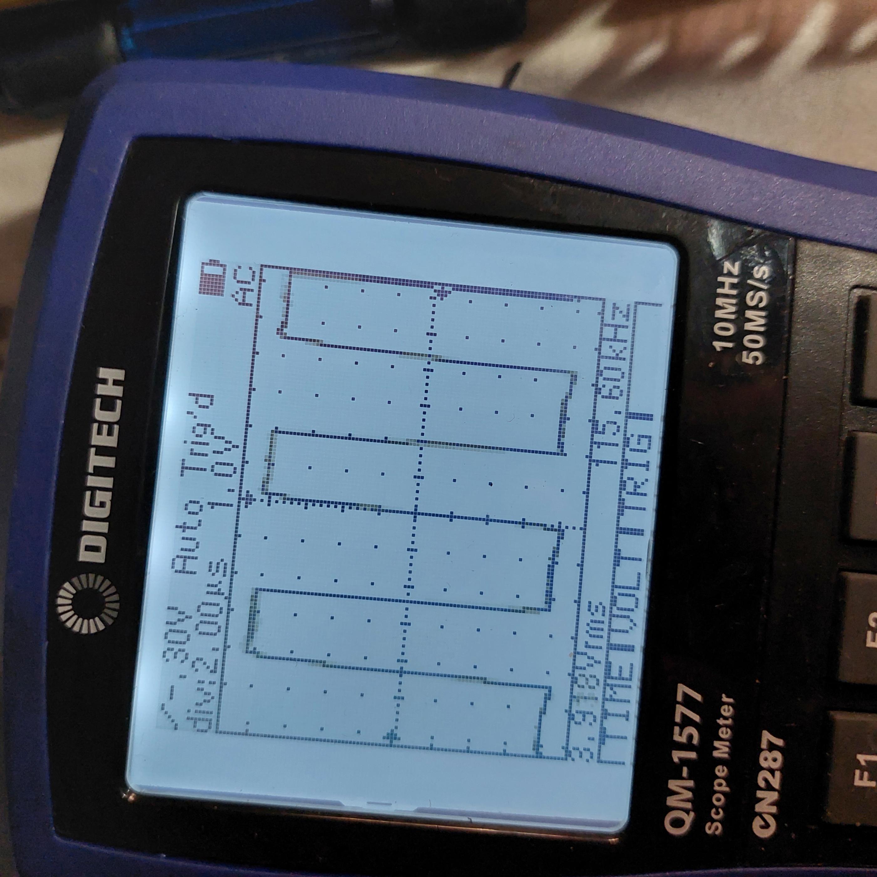

Drive board checks out fine and has a nice square wave comming out the 2 pins on the left side if U have the pots and RCA block facing U.
I'll do that now. But in regards to these amps. I assume from the wave I'm seeing one side of the board is high and one side is low correct?

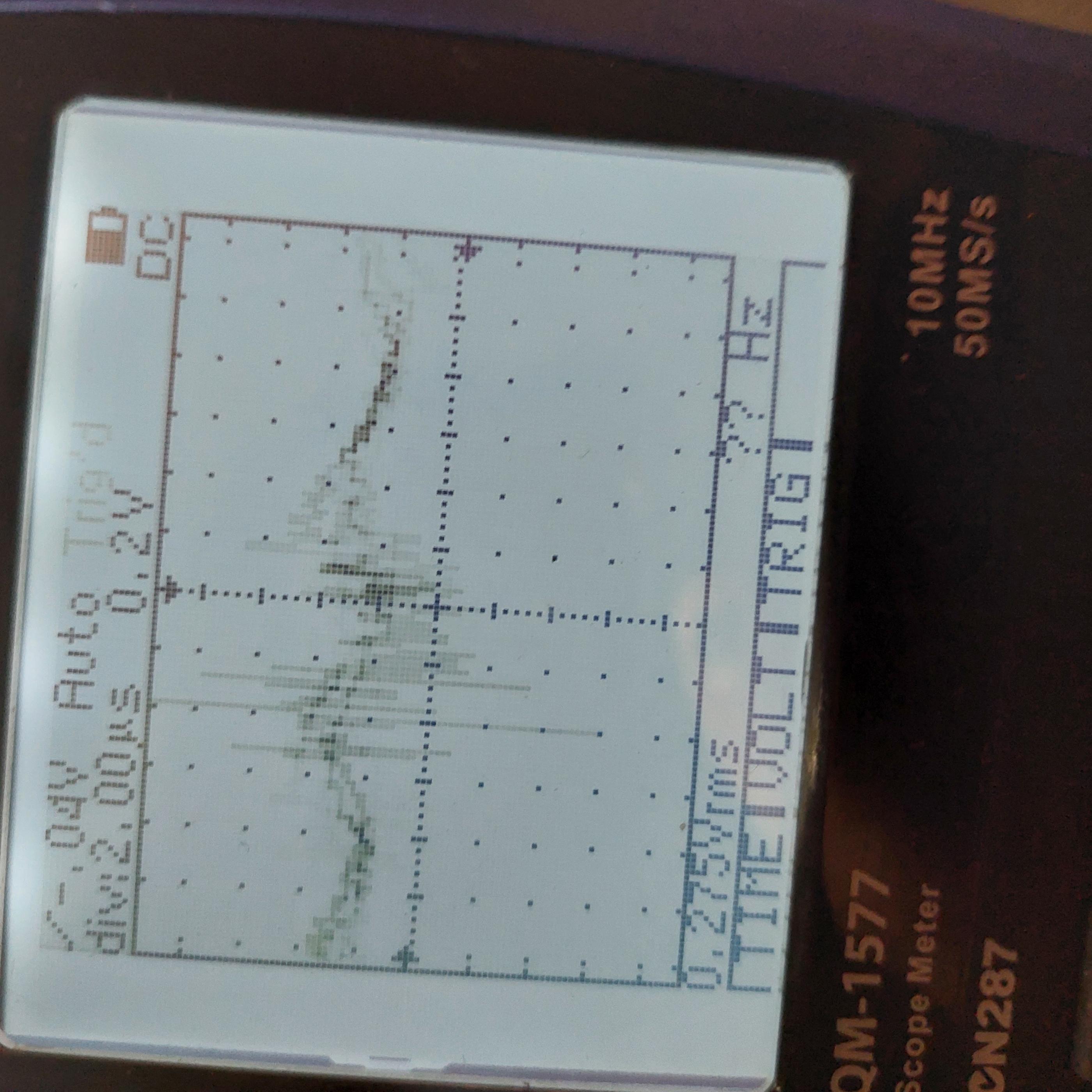

Removed 87 and still in protect however 3 seconds after power up it drops my power supply to 11v which means epic current is being drawn. Similar to when I had a blown output fet. (No outputs are currently shorted
