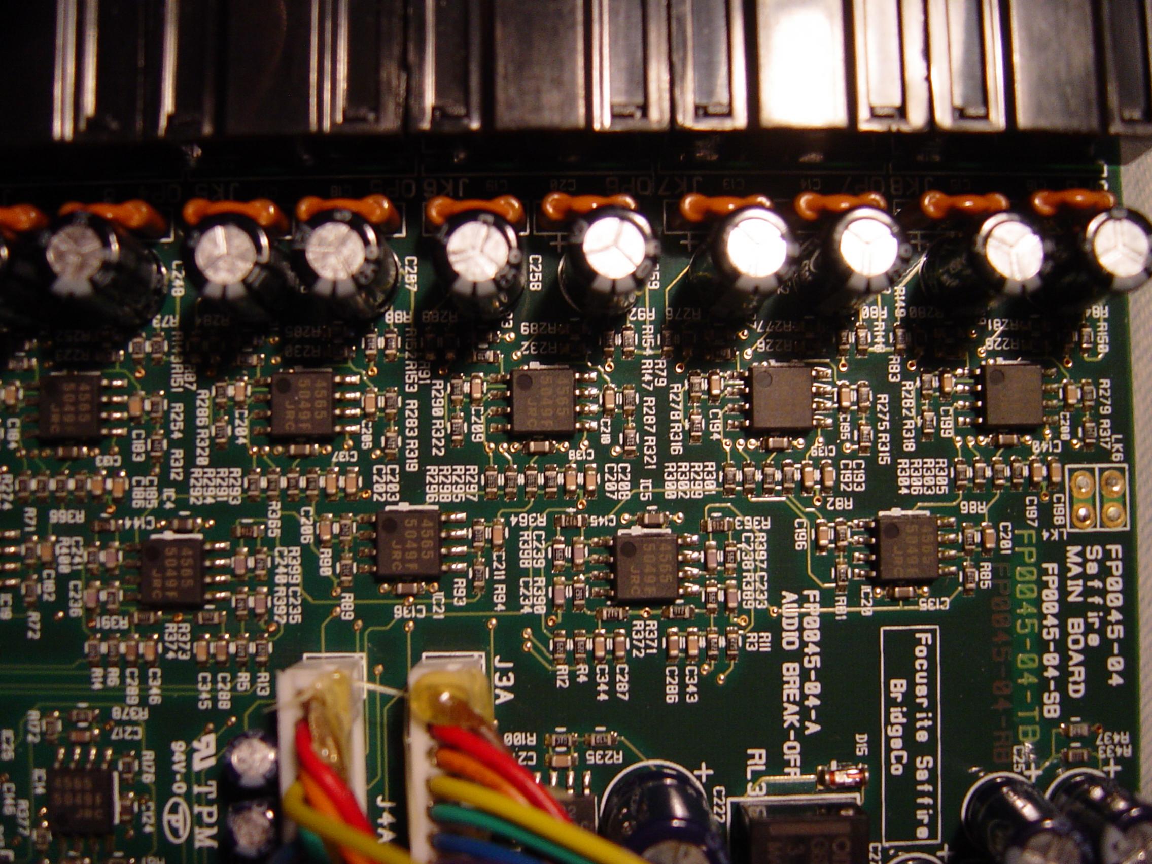

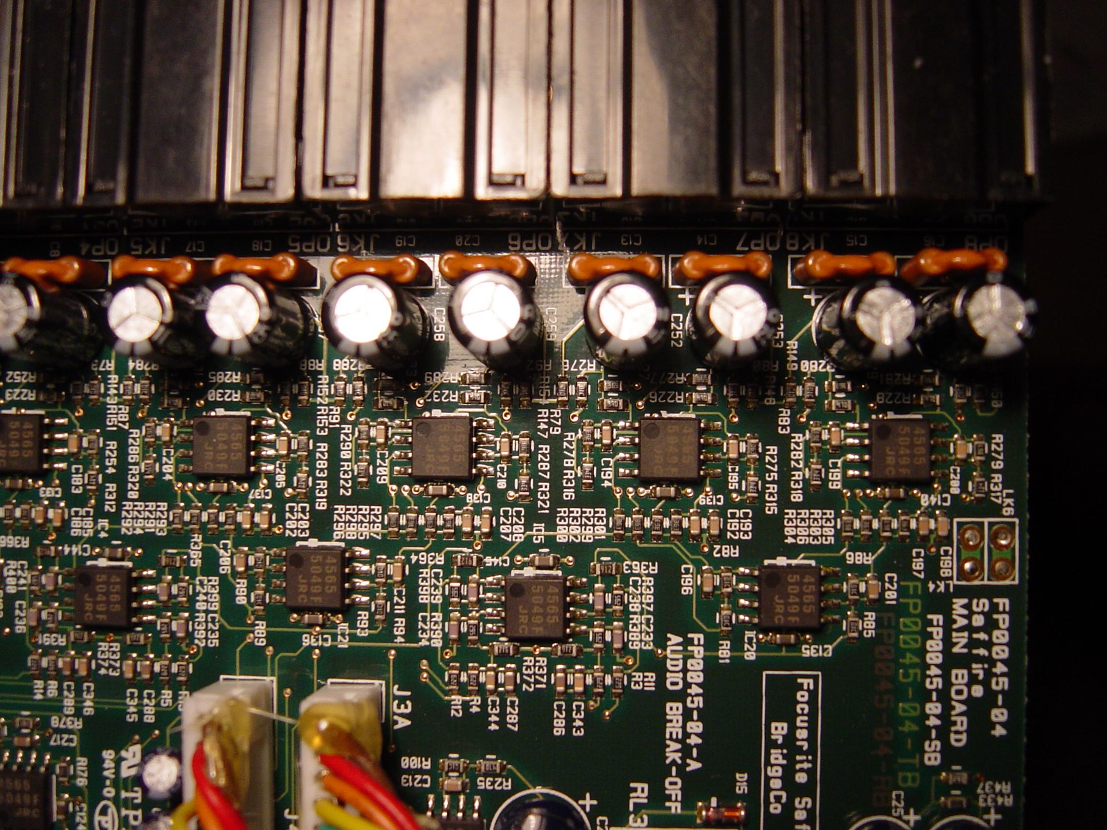

Alright here are pictures of the output stage, perhaps they can say more than I can.
Perhaps you can also explain what the second row of dual channel opamps are doing. I thought only one would be necessary.

I'm presently listening to it with manually jumping to the posts (so it doesn't bridge the ring and sleeve) will full digital volume and it sounds pretty good, less distortion in the mids and the dynamics seem a lot stronger than before. Would still love to know exactly whats happening though, and certainly why they would design it this way :/
OK, it seems you have already got to the bottom of the issue as regards how the volume control is implemented. Thinking in terms of 16-bit signed data for example (16-bit .WAVs are signed) the maximum excursions are -32768 and 32767. 0.5dB (the gain/attn step offered by the DAC) is a factor of 1.0592537251772888788092803732781. 32768 reduced by 0.5dB is 30935 (rounded). To reduce the output by 0.5dB the input sample would be multiplied by 30935 and divided by 32768. The division is trivial as it simply consists of discarding the rightmost 15 bits. Greater reductions in volume simply require a smaller multiplier.
Since the wheel-operated volume control can be overridden in software, it is obviously being read (it could be an encoder or a pot being read by an A/D) and the control effected by commanding the DAC. Personally, I would never design a DAC that worked like that precisely because of the degradation of S/N and quantization noise, which means that a user requiring the best performance from the DAC should never use the volume control, or rather should always have the volume set to max. It's not uncommon though in 'consumer' applications to disregard considerations of absolute quality in favour of 'convenience'.

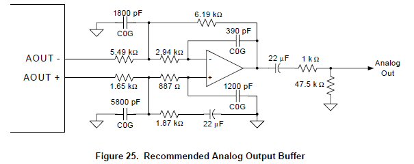

As regards the output opamps the datasheet recommends an output filter using at least one opamp. This filter has a single-ended output. To convert this to balanced a couple more opamps would typically be employed:
This means we have 3 opamps per channel. The designers probably used the remaining one for a final adjustment of gain preceeding the balanced line driver.

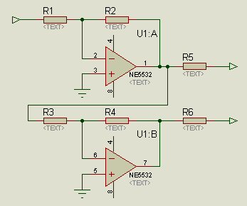

So they take the differential output from the dac, convert it to single ended with one half of one of those dual channel opamps, and then convert it back to differential with another opamp? Isn't that a sort of stupid way to do it? :scratch:
Stupid? I don't necessarily want to comment on that, but here's the diagram from the datasheet:
