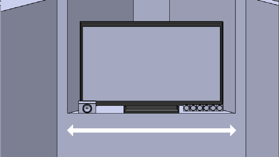

Also, perceval, the width under the tv is 64in at the very widest point in the triangle. The TV itself is 54.5in wide.

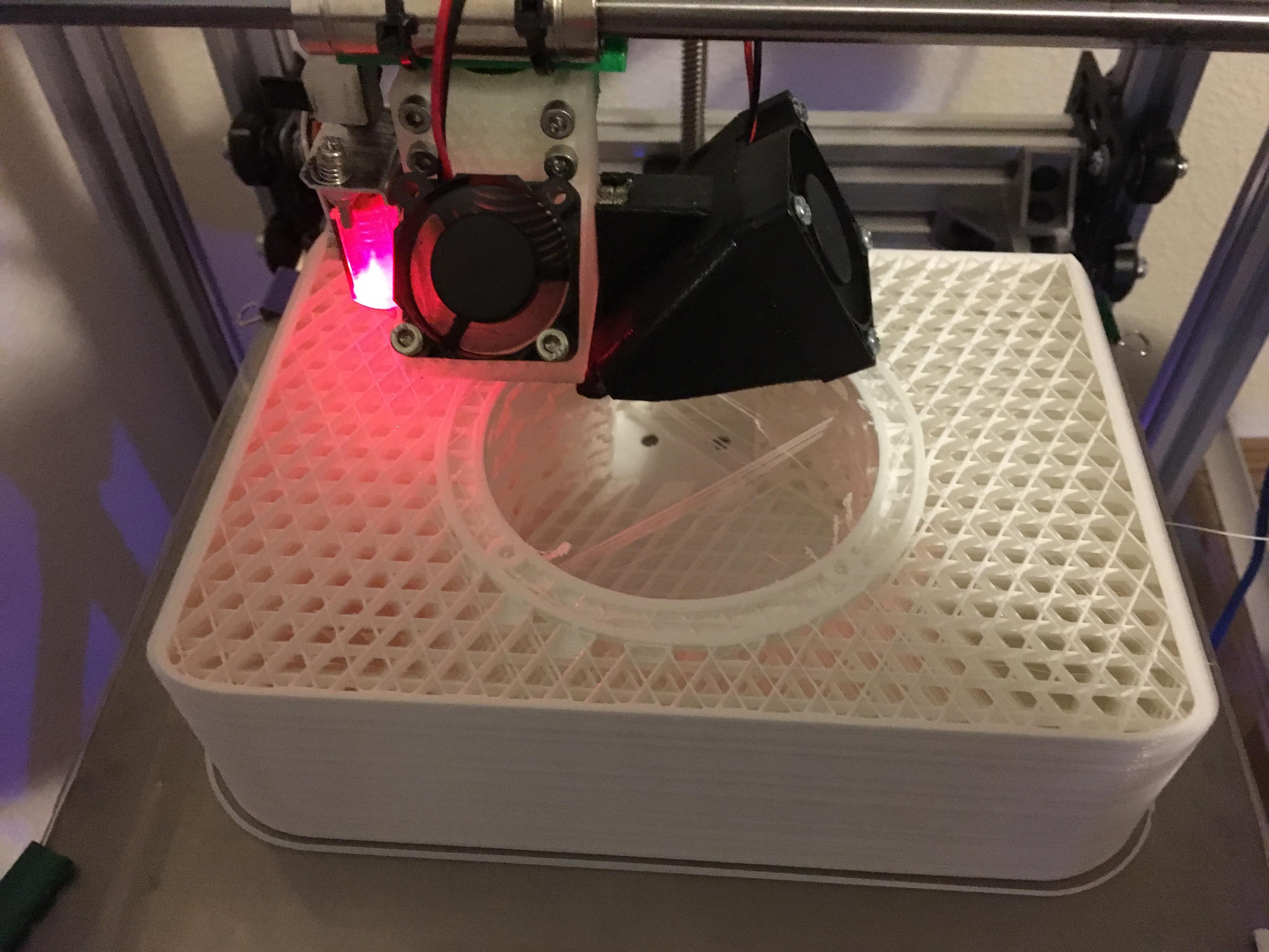

Now to begin the process of making a final design for the enclosures. I'm experimenting with a new approach for printing the enclosures that my negate the need for the polyfill, and give me great stiffness for the sub enclosure. I will add some screen grabs once my experiments are ready!

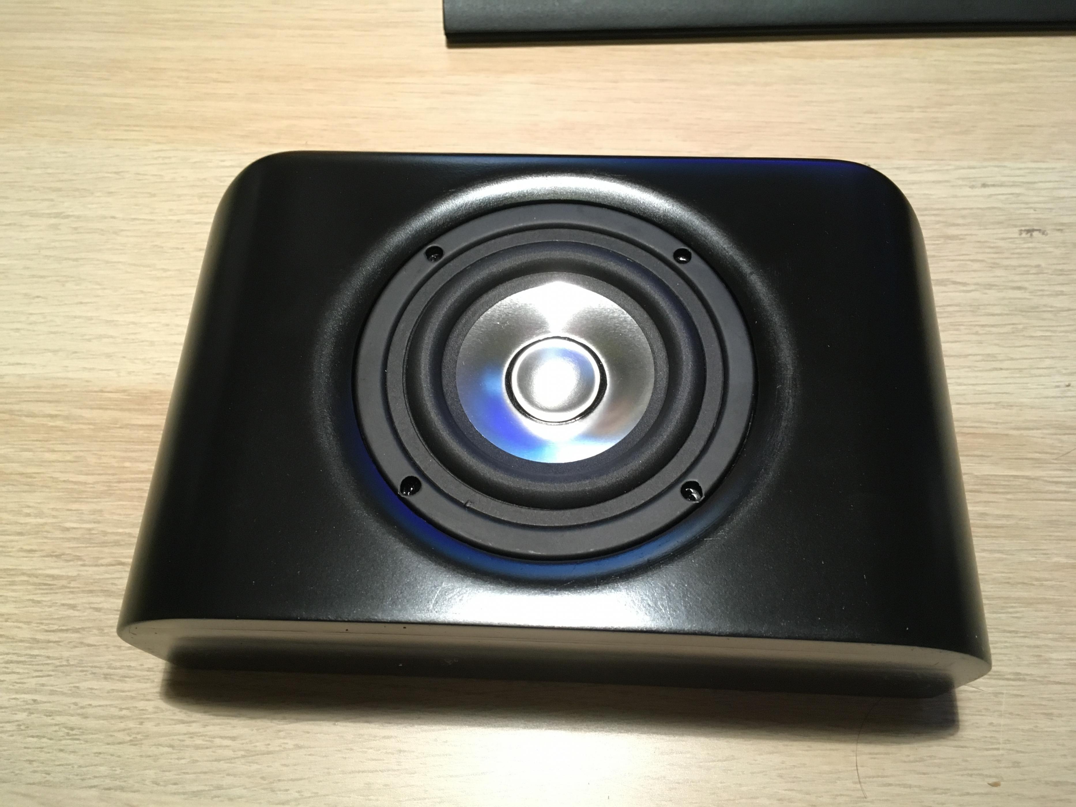

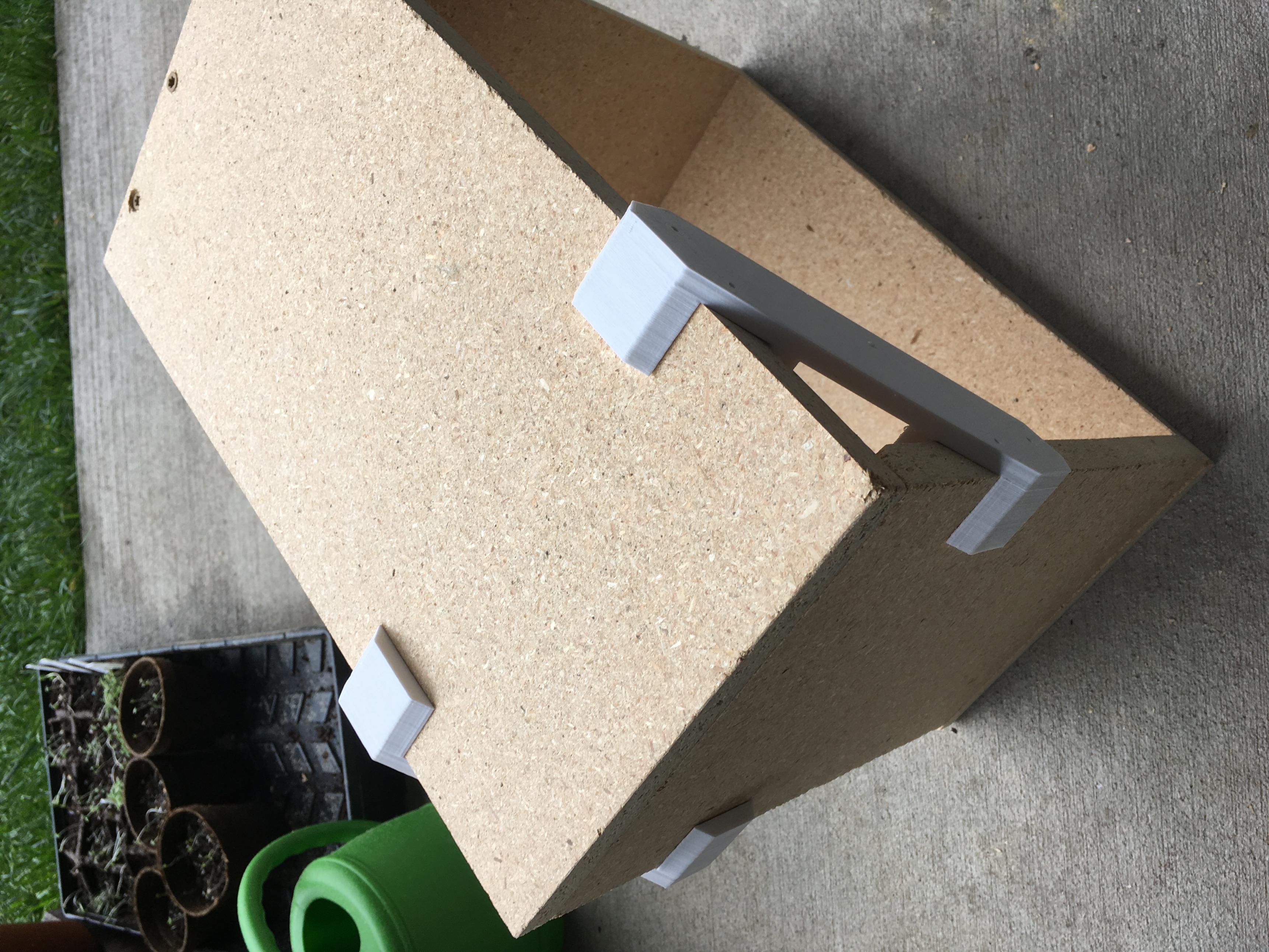

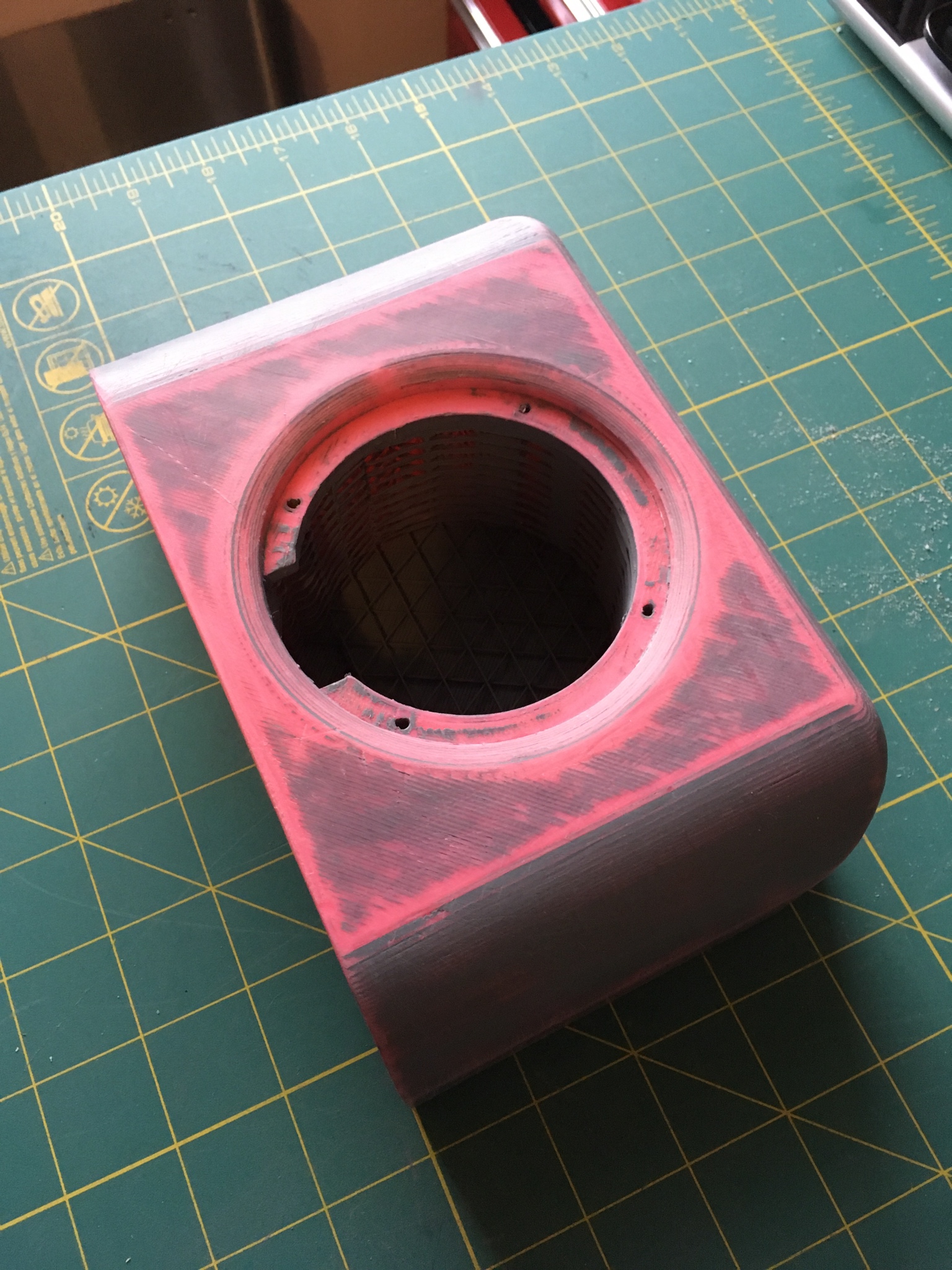

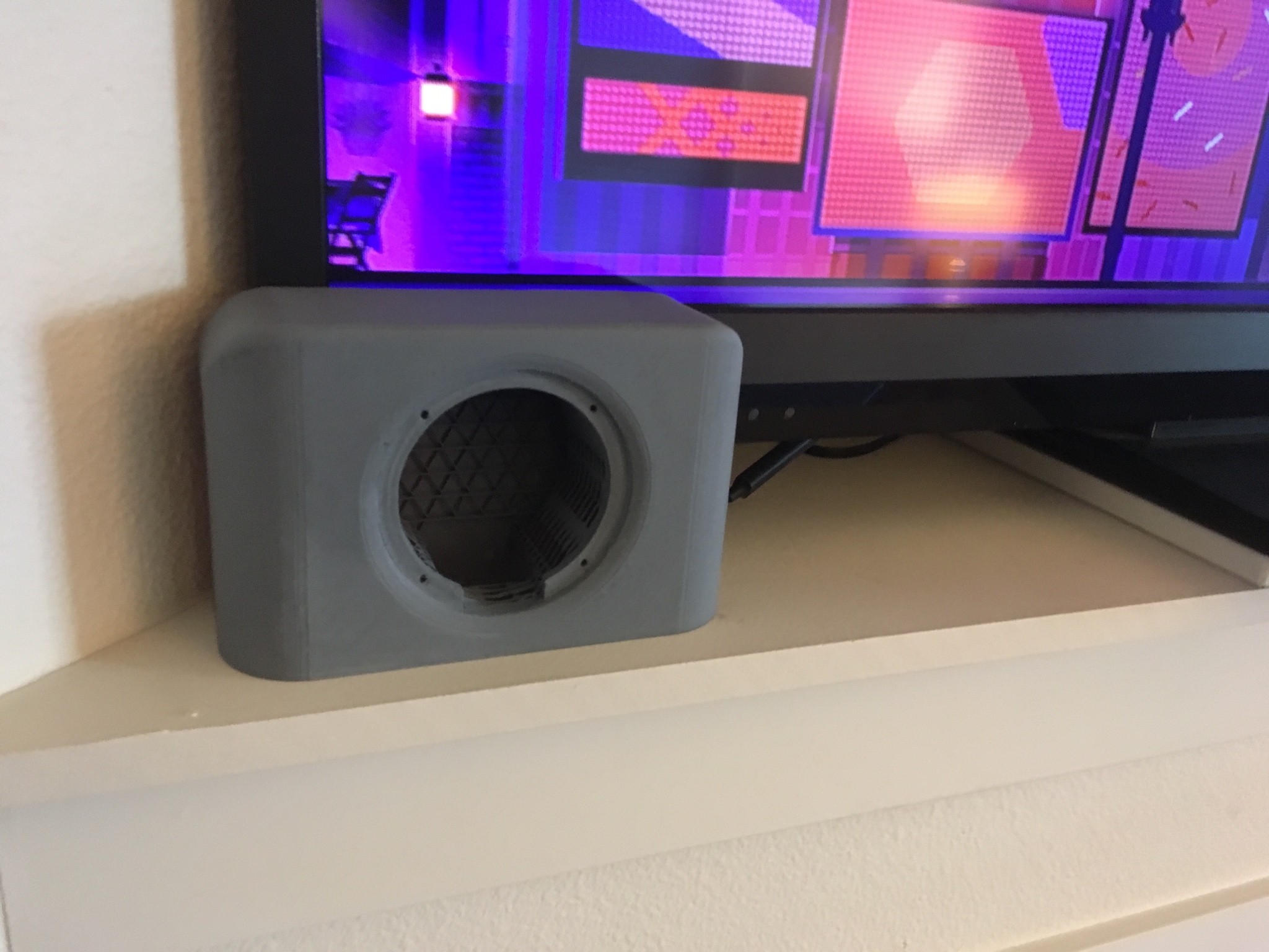

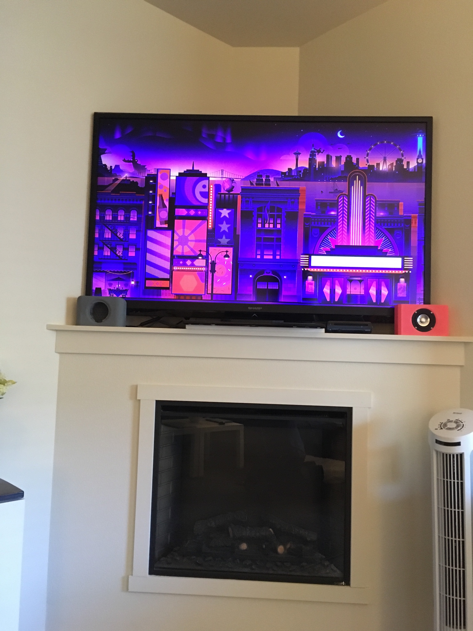

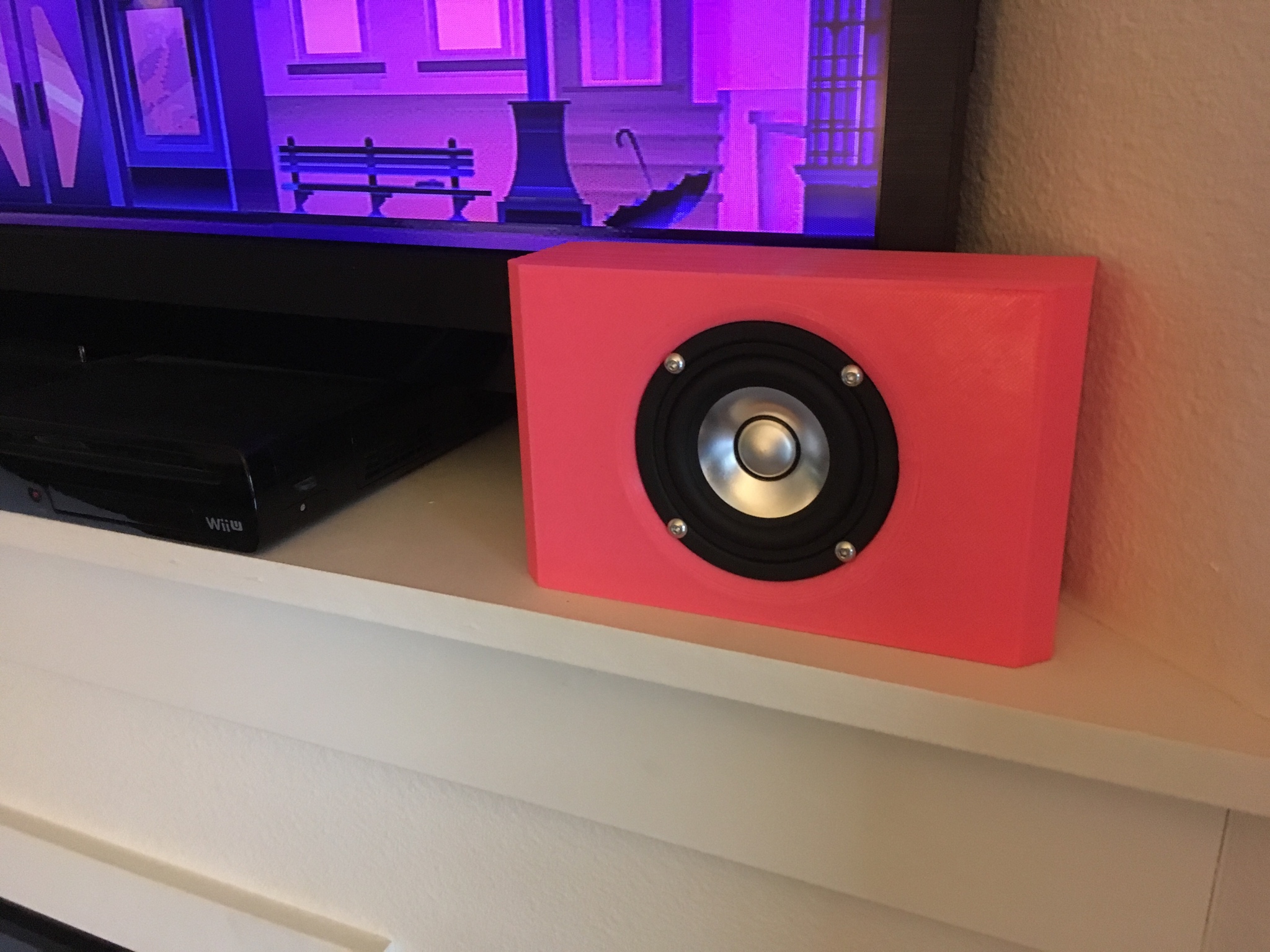

So I finally have an update. I was able to print up some designs for the satellites as a fit test.
They are both the same volume, but one is rounded on the front and top corners. Unfortunately my wife is more a fan of the chamfered design.

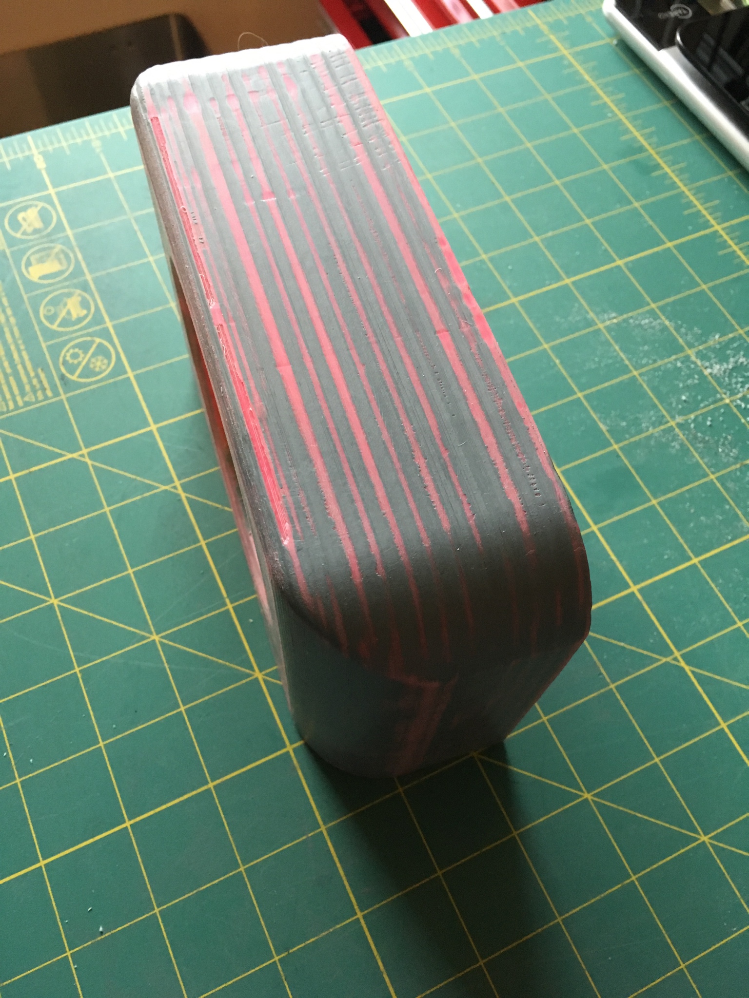

I'm still having issues with my print quality, and there is heavy z-ribbing that I'm working on fixing.
All of that lovely space behind the television going back into the corner. Maybe fit the subwoofer in there in a Toblerone enclosure?
I've been toying with several different sub designs and locations. I will be printing the sub, so the shape is flexible, and hidden would definitely improve the WAF. My only concern with placing it behind the TV is the potential impact on the sound. Its seems like only reflected sound would actually reach the couch, and idk if the shape of that empty space would cause any weird reverb.
Given the ease of making the enclosure, I could just run some tests in a rough box to see how the sub placement changes the sound.

Why not just forget about the fiddling with the minor stuff, and just use something like plastic padding filler?
https://www.ebay.co.uk/b/plastic-padding-filler/bn_7024958736
Then sand lightly, prime, and coat. Still much easier than woodwork.
I did not realize they had thicker fillers. That would've helped me finish up the speakers quicker! I'm gonna have to try and find a local place that carries some of that.

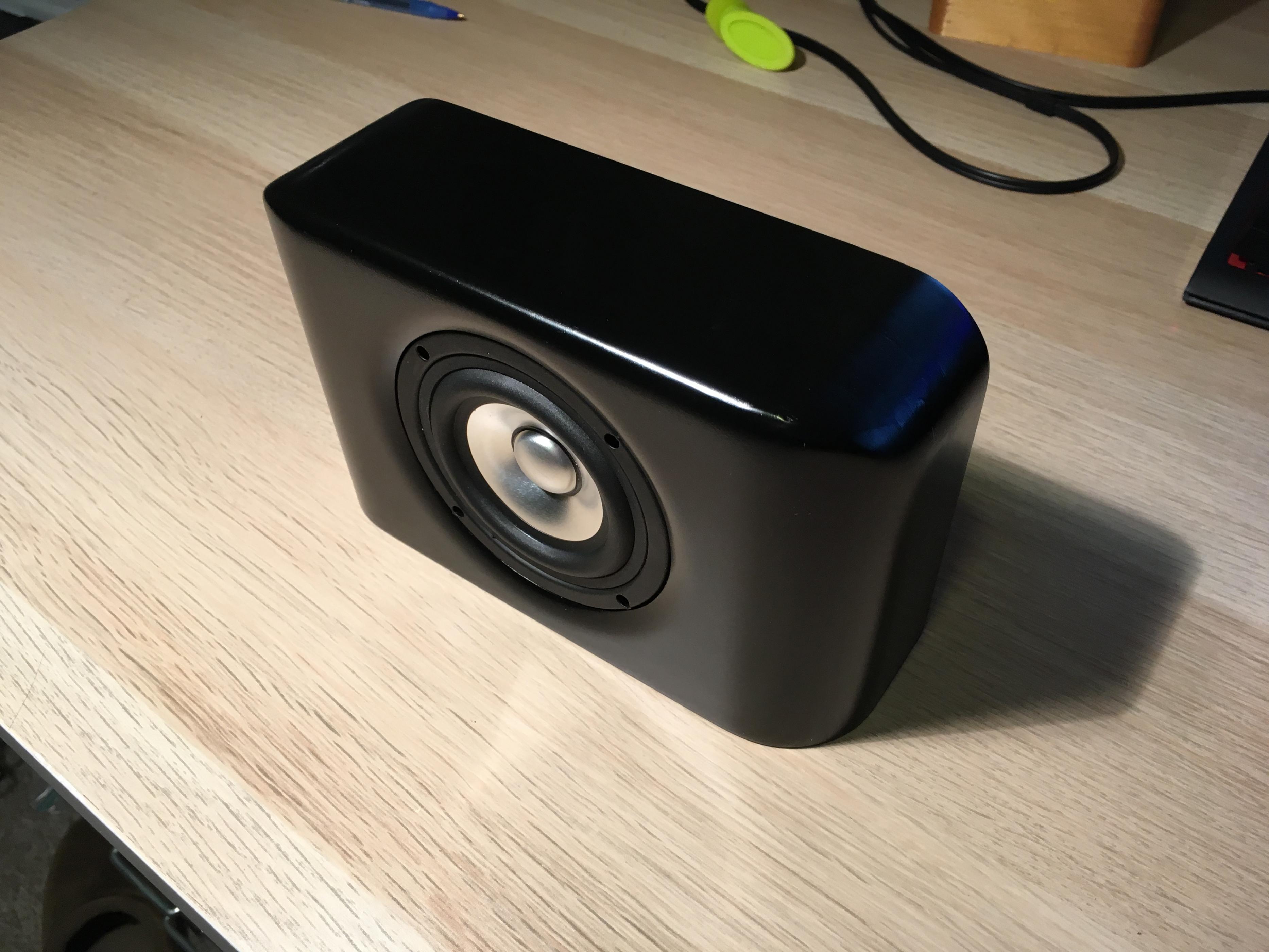

On a positive note, I think I finally fixed my issue with the ribbing. I did another speaker housing overnight last night, and the only texture on any of the sides is from the actual print layers! I've got a few gaps that need filling, but I'm confident that my spray on body filler can handle those.
At this rate (with all the other **** going on right now), I'll probably have the satellites done in a couple weeks, and the sub another month or so after that!

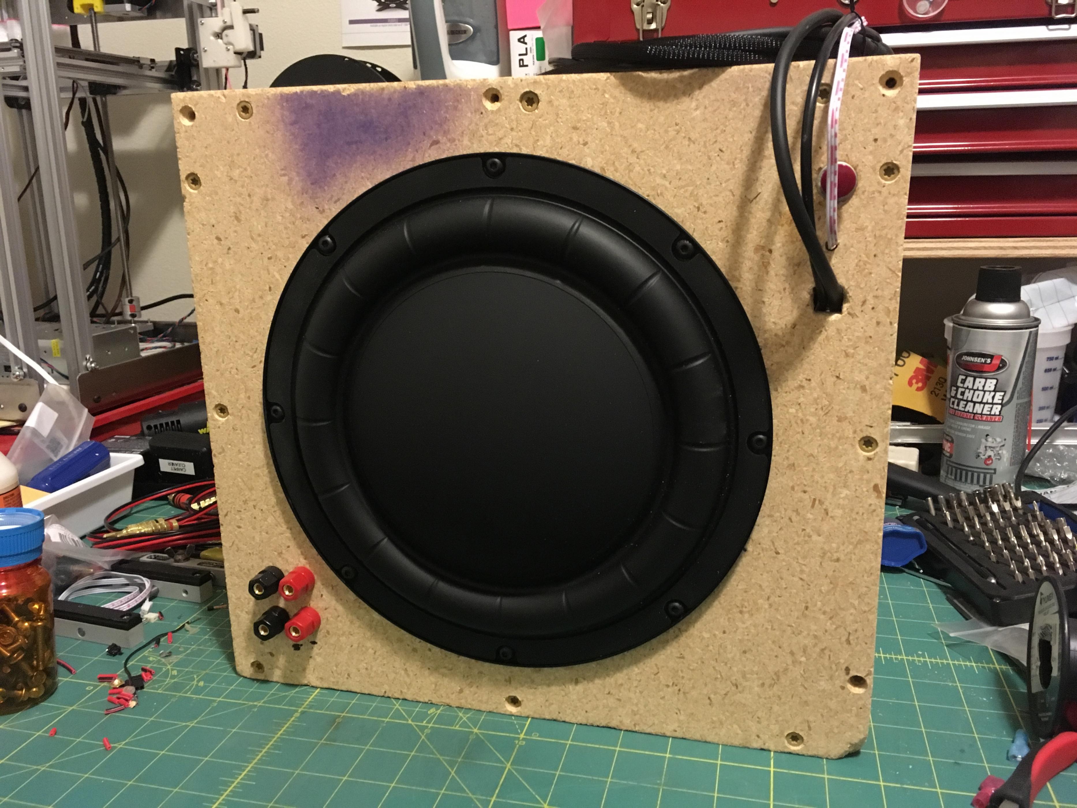

So I have a big update here! I got all the speakers printed, painted and assembled! The electronics are all mounted in the sub, and I'm currently working on REW tuning. That part's going a bit poorly because the phase alignment of the satellites is really wonky. I'm not sure if it's the mic or the speakers themselves though. I'll have some actual measurement screenshots next week

Lookin' sharp!

I just got home from a trip last night, and I'll have some sweeps up this weekend hopefully! I did have time to connect everything last night and watch some tv. Even at very low volumes the sound is quite good, with things turned up to movie watching volumes it should be very room filling!

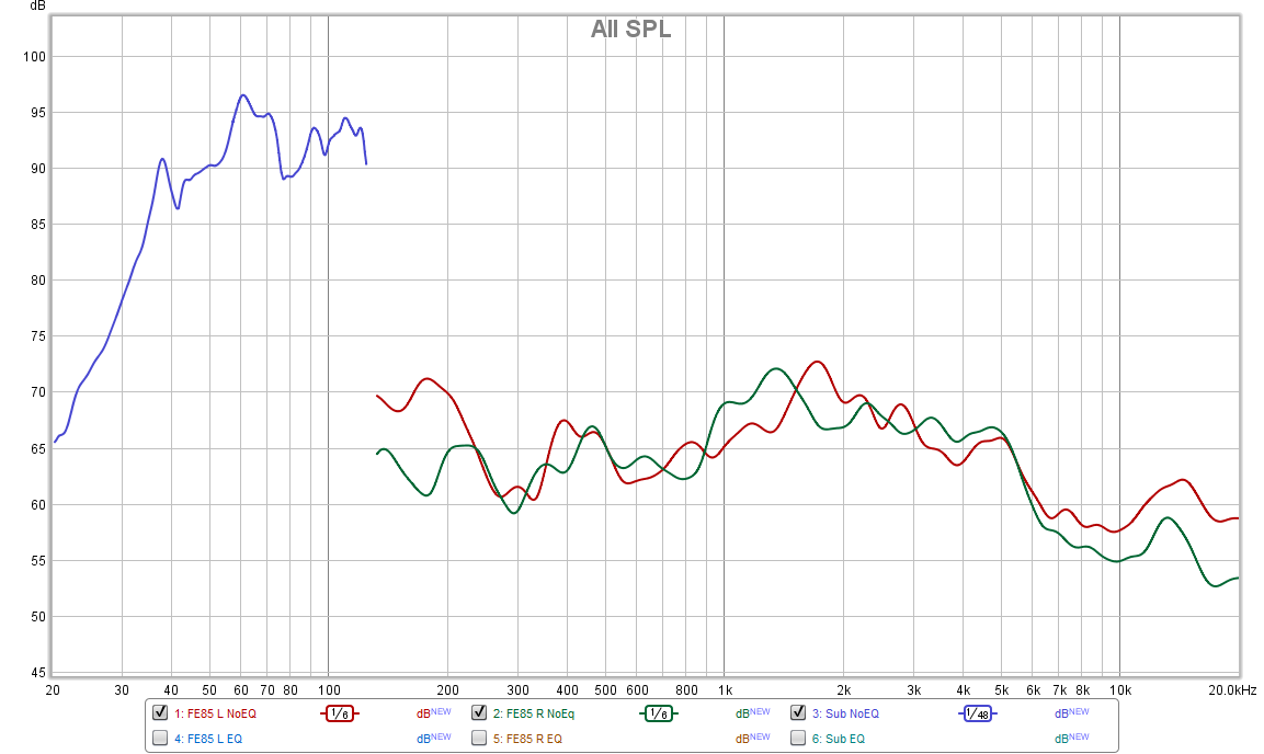

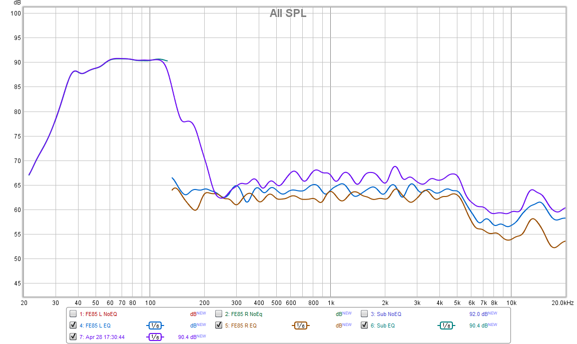

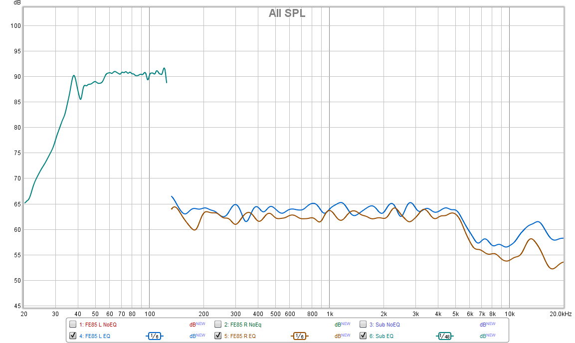

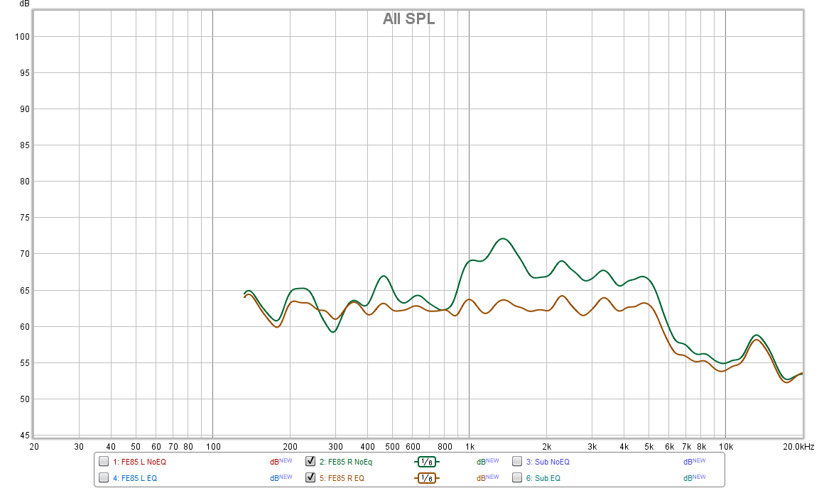

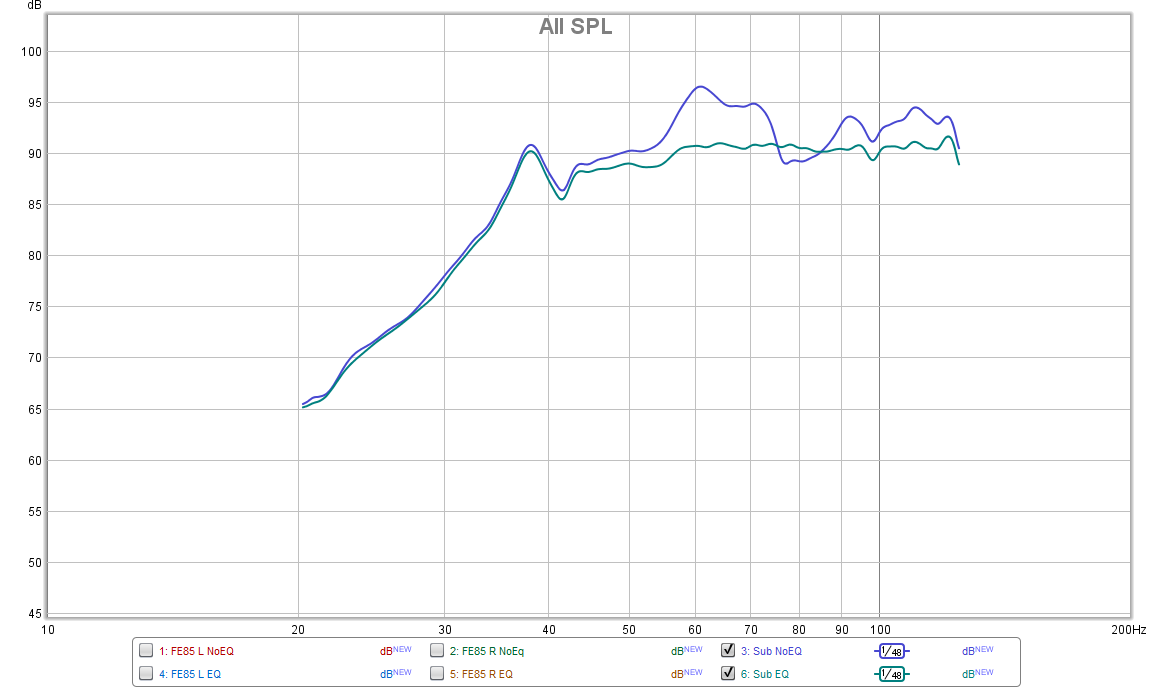

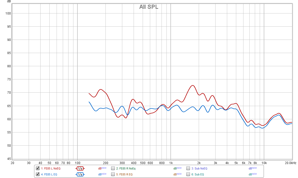

Results!! I finally had some time to properly arrange my hardware, I got a clean dc-dc converter to power the MiniDSP, and I was able to take a bunch of measurements.
Here are some screenshots from REW. I've got the full system with and without EQ. Each driver with and without EQ, and then the full range response. The EQ filters for the sub were done using 1/48 smoothing, while the satellites used 1/6.
Due to impedance mismatch, I'm planning to put around -20 dB gain on the sub to better match the volume of the FE85 satellites. This will be done mostly by my wife's ear while we are watching movies. I've set the crossover point at 125 hz since the sub really drops off above that.
Also, what is the best way to share my actual measurement data?
