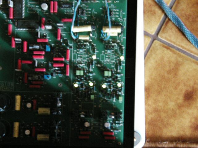

Magnavox used to put a green Led shining on the CD in thier CD players! The reason displays can effect the sound is that they are driven by a micro which generates all kinds of RF noise. Most do not use leds by the way. There was the audio equivalent of an Urban Legend floating around in a British audio magazine about the LED pilot light screwing up the sound. Me and Jocko love to use them as voltage references since they are quiet when baised correctly. Most zeners generate a LOT of voltage noise. Whoops there I go reading ap notes and data sheets again. I also use tiny light bulbs as feedback elements in low distotion oscillators.
