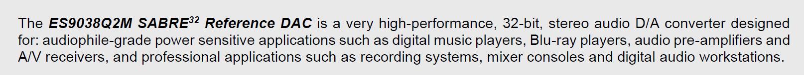

Manufacturers seem to describe the bit-depth of a data converter by its internal processing word size, not its analog DNR.
People love to debate, aren't they? 😀
Digital data can be represented by 2 symbols which is 1 and 0. So 3-bit can store 2^3=8 possible values (000, 001, 010, 100, 011, 110, 101, 111).
The more the bits, the more the values that can be stored, the higher the range of the values. If these values are (to store) the converted analog signal amplitudes, the more the bit the higher the possible SNR.
So, if a DAC chip is capable of handling 32-bit data (input). Does the manufacturer have the right to name the chip 32-bit DAC? Why not!?
Since High School, all students are required to show unit of measurements in their calculations for a reason. A 140dB analog SNR has no meaning without knowing the frequency bandwidth and input amplitude.

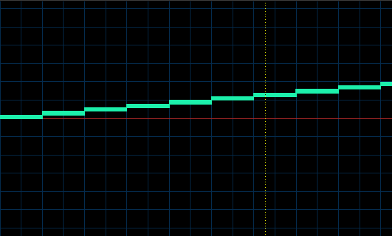

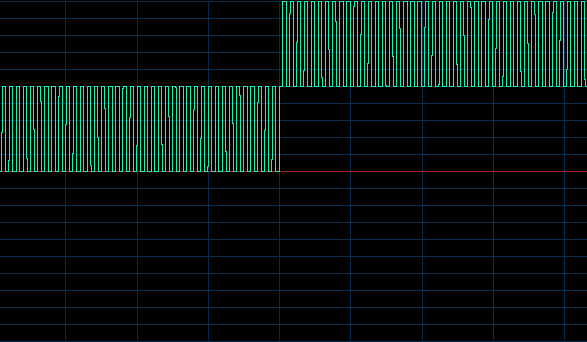

Here's a nice test signal: what is displayed is the 16 bit sample value, and it flips the LSB for a while, then increments by 1. So this signal is 0 1 0 1 ..... 0 1 2 1 2 1 2 1 ...
Zoom out. This is what bit perfect should look like, SPDIF output of a CD player recorded by a soundcard, resolution is too low to see the LSB flip, but the thickness of the line shows it.

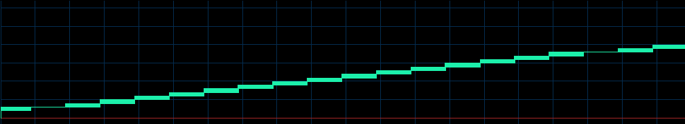

Now, this is what comes out of the SPDIF output of the "legendary" CD723:
It has an undithered volume control, which is buggy: it cannot be set to "multiply by 1" which would be bit perfect. The maximum volume is something like 15/16, which gives a fractional result, which is then simply truncated and not dithered because who cares. So every 16 LSBs, one falls off.

Nice, I know this happens but have never bothered to look at it.
"Who cares" defines many audio industry decisions. You can see it in the designs.

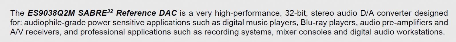

A 32-bit word size can matter in a dac.
To be a tad pedantic, 32 bit processing is what matters, whether inside the chip that also contains the dac, or outside, not that the dac is 32bit... I think that's what you meant. Most off the shelf processor cores are at least 32bit or 32bit capable, so I'd be surprised if the SoC dac devices didn't use 32 bit processing.
Next time you go to a cash machine and type in 100 but only 65 comes out see how you feel about accuracy then.
