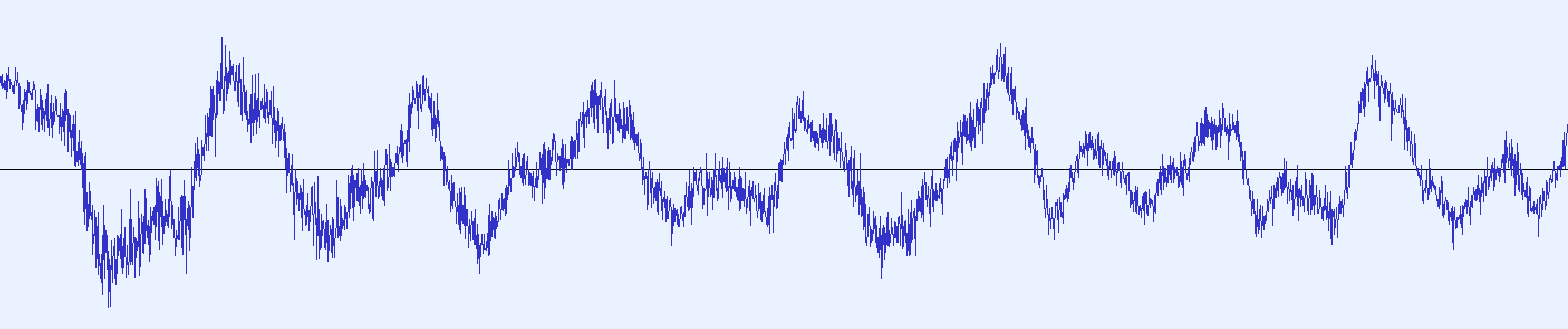

Using music as a test signal is a bit like skipping the wind tunnel and testing an aircraft directly by flying it, then trying to figure out what went wrong by examining the debris after the crash. It's cumbersome.
Music is a collection of sine waves, and it does have a maximum rate of change at zero crossings most often, unless it is a rare inflection point - yes?
I got the idea of the large LF sine + small HF sine by looking at a trace like that. This one is a kick drum + snare drum from Diana Krall. The high frequency content rides on the large signal from the kick drum, and the rate of change depends mostly on the high frequency content, which means it's pretty much the same at zero crossing or anywhere else. On a pure note that looks like a sinewave, then max rate of change is near zero. On more complicated music, I don't see why it would be the case.
More specialized tests always reveal some characteristics of an amplifier, but a frequency response test of an amplifier will also reveal ringing. It has to and does.
Yeah but then you have to do a network analyzer sweep for various output voltages and currents, check if the output transistors' increased transconductance with current compromise stability, check close to clipping, etc, whereas the sine+square test is a lot more convenient...
