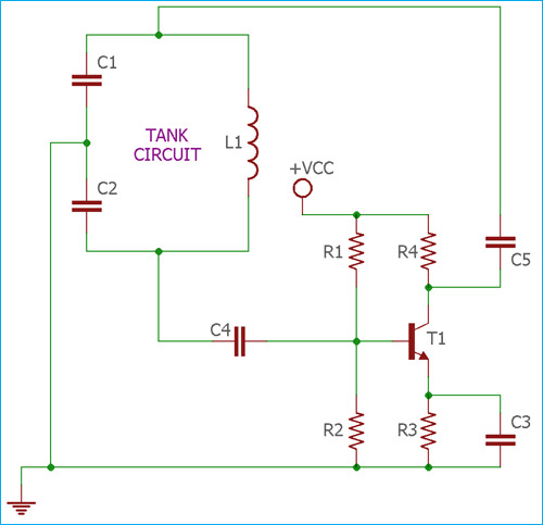

I don't have a definition for the emitter or cathode resistor, but since there is not a loop from the output to the input I would not consider it as a feedback.
This too is an eternal question with different replies.
krivium,
you are wrong. Disregard the power supply. An emitter resistor reduces the transition velocity, thus the amplification factor, increasingly with frequency. Any resistor in any position does that without necessarily creating a feedback loop.
Technically speaking, an emitter resistor is a form of local negative feedback. However, it may not sound the same to some people as less localized forms of feedback, so they may prefer to classify it on that basis. A connection does exist between the output and an input, since an emitter can function as both. This is true even though the connection might be considered an infinitely small loop 🙂
Ever wonder why a tunnel diode can act as an amplifier or oscillator given that it only has two terminals?
andrea_mori,
a feedback loop is not formed between input and output within a stage, but from the output of the subsequent stage. It takes more than one stage to form a feedback loop. Feedback always worsens stability and messes up the phase relationships.
