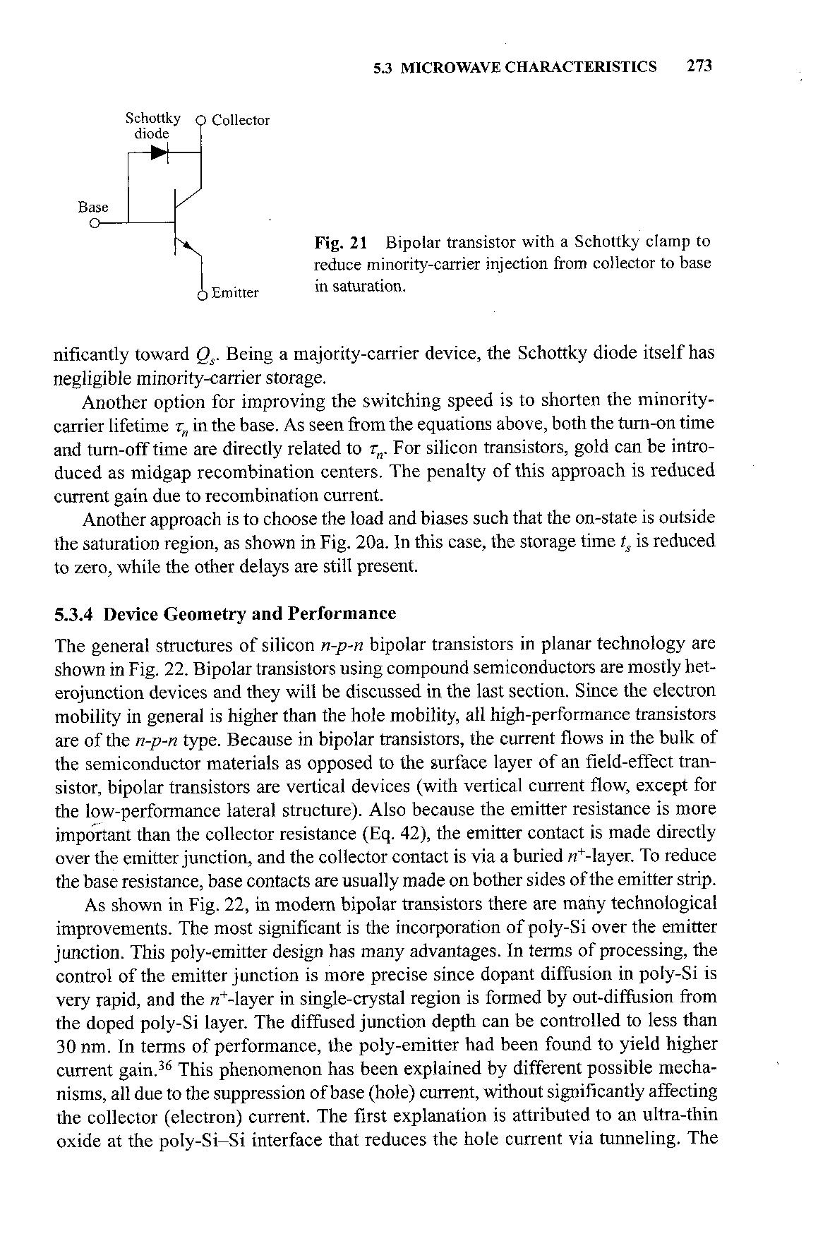

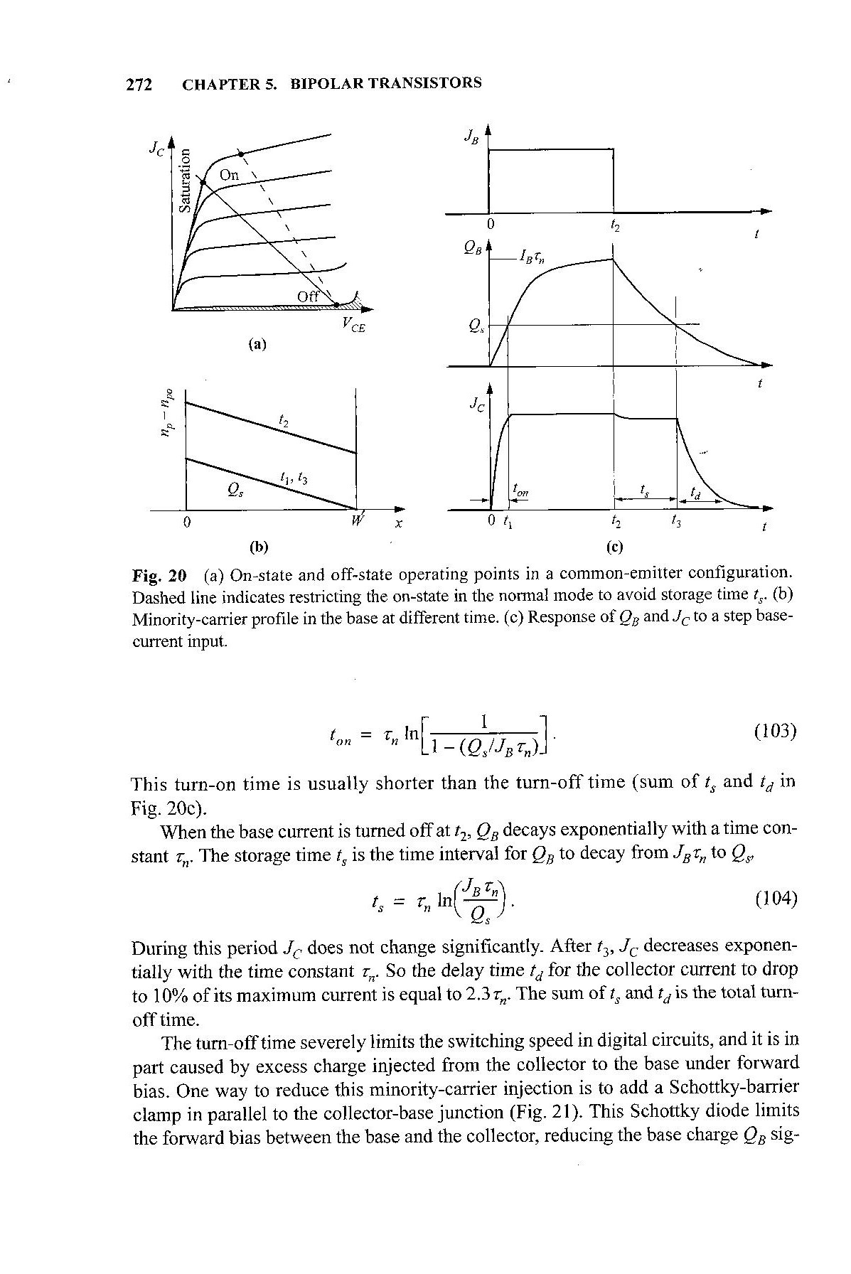

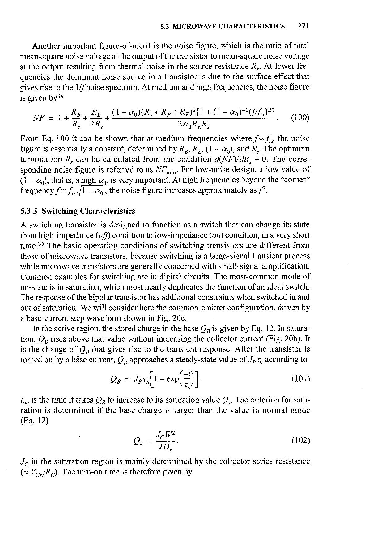

Here you go.Thanks for quoting the source and offering to scan. If you could be so good as to give some figures for a typical audio grade transistor that would do fine.
I have a few old spine damaged references too.
Note that this is all about when a bipolar is driven into saturation, where (for an NPN say) the collector-emitter voltage is significantly lower than the base-emitter voltage. This is NOT the typical situation for a complementary bipolar emitter follower output stage, unless the drivers can pull above and below the main output power rails. Note the prescriptions to avoid storage time altogether.
If it is in the bass region, there is no "fast". See what I mean ?especially if the programme contains a lot of fast bass line attack.
Here you go.
Thanks, it is interesting stuff nonetheless, the 2N6338 datasheet too.
The transient at the start of a bass strike is what it's all about; steady, harmonically spare, 'pure' bass is incredibly boring - it's all the "accompaniments" to the fundamental bass frequency that actually make this part of the spectrum interesting. And a lot of the time the accompaniments are so wrong it's ridiculous - for me, downright irritating, a complete turn-off. As bad as hearing some stupid kid driving down the street with the ground throbbing away - "duff, duff, duff, duff, duff ..."
