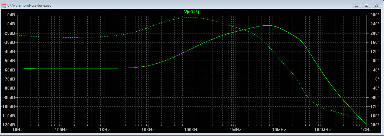

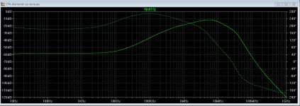

Alas, despite all my personal attempts, I am not able to achieve this with power amplifiers, keeping feedback high enough to get decent damping factors and low distortion.
Even this CFA with > 1000V/µs and a 8MHz bandwidth has a 10KHz open loop bandwidth.
http://www.esperado.fr/vssa-diamond/dvssa.php
The image show the response curve at the input of the VAS in closed loop.
(And, yes, it pass the spladski's test in simulation ;-)
It seems strange, at first sight, to say that modern active devices with FT around 10 or 30 MHz are not fast enough for audio, but it is , alas, reality.
Some can try to reduce the global feedback, using local or nested ones. On my point of view, it don't gives so good results in listening. (Damping factor ?)
