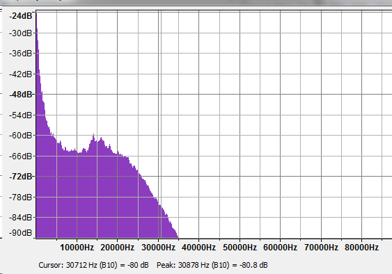

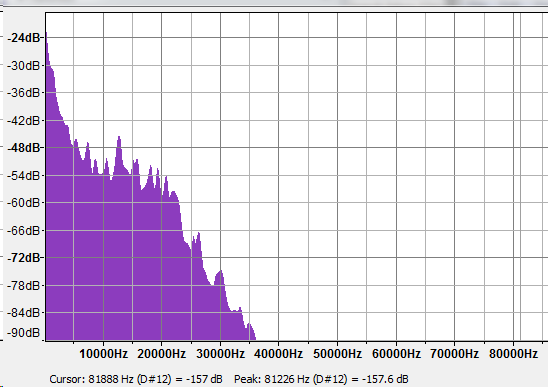

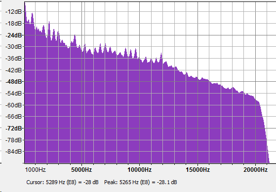

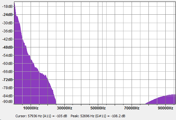

Here are some quick spectrograms of some SD and HD recordings for comparison. The first is from Reference Recordings RR71 HRX Dance of the tumblers a 176.4 recording made with a Pacific Microsonics model 2 and Senheiser + Coles microphones. The second is from RR122 (actually a clip from pre edit and pre master). It was recorded with the same hardware. The third is from a 2L recording of Britten at 192. You can see the noise shaping in the HF boost of the noise floor. Its either an AKM or a TI ADC. The fourth is a clip from some pop that shows really extended HF energy even though its lopped off by the 44.1 sample rate. The HF is mostly synth overtones I think.
As shown there are recordings with real acoustic content above 20 KHz. Their audibility is open to question but for me the easy part is to just be faithful to the original.

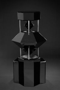

No the tweeter is up top firing down, the midrange and woofer are firing up.
Though IMNSHO for the woofer it probably wouldn't make any difference whichever way it would fire.
But it really looks nice. 😉

Omnidirectional speakers trade some issues of power spectrum for others of near field reflections. For your test I would suggest having the speakers at least 10' (3M) from any wall to get the reflections outside of the Haas window. It actually makes a big difference with any speaker but even more with dipoles or omnidirectional speakers.
His living room is pretty large and the speakers are removed from the walls, maybe not 3m but close.

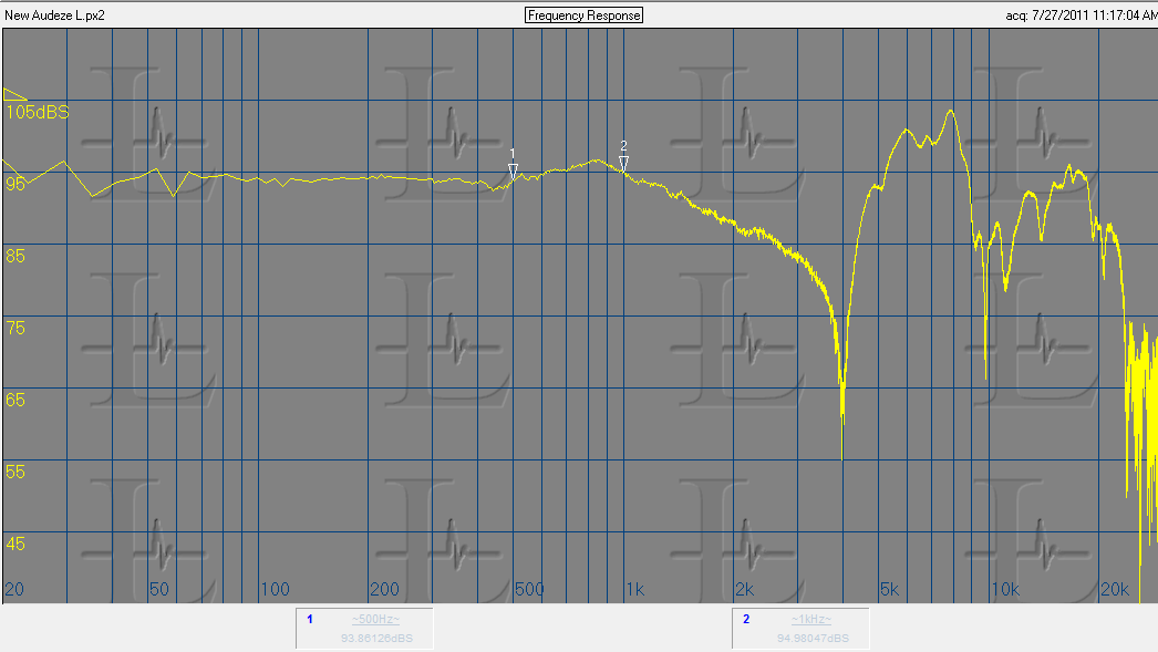

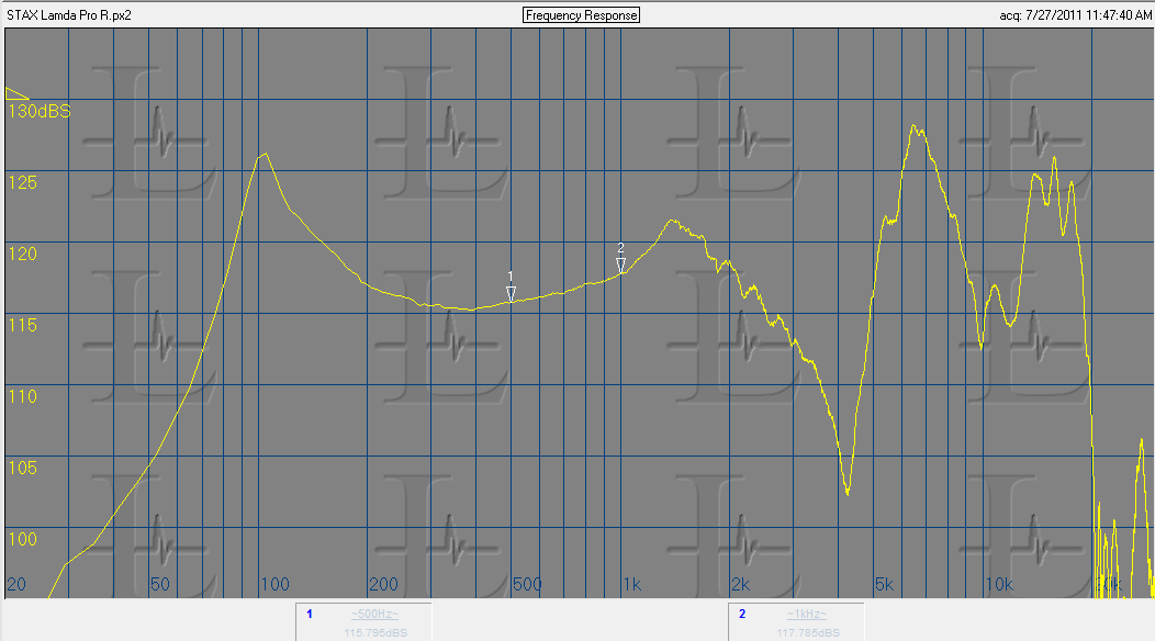

Verifying high frequency response on headphones is far more problematic than speakers. No coupler I know of is accurate or useful above 8 KHz. You can float a microphone in front of the driver to get a sense for its response but its not a verifiable indication of the response in your ear. The cavity has a lot of resonance and other aspects that make meaningful response above 8 KHz just guesswork.

Fine for below about 1 KHz. Useless above. I normally use a fixture made from 1" plex that has flush flat surfaces. I get the best repeatability (what I need) but accuracy above 5 KHz is questionable and they all have several really strong resonances between 8 and 15 KHz. The measurements below are of two open back headphones and the both show a rapid rolloff at 20 KHz (not the microphone!) and several suckouts which are a reality of the fixture and process.
