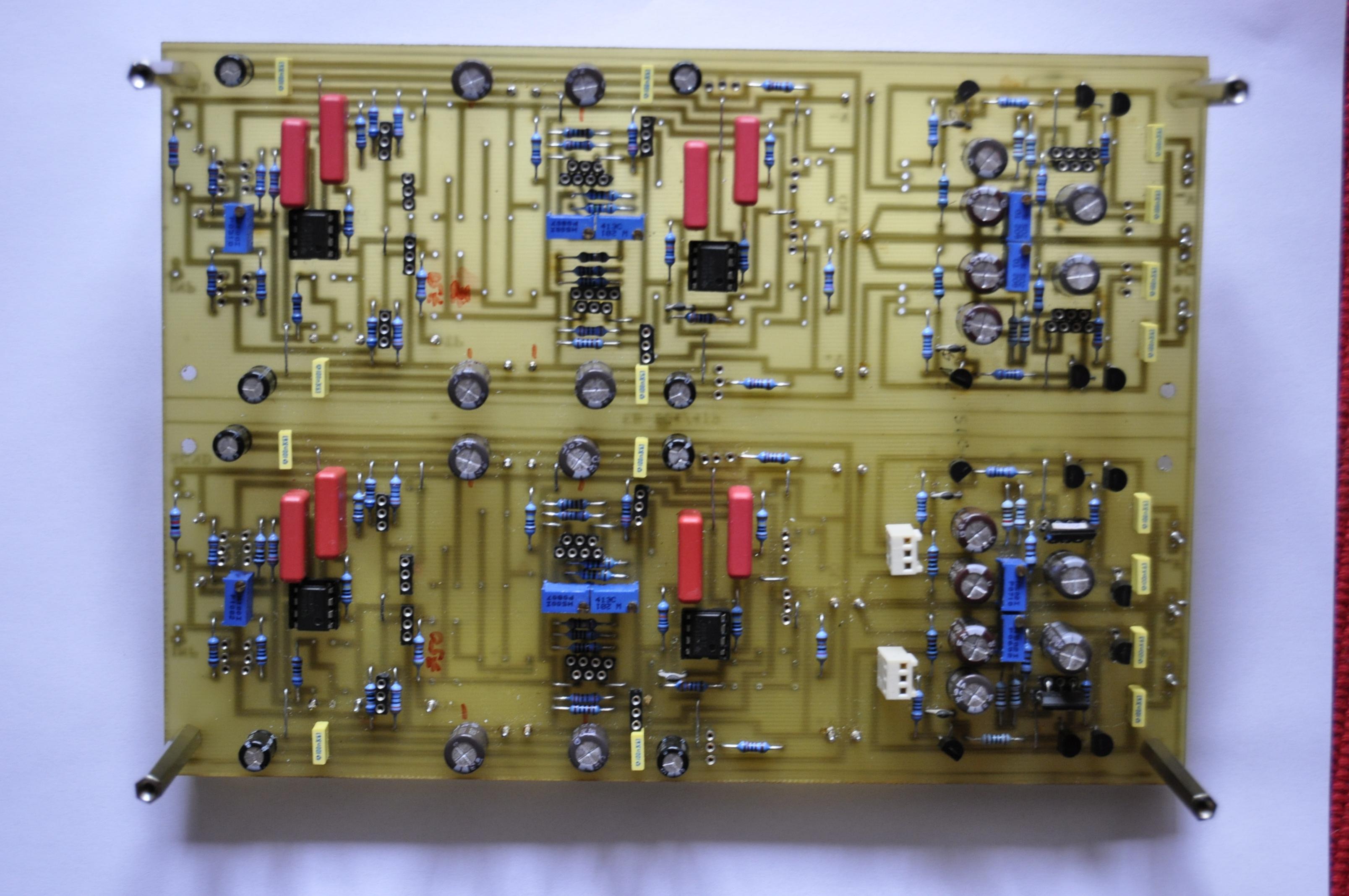

You are surprising me. I have made all the electronic in my system for my own use. I hope you have done the same, I know that you designed and built first rate commercial headphone amplifier. Adapt it to line preamp and you will have something of Spectral level.
My best equipment are designed by Borbely, very underestimated designer.
His designs, even the old ones are the best possible-phono,line and power amps.ClassA, high working voltage, low noise ,DC servo , cascoded input etc.
I made PCB myself since I liked to use specific high quality material.
Combine it with good connectors , selector switch and pots and will get the highest quality units. Many snobs prefer of course famous brands to show their status and to sell later easier as a second hand. Audio equipment should serve to listening to the music, it is not part of the furniture.
I am just finishing this Borbely phono. I have some spare J-Fets and it costs me very little. Very similar to Vendetta.

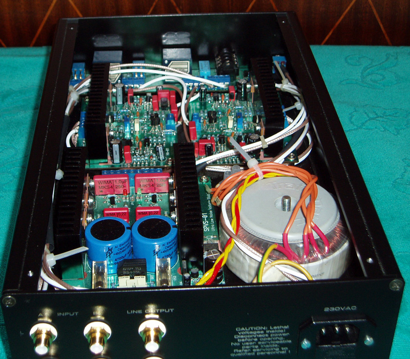

I have found this picture of headphone amp made by DVV. Very good profesional work.
Actually, that was prototype No. ?, I can't remember them all. Its value today is twofold: first, it is proof of my own work, not one circuit was copie from anyone, although I am sure many have made similar circuits, and some are probably better than the ones I used, and second, it sure plays some good music.
It also an example of the worth of listening to others. Originally, I wanted to bias it at around 40 mA, which should be enough for pure class A operation with most headphones with an impedance of 30 Ohms or more- But, somewhere along the way, my favorite German told me I shuld try biasing it at 80 mA, and that while theoretically it should make little difference, if any, in real life it WILL sound better. I did try it and I do agree it sounds just that little bit better at a higher bias level. That cost me redoing the PCBs to accomodate larger heat sinks, but I feel it was worth it.
The same man suggested a FET input, MOSFET output version, so I made one of those as well. Then I friend suggested an all tube version, I said no because I know next to nothing about tubes, but he knows a lot more than I probably ever will, so he designed it.
To my mind, the best overall presentation was offered by the BJT version, which uses Motorola/ON Semi's MJE 15030/15031 devices in a SEPP configuration. The whole ciruit uses a fully complementary topology. The tube version has a better midrange presentation, but is lacking in force and sheer "oomph!". The FET/MOSFET vresions is all rigght, but not much more than that; I used IRF MOSFETS, my favorite German sayas I should have used other devices, and since he has always been right so far, I will have to try that as well.

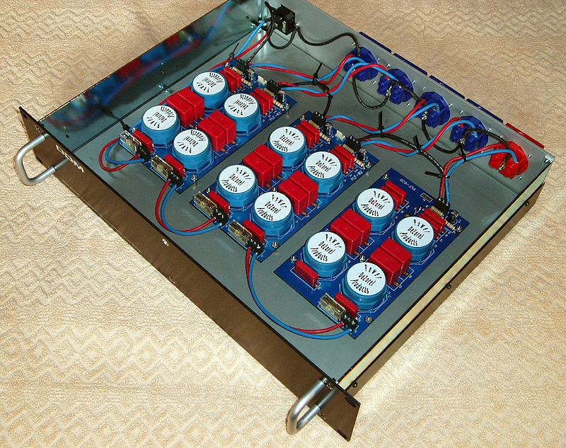

But this is the core of my work, the power line filters. This is model Quintet, which has one Super Filter (handles 20 Amps at 220 VAC) and four standard filters (only 10 Amps each at 220 VAC), providing for full protection of each device both from the grid and from each other.
It does NOT need the ground for operation at all, ground is used for display LEDs only. Therefore, it cannot be upset by sudden ground potential changes, nor can it introduce any itself. 100% symmetrical, it has no real "in" and "out" side, works the same both ways. This is version No. 11, the last thus far. It has completely reworked circuit layout, one sode of the two sided board being dedicated to ground to reduce interference. You can put it on top of a tuner, right above the front end, and you will experience zero disturbance. Bottom plate is made out of pure copper.
