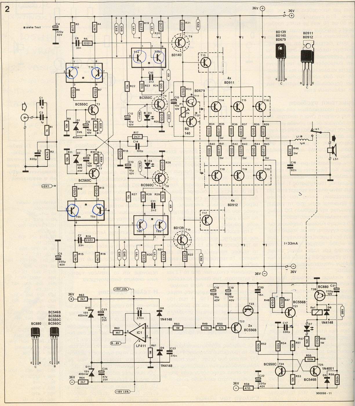

Many years ago, Europe's "Elektor" magazine did a design for just that, a very high quality low impedance power amp, however, it was designed straight off the drawing board for it and had appropriate power supply lines for it. I'll dig up my archives, see if I kept it.

For continuous power in a 2 ohm load, not 1. (and not biased well)
Yep, what were they using for outputs , only 3 pr , 36V psu ...
No, Jacco, that's their mid power amp, rated at 50W/8 Ohms nominally. I know it well, it's very popular locally. Uses 90W devices (BD911/912) at the output, for low impedance loads you'd have to use at least 200W devices.

only 3 pr, 36V psu
Just an example, and not exactly a good amplifier.
Total Pd of the output stage is about 9 times the continuous power in 8 ohm. (e.g. the Gigant design does less than 5)
Beyond 30-40Vdc rails, life becomes much more difficult for bipolar output stage devices (beta and SOA)
