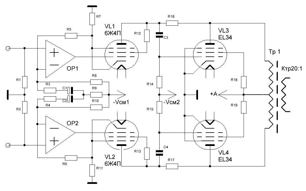

I believe it has a typo in the article, it should use EL34 tubes, not EL84. For EL84 470 Ohm in cathodes is too much.
EL 34 is fine . Mine came out of Chipping Norton Studios , they are antiquated with good music . The topology was my interest . Things I have tried but not in this mix .
Thanks anyway . Like seeing a Delta-wing it's the shape I need . The bottle I would have worked out . The triode like anode to grid shunt feedback unimpeded by the impedance of the driver stage I like . I think that's right ? Nice to see transistors lending a hand .

01N100 has wide spread of parameters, as well as tubes, so anyway you need to select proper value for the resistor in drain; no way 820 Ohm will fit any random mosfet and tube combination. Select it for 100V on cathode, you will get 100 mA idle current as the result. That means 35W dissipation. For an average Gu-50 in such mode you will have about -30 V on G1 in respect to cathode. But if you set idle current 70 mA as drawn on schematic you will have about -35V on g1 in respect to cathode and even lower anode power dissipation.
This one is better: no transistors that add to emitter current base current dependent on beta (non-linear). Schematic drawn by Alexander from diyaudio.ru forum.

I found the original . I did have a go to build it . Start with a cathode current sink I would say . I think some call these Frankenstein amps . That makes me want to build them . I did find using this type of shunt feedback to the power valve gives exact triode distortion spectrum with a nice gain bonus . About 30% typical in RH88 version . It is a cheap lunch . I must say when I use valves the Frankenstein comes over me . I have to see the anodes glow even though I shouldn't . The only transistor I knew to tolerate that was a BD131 . Smoke came out yet it continued to work when the fault corrected !
DVV , you neatly bring me full circle . This is an amplifier that can have no existence without global feedback . The output transformer-less type . Philips I seem to remember used it in pentode form for TV's . If a special speaker is made it can have special advantages ( 32 ohm ) . Having heard such an amp I was very surprised , lightning fast . It might have been the distortion spectrum fooling my ears .
No way. Use resistor in cathode, because MOSFET can't keep stable voltage on the control grid.
Use 1k trimpot for R2 in source of MOSFET. Rotate it on minimum. Power on. Slowly rotate the trmpot to set desired idle current measuring voltage across cathode resistor. Listen and enjoy.
I was thinking just to get some indications . Myself , I used a high value resistor and reduced it . Something went wrong and it got a bit wild for a minute. I think I calculated >100 W dissipated . The valve was fine . I wouldn't advocate a current sink for permanent use as it is at best too complicated . Many times I wish I had used one in the initial stages of a design . I have a current setting on my bench power supply , it has save the day so many times . I must say DC coupling an amp like this seems a bridge too far .
Suppose the MOSFET draws too low current. That means too high voltage on grid, hence on cathode. Can your current sink stay alive? Gu-50 can dissipate more than 100W easily. It survives even orange glow (Nickel alloy anode). What about that tiny peace of silicone that you use for CCS?
