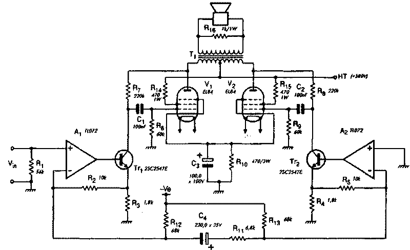

Here is one more interesting amp with local only feedbacks (attached, from vintage magazine). Output stage has deep local feedback by voltage and input resistance of few kiloohms only. Driver has deep feedback by current and high output resistance. The overall result is quite remarkable.
