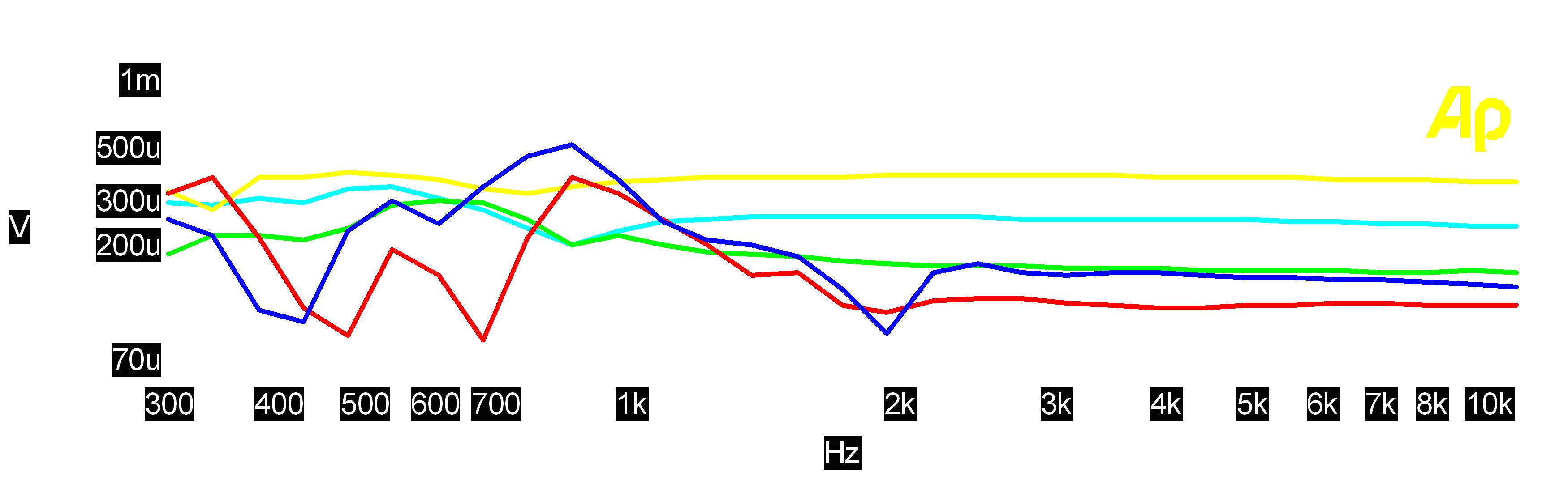

I said -140dB and they were a mix of ordinary SMT (the Digi-Key mass quantity mix) and our 400 atom thick thin film, probably some COG's thrown in the mix, all bypassed with SMT electrolytics. All horrible stuff. The thirds on your plot would have stuck out like a sore thumb. We have a nice really smart new apps guy and he was called on the carpet because a non local designer couldn't believe their part was not better than this one, I had to referee.
Yes, my point is that in many new designs the passive component selection is quite important as what used to be the limit is no longer!
I've attached some capacitor vibration plots. The electrical excitation was a 9 volt battery. I need to dig for the actual acceleration but figure with just normal baseline vibration the voltage levels will be 45 db down. So all of these parts would cause problems in something as common as a phono preamp!
I was going to question Doug Self not specifying the big can at his MC input. I don't use them in the signal path. OTOH I have had quite tap sensitive 1nV preamps that exhibited no problem sitting on the bench with just a soft silicone damping pad.

You just explained why for some audio preamps magic pads under the unit's feet can actually do something! Yes getting rid of vibration is one solution.
It also turns out capacitors are sensitive to vibration in the direction that impacts the parallel plates the most.

The effect of vibration on components and circuitry itself can be measured. It is all part of the design process to make sure that all sources of distortion are addressed at the SAME level.
Gluing a capacitor to the circuit board will help some circuits. Gluing all capacitors to circuit boards just makes a mess of those that were designed to account for vibration issues.
