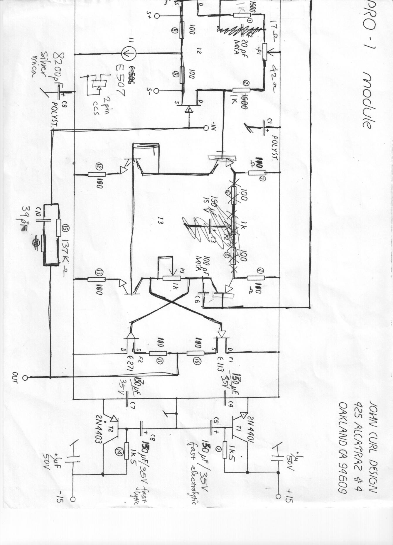

Nigel, the fact that you like this amp is not the point. It is a fairly straight forward, but primitive, design. This design comes originally from Dick Burwin in about 1966, as an OP AMP, when he designed hybrid op amps for Analog Devices. Walt Jung, Op amp history
The first power amp version was the Marantz 14 solid state amplifier in about 1968, by Sid Smith (I think).
The first fet in-out version that I made was the phono input stage of the Levinson JC-2 in 1973.
Look at my 'studio board op amp' from 1977. Can you see the resemblance?
Let's start there.

Please excuse the 'condition' of this copy of the pro audio board. I can't find a better copy at the moment. This is a plug-in board that I designed to replace typical op amps, back 35 years ago.
As far as an OP AMP is concerned, the only real difference is the dual jfet input stage. The bipolar transistors in the mid-stage are part of a bipolar matched quad that Motorola once made. On the inputs and outputs, either bipolar, jfet, or mosfets can be inserted, and 'presto', your circuit, the Levinson JC-2 phono stage, the Spectral phono stage, etc, etc. As a power amp, it's OK.
Really that's interesting no input degeneration and no load on the VAS. Looks like as much Aol as possible and lots of feedback, typical op-amp on steroids power amp. Several parts added to make AC CMRR as bad as possible too.
It was an application note , not a complete design..

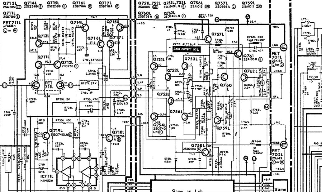

Hitachi s own implementations at the time could be
quite less simplistic in some of their amps...
And if you look at the best distortion performance it is -94 db. Around the limit for the feedback network components! (Assuming typical 1/4 W carbon film resistor and large case size electrolytic.)

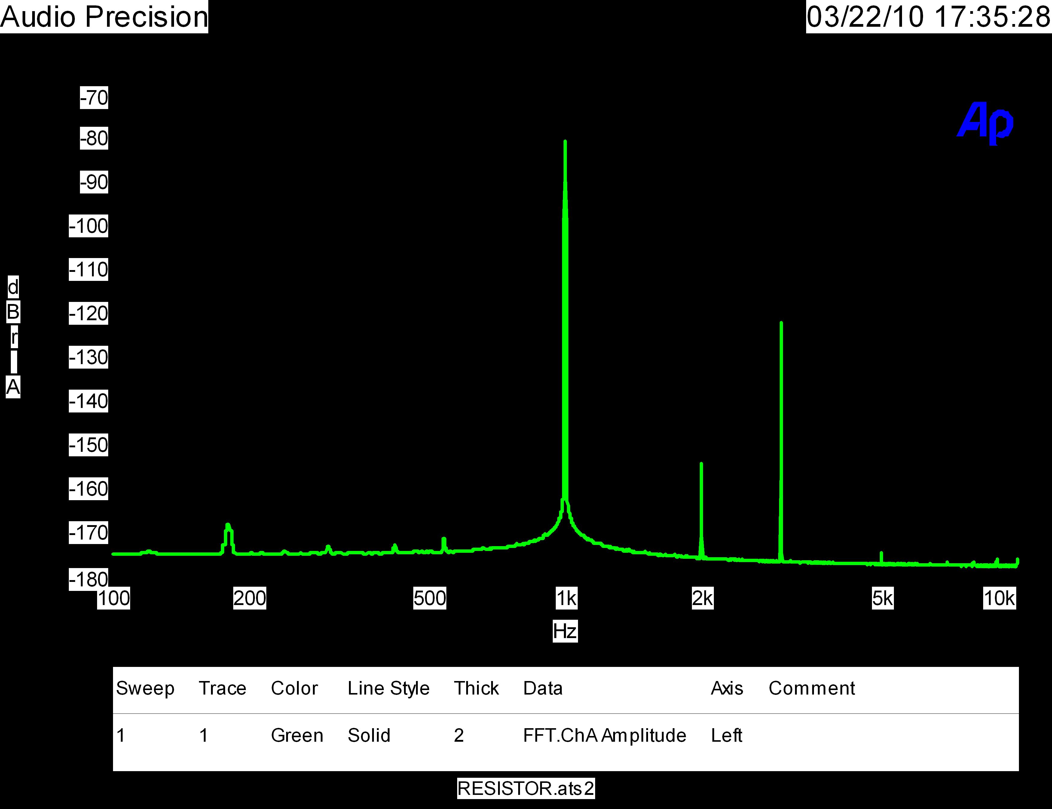

I was looking for some data for my current article, when I came across this measurement of a Vishay 100 PPM Thick Film resistor. This type of resistor used in a feedback loop for your new chip at 1/16 rated power would limit the performance below that of the entire rest of the circuit!

I said -140dB and they were a mix of ordinary SMT (the Digi-Key mass quantity mix) and our 400 atom thick thin film, probably some COG's thrown in the mix, all bypassed with SMT electrolytics. All horrible stuff. The thirds on your plot would have stuck out like a sore thumb. We have a nice really smart new apps guy and he was called on the carpet because a non local designer couldn't believe their part was not better than this one, I had to referee.
