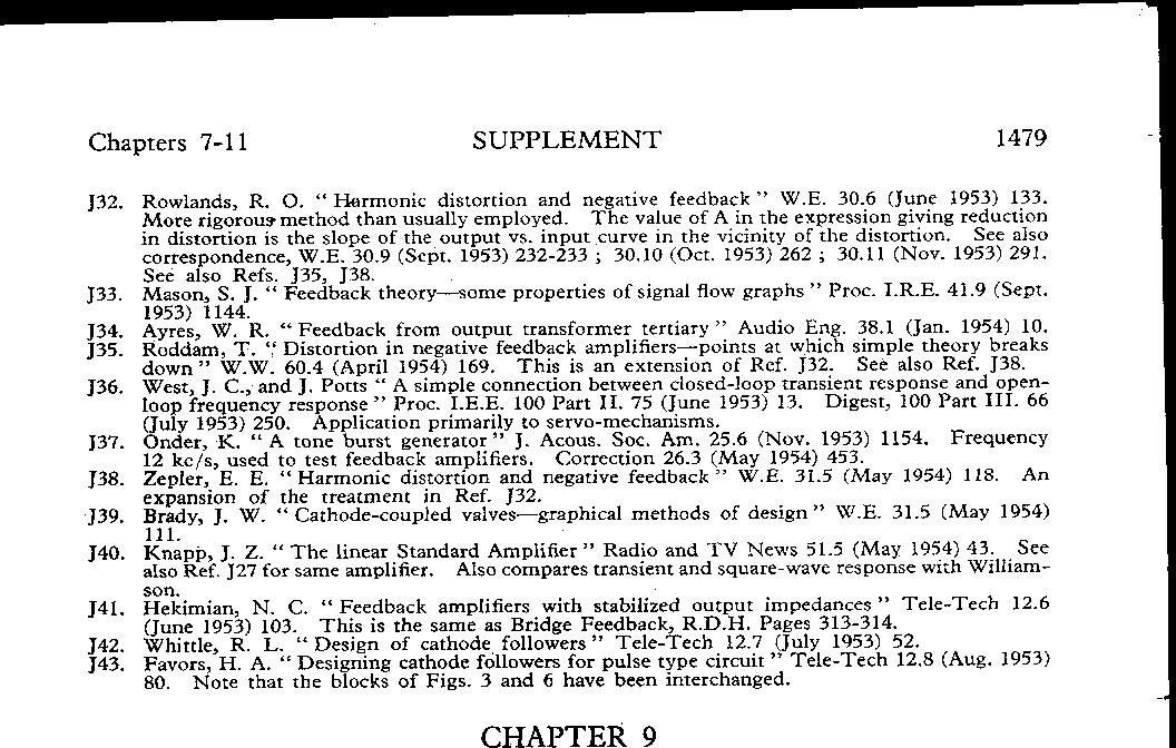

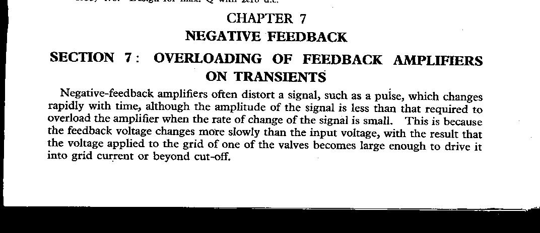

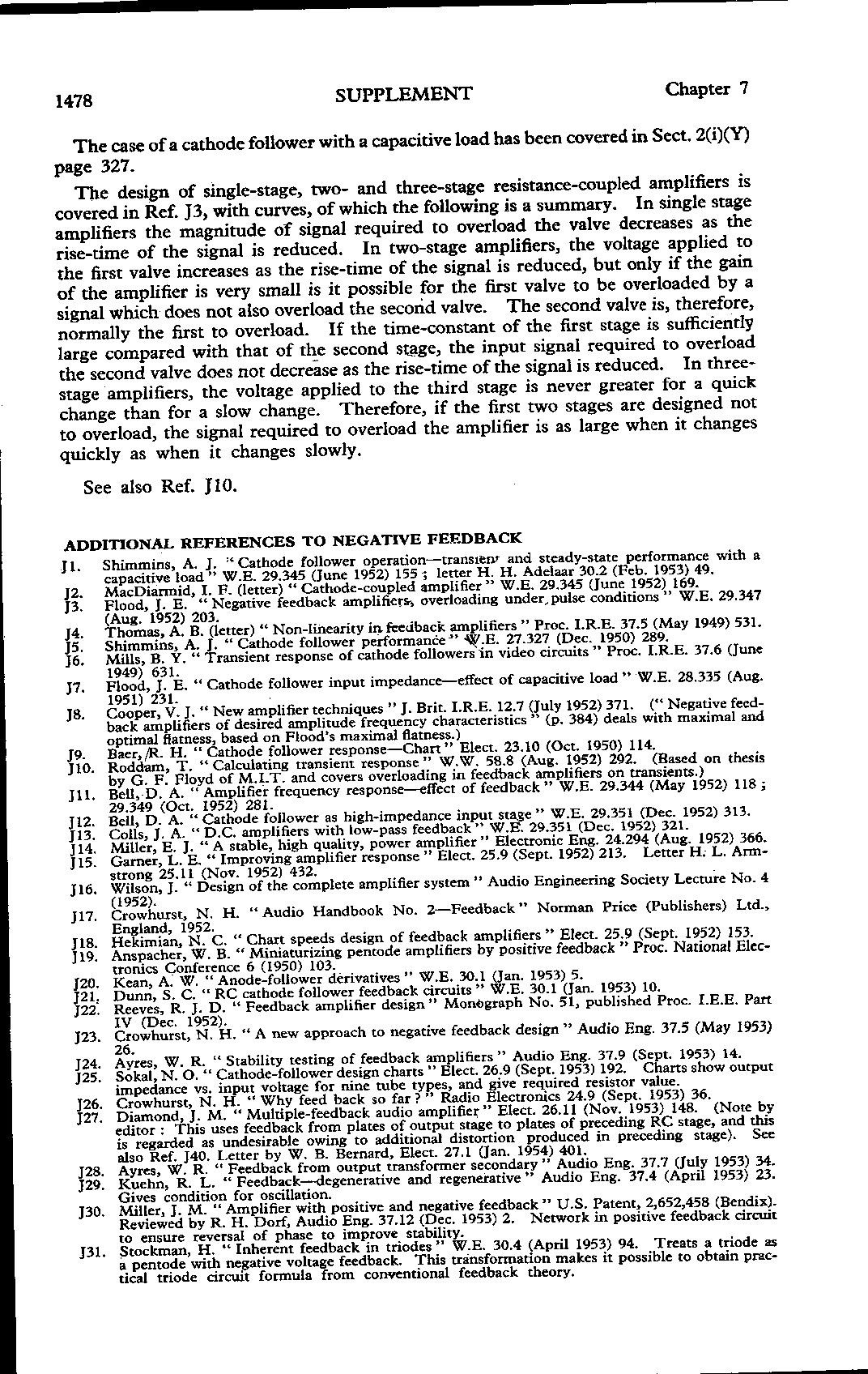

An older reference
Langford-Smith ed., Radiotron Designer's Handbook 4th ed. 1952, supplement as it appears in April 1965 printing.
Although little detail is provided, it's clear that people were both aware of and concerned about high rate-of-change signals overloading feedback amplifiers.
Sure it is, it was our linear design BIBLE at the time.
Although I treasure my copy, there is only so much room in a single book, regardless of how lengthy, particularly one that has a unified treatment of both tubes and transistors.
A quote from the chapter Large-Signal Amplifiers: "If careful choice of device and operating conditions and the use of local feedback do not reduce the static nonlinearity [note the implication that there is a dynamic nonlinearity 😀] to an acceptable value, over-all feedback must be used in addition. With so many design variables involved, there is little wonder that the designers of very-low-distortion audio amplifiers achieve fame and often have standardized amplifiers named after them!" (Cherry and Hooper, Amplifying Devices and Low-Pass Amplifier Design, Wiley, 1968, pg. 879).
