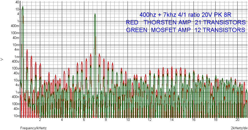

This is not true , i simulated a lot of amps including Thorsten s one
and it does not make exception to the rule that low feedback amps
have very high level of IMD , even if loads of active devices are used....
As an exemple , a comparison with a very simple design that has about
66 dB open loop gain and 1 khz OL bandwith.

Wahab, do not make judgements on basis of one or two samples only - one swallow doth not a spring make.
My point is, there are many possible topologies, and they will not all behave the same way. That's the trick of it, to pick one and really make it work, which implies that your are literally intimate with the adopted topology, that you know your tansistors inside out, etc, etc, etc. Slapping it together to simply work electrically is easy, but making it work as best as it can, well, that's THE trick and that takes time and effort.
You investigated Thorsten's first sample only. I don't know how far he's got, but rest assured he has worked on it and the latest version, whichever it may be, will work better than the initial one.
It's even possible that he has gone as far as to change the topology.
Just one off hand example. Let's say you decide to use BF 471/472 transistors. They are very hard to work with because they are finnicky and very picky, but are good to use because once you get to know them, their sound can be most rewarding. But, they have their very own set of requirements, especially related to bias. Run them at 3 mA, 4 mA and 5 mA and you will get three sets of results where the 3 mA performance looks like from another planet in comparison with the 5 mA results. Totally another matter altogether, no way anyone would even guess that it's the same transistor.
Then again, much depends on their operating load. Give them 10k, that's one thing, give them 30k and that's something else altogether. Not just THD, but overall behavior.
Their specifications notwithstanding, run them at 3 mA and they will do wonders; run them at 5 mA (constant current) and they may well wreak havoc on you. As I said, very picky, very finnicky. But worth the extra effort.
