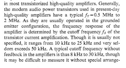

See snip from Otala, why must we remain with our heads in the past? 50KHz follower bandwidths are long gone.
