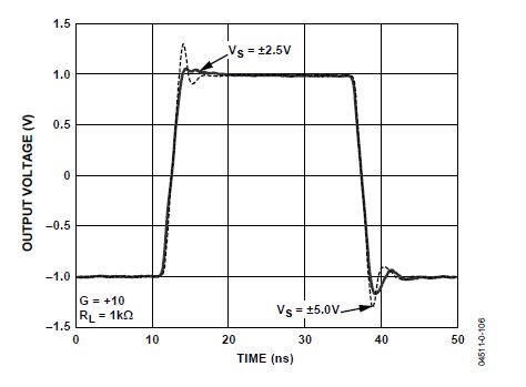

Propagation delay in typical Op-Amp type structures is several microseconds, even fully uncompensated comparators usually have propagation delays in the 100's of nanoseconds.
Ciao T
Better tell the guys doing 40G Ethernet, we have plenty of comparators with 10's of femto-sec delay. There are dozens of op-amps with nsec closed loop delay, maybe your talking about open-loop? Please explain, input on fig below was applied slightly after 10ns (I could get an exact number)?

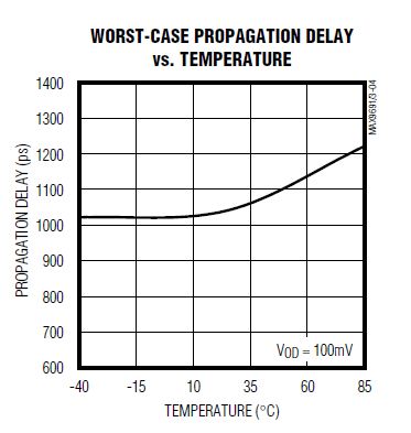

I just grabbed an AD8099 plot there are faster. The comparators/lim-amps are buried inside networking products, one will be featured in Jan. Electronics Products (I'm under gag order) 😀
EDIT - Maxim part, 1nsec
