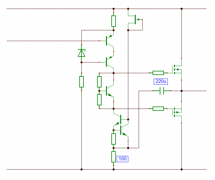

Brad, doesn't this ring of two have poor neg supply PSRR?

And as one contemplates it, the ring of two is a lot better for PSR than it might appear at first. The sensitivity of the effective reference voltage, Vbe of the error amp transistor Q1, to changes in the power supply via R1, is reciprocal to the transconductance of that device. And the input impedance at the base of Q2 is low, again due to feedback. So if we wiggle the power supply voltage, the major effect is reference voltage modulation, and that is about (delta V)/(R1*gm), and the effect on output current is calculated as the ratio of that to the emitter resistor R3.
If R1 is replaced by a higher-impedance source of current things get a lot better still. But for two transistors the performance is pretty nice.

Well, if it drops out, it drops out. The ring of two drops out < 1V, the emitter follower maybe another 0.7V. Should not be really THAT much worse than original.
But yes, a separate boosted set of supply rails for the frontend would help.
BTW, there is of course the other option, a 100 Ohm resistor in series to the ring of two CCS and a 220uF electolytic capacitor from the junction to the output, but that option is entierly too obvious and way to simple for the "if uses ten parts where one will do it has to be good" brigade... Plus the active version should be a trifle better.
OK. Yes replacing R1 with a simple CCS would also be my preference.

You made some remarks a while back about the clamp zeners, their apparent contribution to distortion, and whether they were necessary or not. Attached is a way of using two zeners with biasing and small-signal diodes with much lower capacitance to mitigate any effects of variable C. There is a small amount of current pulled from the rails to keep the zeners biased on, and a tiny bit of additional loading on the output with signal swing.
So two zeners are saved, and four small-signal diodes are added (~1N4148 would work fine for ~50V rails).
It's possible that in some circumstances the traces to the FETs might be a little long, i.e., high inductance, in which case local zeners for each transistor might be indicated.
Cool. In the case of the Hafler, it is worse than long traces, it is a couple inches of wire to the sockets. That is why I moved the gate stoppers onto the socket and used thinner wire to the gates. That seemed to help tame the Mhz range oscillations.
