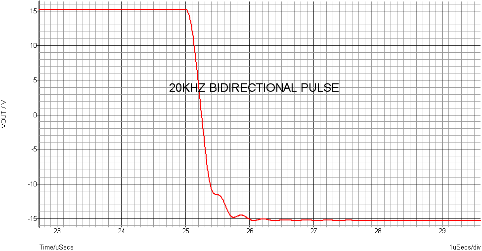

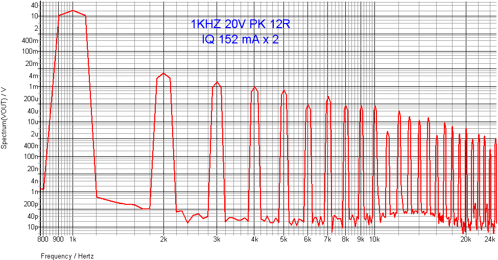

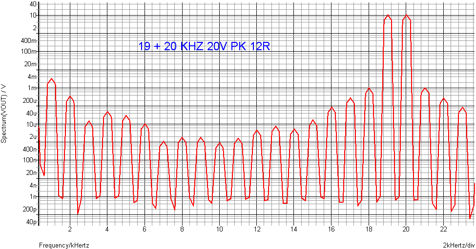

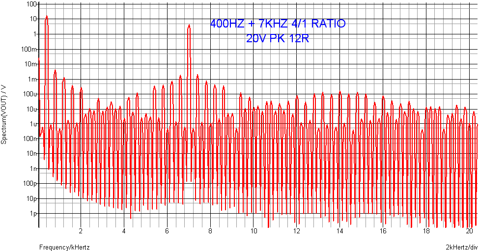

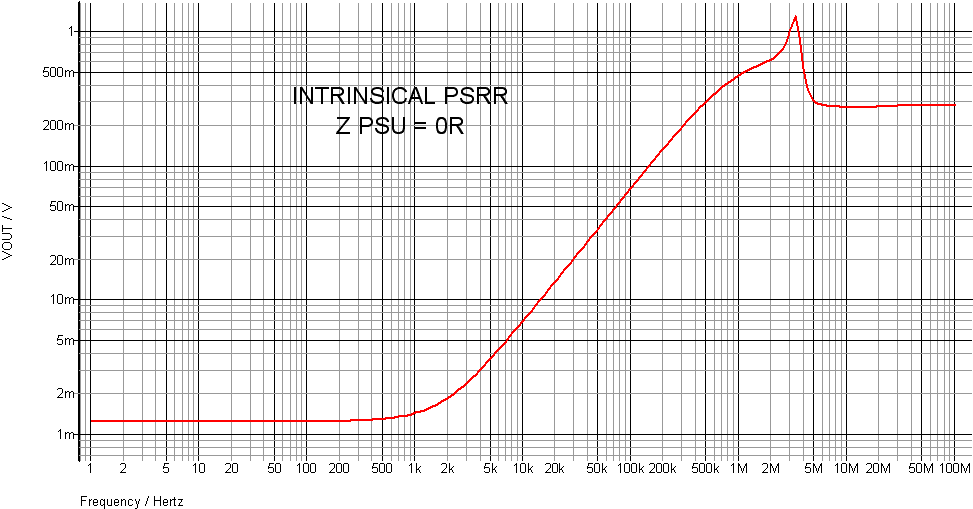

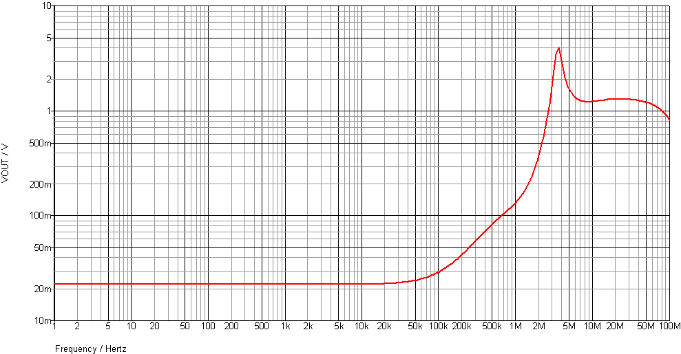

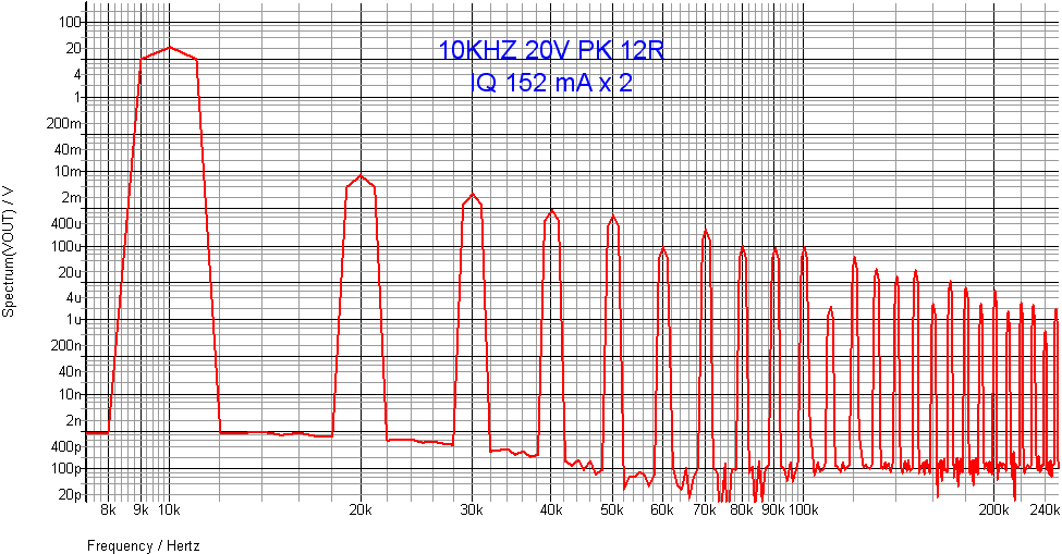

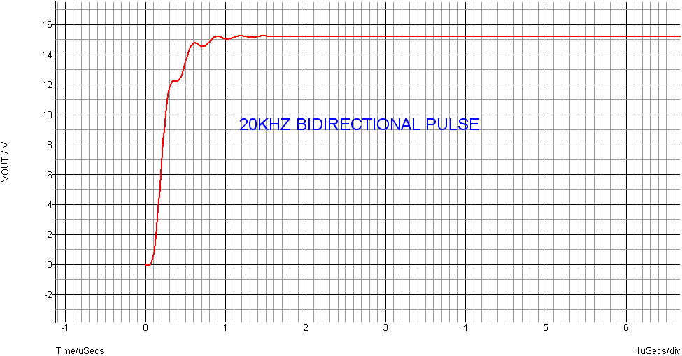

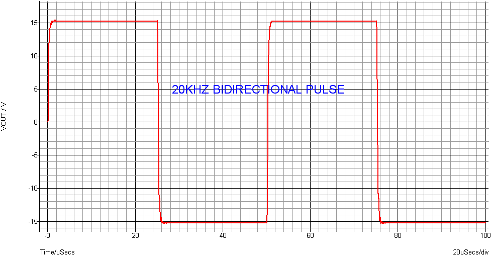

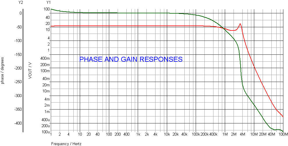

Unfortunately , my free simulator has limited nodes number
so i simulated with two pairs of output devices , each pair
being biaised at 152mA for a total of 304mA quiescent current.
The load is increased to 12R to compensate a little for
the absent third pair , albeit at those high bias currents it makes
little difference in respect of the relatively low simulated output level.
A classical dominant pole compensation works better in this amp ,
about 22pF from the VAS collectors to their fets drivers gates,
while at the same time increasing the two 100K local loop FB resistors
to at least 1M.
Phase response will be correct , IMD 400/7K is significantly lower
wich is important since this measure is way more significant than
the overkill 19+20K tests.
The use of a full fet cascode is useless , the upper pair can be replaced
by bjts with no change in the perfs.
Also , the fet differential input pair must have no more than 8/12V Vgd
as generaly the drain/gate leaking current rise very sharply above those values.
Ahh, okay, now it makes sense. Maybe even drop another pair and use 16R, if it helps to preserve the rest.
Not going to happen. This creates the usual amp with the usual results. Not interested.
I see around 0.05% IMD for 25W/8R equaivalent, or -8dB. I am not very perturbed. I know you want to see -90dB, but that is your goal, not mine.
As the circuit uses essentially a Hawkesford cascode with a bootstrapped CCS feeding is, this is indeed so. However someone already put the Fet's there, so I'll keep them. ;-)
For anyone building from scratch BJT's are indeed fine.
I don't have the curves for the 2SK246, however lowered drain current reduces the gate leakage.
Here the input Fet's are running at maybe 0.2mA (which means we will have around 2.2V reverse bias on the input diodes, which has it's own rewards) and I'm estimating maybe 5nA at the set 25V appx., so nothing to loose sleep.

Unfortunately , my free simulator has limited nodes number so i simulated with two pairs of output devices , each pair
being biaised at 152mA for a total of 304mA quiescent current. The load is increased to 12R to compensate a little for the absent third pair , albeit at those high bias currents it makes little difference in respect of the relatively low simulated output level.
A classical dominant pole compensation works better in this amp , about 22pF from the VAS collectors to their fets drivers gates,
to at least 1M.
Phase response will be correct , IMD 400/7K is significantly lower wich is important since this measure is way more significant than the overkill 19+20K tests.
