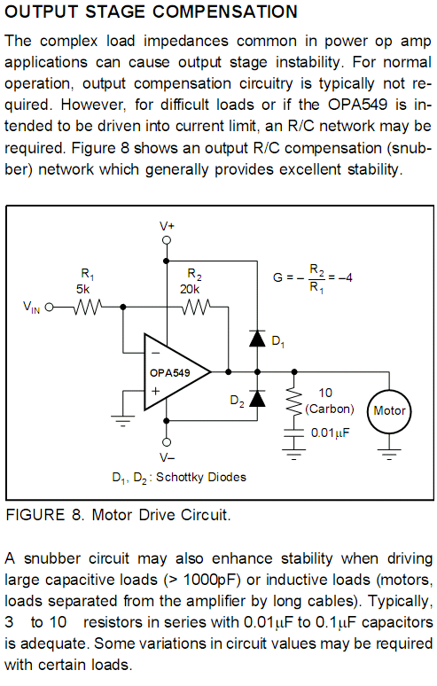

It is still a compensation network... as such it should be measured in order to know what you're compensating for and by how much or how little. I think that point stands. Otherwise you end up with the kind of results where some people try whatever values and experience whatever results, as we often see in this impedance correction case. This is truly incorrect and serves little puporse to further the science.
Snubber is also a very general term leading to some confusion perhaps, I think however it is realized that it serves many purposes.
If you read what mrfeedback had to say on the matter as per its use in this instance, you'll understand that you correct for the impedance curve by using a multitude of caps of various values to tune the impedance for flattest/widest response(and types in order to tune the sound properly), the parasitics of this network are going to cause oscillations among them which the RC portion or lossy electrolytic can help snub (ooops, I meant damp), all things above should in fact best be measured or you're just working blindly and throwing money at it for nothing without really knowing if it's doing any good or worse.

classd4sure said:Snubber is also a very general term leading to some confusion perhaps, I think however it is realized that it serves many purposes.
Yeah, it's very 'general'.
