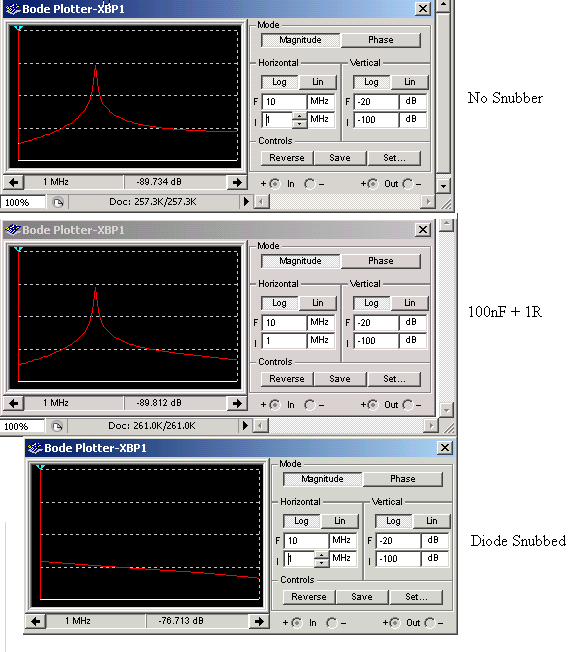

you can see the difference in impedance curves with JosephK's work with the HP3577 network analyzer -- when you get into the low a.m. band 🙂
i tried it, could hear no difference with the RC zobel. horses for courses I guess.
the diode snubber does have a measurable effect BUT once you load the power supply the problem of diode ringing gets swamped with the charge/discharge cycle of the filter caps -- probably of much greater concern for low current applications using EI transformers...and that is why ==>
the other Charles Hansen updated his IMD analyzer in the most recent issue of AX and used a diode snubber -- but where he derived the values from I have no idea -- two high a value of C pulls the ringing frequency into the audio band.

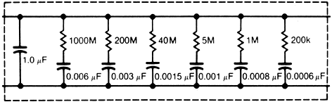

metalman said:Personally I'm hoping Charles, with further investigation, will be able to shine some light on what the snubbers are doing.
I really don't understand all of the details that are involved. It seems odd to me that a snubber by itself (without an additional bypass capacitor) sounds bad.
Maybe the problem is that by adding a snubber, we are actually creating a composite capacitor that has a small amount of dielectric absorption. The image below is taken from Bob Pease's article:
http://www.national.com/rap/Application/0,1570,28,00.html
