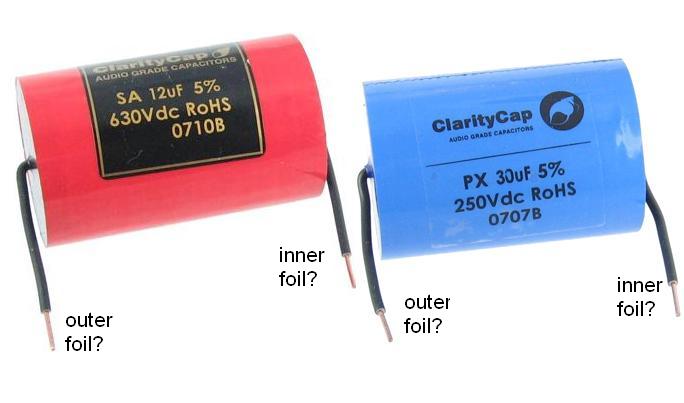

OK, so...
If I understand you, when reading the label:"Clarity Cap" the left-hand lead (closest to the "C" in Clarity) is probably the OUTER FOIL lead, and should be connected to the input, while the right hand lead (closest to the "p" in Cap) is the inner foil and should go towards the tweeter + terminal... Right?
Has anyone else found this?
Joe

you're missing a point there, "direction" of a film cap refers to actual construction assymetry - one foil/electrode is on the "outside"
this is a real issue with film caps; being physically large they can be good electric field pickups
the outer foil's terminal should be connected to the lower impedance node to reduce its effect as an electric field reciever antenna and so it serves as a electric field sheid for the more sensitve high impedance node
True point and easily demonstrated. Connect a small valued film capacitor as the shunt capacitor of a low-pass filter, with a highish valued series resistor as the series element (and with the filter driving a high impedance load such as a power amp input). Listen to what comes out when you lay your finger against the side of the cap: with one orientation you'll be able to induce hum from your body pickup, with the other you won't be able to.
Whether that will matter in most uses is another thing. Power supply bypasses, series blocking caps with very low cutoffs (big caps) likely won't care about orientation.
