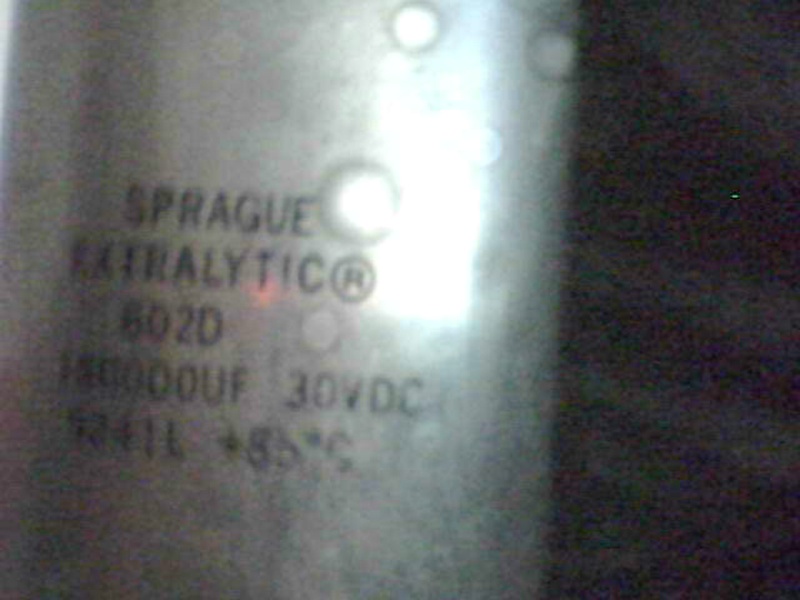

Hi guys,
I plan to build Le Monstre and Mini Aleph. I find this SPRAQUE EXTRALYTIC 180000uf 30 VDC. Is this genuine or fake?
Thank you Gentlemen,
Best Regard,
Josh
