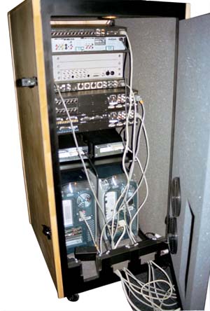

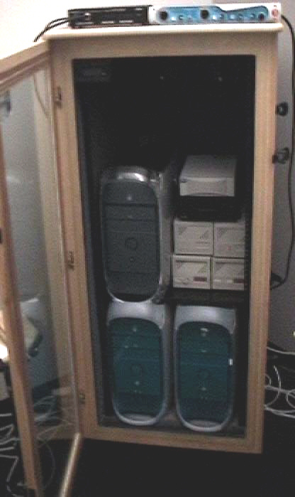

my computer - video editing workstation, is very noisy. i do not have noise level meter, and maybe even better, considering how much noise this workstation makes. some people change fans in the computer case/power supply, but it seems that would not be enough in my case, because much of the noise comes from workstation's numerous hard drives. maybe the easiest solution for my problem is a sound insulation enclosure, a cabinet ( http://www.iso-box.com/Isobox_post_production.php?photos ). unfortunately, my computer wouldn't fit in any available sound insulation cabinet on the market, or the cabinet wouldn't fit into my budget, so the only choice left is to try build one - diy.
nominal power of the computer is 1100w. according to this diagram (http://putfile.com/pic.php?pic=10/28508491144.jpg&s=x10 ), it seems that sufficient air flow to cool this computer in this insulation enclosure would be 200-250m3/h or 120-150cfm. is this right?

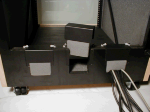

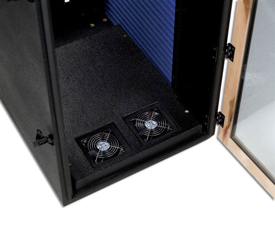

in order to muffle the noise of the enclosure ventilation fans, both intake and exhaust fans must have their own noise protection, some kind of sound labyrinth, see http://www.carsten-buschmann.de/noise-protection/section.htm and http://www.carsten-buschmann.de/noise-protection/details.htm . the biggest unknown to me are the size and design of that sound labyrinth? in theory, the sound should be weakened by passing the long tunnels of the zigzag-shaped labyrinth lined with some sound absorption material. how many 180 degree bends are sufficient to absorb both high and low frequency noises? how narrow the tunnels/labyrinth should be to absorb the fan noise and allow suficient airflow?
in my understanding, it is a must to avoid compression of the air propelled by fans and the noise of the turbulence caused by that compressed air. therefore, it seems to me that sound labyrinth surface must have at least the same area as fans. in this case, it seems that 2 papst fans model 4214nl (119 x 119 x 38 mm) are the best choice, providing required air flow. 2 fans have surface of 2 x 113cm2 = 226cm or 40 sq inch. accordingly, labyrinth surface area should be at least the same. is this right? if i build bigger labyrinth surface area, would that cancel the muffler effect of the labyrinth - and make sound pass thru easier? any thoughts? also the shape of that surface is tricky... 40 sq inch: is it the same if labyrinth is 1 inch x 40 inch or 8 inch x 5 inch? http://www.carsten-buschmann.de/schallschutz/vorne.jpg is this too narrow? http://www.carsten-buschmann.de/noise-protection/details.htm
materials for the cabinet...
it is obvious that cabinet must be built with sound insulation materials, for both, low and high frequencies. the problem is that every manufacturer of the sound insulating materials claims only his material provide real / the best sound insulation. who can guesstimate which sound insulating materials/manufacturers to be applied for the inside of the cabinet?
aditional pictures
intake fans: http://www.iso-box.com/images/post/post_fans.jpg
exhaust fans: http://www.iso-box.com/images/post/post_back.jpg

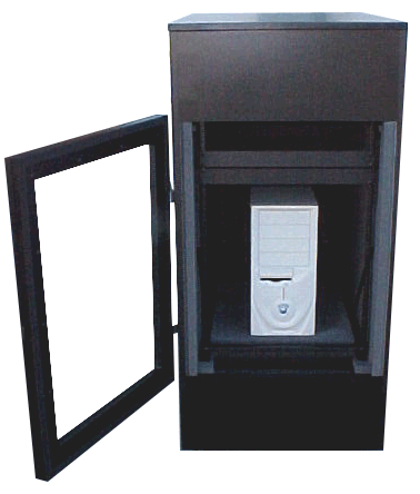

cabinets
http://putfile.com/pic.php?pic=10/30223091195.gif&s=x11
http://putfile.com/pic.php?pic=10/30223085272.gif&s=x11
http://putfile.com/pic.php?pic=10/30223081929.jpg&s=x11
