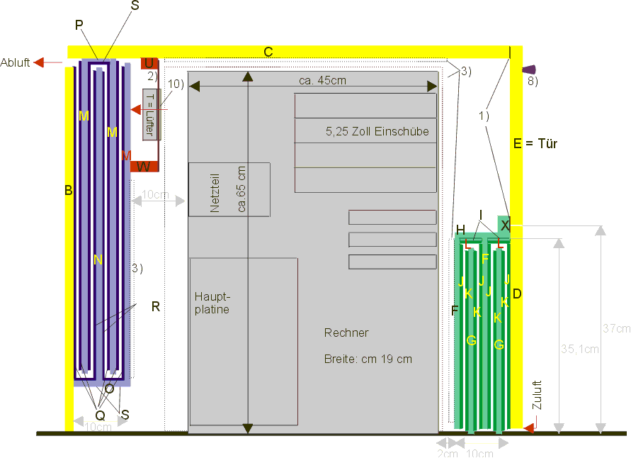

Insulated cabinets can be built like you've shown in the examples. I'll come to that in a bit.
If you have so much LF inside the enclosure I see car damping materials like drywall and carpet are good blocking materials. Apply a couple of layers to the inside. Please remember that this will raise your temperatures a bit.

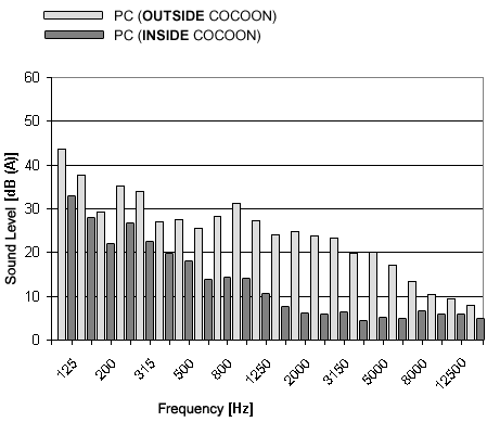

There's a pretty dramatic increase in noise and noise frequency after closing the cabinet/going outside the cabinet. This would be fan and airflow noise. Unless you do install quieter fans and/or ducting, maybe there is no other solution for this noise.

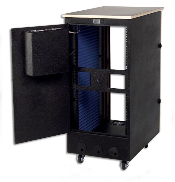

It looks to me the ones you've shown are more organising cabinets than soundproofing enclosures. You may have to dig a little deeper.
Start with material choice. 450 lbs means thinking of thick wooden base. Industrial strength feet. Or think steel extrusions and panels, with damping and sealing to keep the noise out.
Your main problem is how to get cool air into the system enclosure. Unless you plan to watercool the whole thing, you'll have to duct in the fresh stuff from somewhere.
Condensation will happen if you let warm air into a cool area. http://www.ocforums.com/showthread.php?t=401635&highlight=Ducts post #6 explains condensation. Critical thing is to seal it off, and yes, it is not without risk. So don't play with it if you're not comfortable. But as long as the air is always cool, you should be OK. The problem would happen if you let the cold air in after the PC is warmed up and still has hotspots.
The idea is to get some air into the system that is cooler than ambient, so overall temps stay in control. I would not advise to put an air conditioner if it is more noisy than the PC, but a small split or cassette makes practically no noise. A window unit would be a serious racket.
Then damping the enclosure, using more drywall and carpet. This will help a bit if you are using strong and stiff materials to make the enclosure.
Last planning for the exhaust. I am quite taken with the idea of leaving the whole back open initially and then using a tall tapering chimney to exhaust the air upwards, in the process sealing off the back. Keep the chimney removable from the frame and use gaskets to seal the airflow.

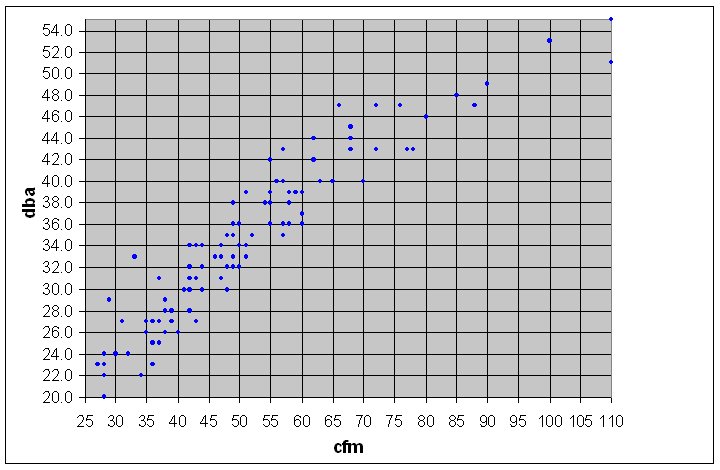

I only want to make one point on fans and fan noise.
There are two sources of fan noise. One is the fan's self-noise or mechanical noise. Good engineering will minimise this. Some models of fans are specifically aimed at reducing noise, but only mechanical noise. Papst, Panasonic and Thermaltake all have a 'silent' line of fans in addition to their main lines.
The second source is the air noise, caused by the movement of air. We all know that exhaling is quieter than whistling. Small apertures increase turbulence and noise. Large apertures tend to disperse airflow, making cooling less effective, but more quiet. So a compromise will have to be reached.
The other thing is fan size. Larger fans move larger amounts of air for a given rpm, and so will need to move at lower rpm (and generate less noise) to keep the same amount of airflow. 120 mm units are kings here, at 600-900 rpm they can move more air than two 80 mm fans running at much higher revs. Wherever possible try to fit larger fans to get a drop in noise.
