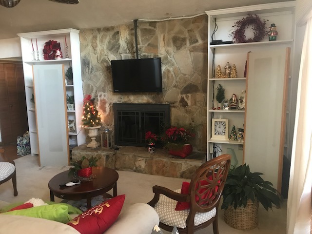

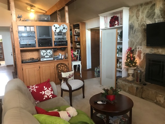

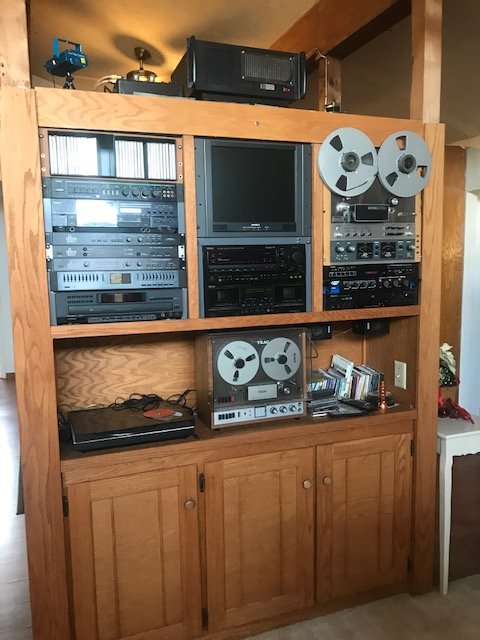

My audio system is in constant evolution, but I currently use an upgraded SCS 2600A to drive my Magnepan 2.5r speakers. I'm considering bi-amping the Maggies at some point, but trying to finish my FET preamp project at this time. You can see my upgraded and repackaged 2600A in the attached photos (On top center above the monitor.) Hope this helps.
