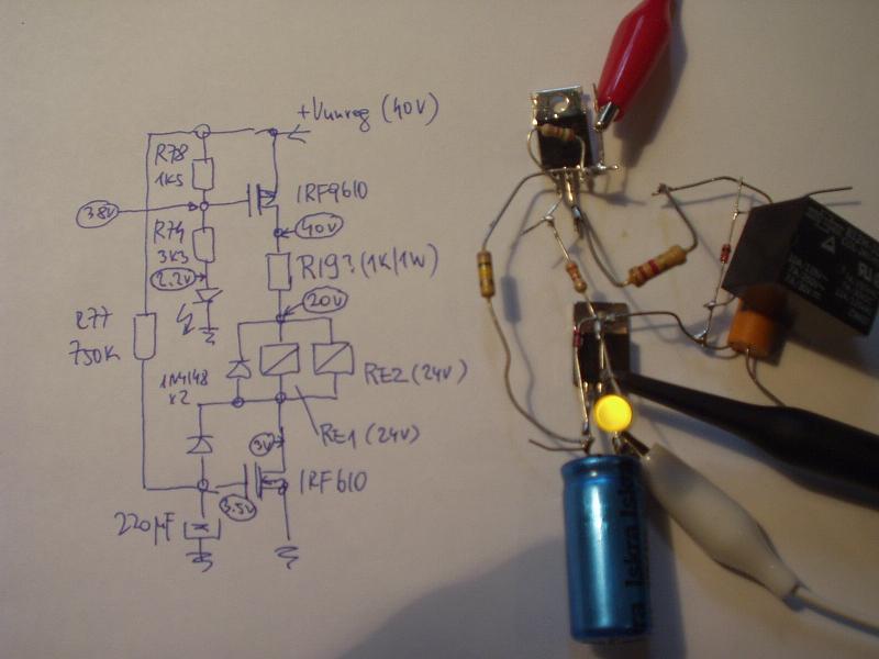

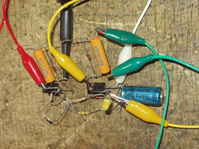

Hi all,
I make some experiments with this delay circuit, and results are interesting for me.
First, in service manual for preamp I don't see two delay circuit (only two relays) and my conclusion is that two relays are connected in series.
Second, I measure several 24V relays and resulting voltage are Von about 18V, Voff about 7V.
Third, Q25 (in my experiment 9630) start conduct when Vgs is about 3V, and this happened (if D is LED with Va-k-on about 2V) when Vcc is greater then 12V with value of R78 and R74 referred to service manual.
Where is fault? Q25 will switch off when Vcc drop at 12V. In this moment relays are already deenergised (or in same time) because Voff relays are about 7V (two in series, 14V). I try shortening Q25, and Voff (and time off) is same with and without. With this value of R78 and R74, Q25 is useless.:scratch:
I connect 1k resistor parallel to R78, then Voff of Q25 rise to about 24V, and then this circuit work fine.
Maybe elements in original design have slightly differ characteristics, but my theoretically and practically point of view is that this circuit need some revision. :scratch:
Regards
test circuit

OK, let's start from the scratch:
D? is a regular LED with Vak = 2.5 V. There are two relays in the circuit with nominal operating voltage Vr = 24V. (the original service manual says "Q25 and Q26 are used to power the mute relays. The front panel LED must function for Q25 to turn on and pull the mute relays off").
Bottom MOSFET is irrelevant because it functions as a short circuit when the circuit is powered off.
The circuit operates as follows: When the Vunreg starts dropping, relays voltage starts dropping as well until Vunreg drops below Voff=K*Vgs(th)+Vled, where K =(R78+R74)/R78, Vgs(th) = ca. 3V and Vled= ca. 2.5V. Then the MOSFET switches off relatively quickly (transfer function knee), which switches off the relays as well. In this case Voff = ca. 12V. However, by the time Vunreg drops below Voff=12V, the relays have already reached Vdrop-out value and deenergized. Switching off relays via MOSFET Q25 is therefore useless because they are already switched off, i.e. Q25 can be left out.
If we want to increase Voff(MOSFET), we need a lower value of R78 or a higher value of R74 or to increase Vled (by placing more LEDs in series or replacing them with a Zener diode).
In this case, if we want Q25 to switch off the relays when Vunreg drops below Voff = 30V, keeping 1 LED in the circuit and the value of R74=3.32k, we can calculate the value of R78 using the following formula: R78=Vgs(th)*R74/(Voff-Vd-Vgs), R78=3*3.32/(30-2,5-3)=ca 400ohm. If we take the standard value of R78=470ohm, we will get Voff=ca 27V. It would be possible to use a higher value of Voff but, since I don't know what's the value of Vripple on Vunreg, Voff=30V seems to be the best choice here.
If anyone finds a flaw in my method, I'd appreciate their comments and feedback. Also, I apologize if my post is too long and/or too boring.
Regards

Re: Re: delay circuit
TheMyxin said:
moamps said:
So it would be there nice if you could check that with this pre-resistor R19 and two Relais from one PCB-Supply and one regulation.
I'm not sure how look your pcb, and where you place R19. I made for you quick test and circuit below work just fine. If your schematic is differ, please put it here. My suggestion (revision) is changing R78 to 470ohm (q25 will switch off about 27V).
If you are trying this circuit before correcting error with direction of D11 (earlier posts), maybe is your Q25 burned. R77 can't be burned.
Regards

Go look at post number two in this thread. This is a relay driver with two transistors. How hard can it be to understand? One 24 V relay will handle the voltage the coil will see. Two of them would be in parallel if the schematic is correct. It shows one only channel and no coils in series are shown.
"Vunreg drops below Voff=12V, the relays have already reached Vdrop-out value and deenergized."
Gee..... the data sheet said the drop out voltage for the 24 volt relay is a minimum of 2.4 Volts. The voltage for a blue LED is 3.5 to 4 volts I believe.

OK, Dickmann,
so I didn't get your sarcasm. I'm just a B.Sc.E.E. and I don't get it when people get all metaphorical or whatnot on me (in a foreign language too) when I'm trying to discuss some serious issues. Reading your posts, it was only clear to me that you had no idea on how the thing works in practice (you also used to claim relays were 48V, remember?) so I truly thought you needed some 'straightening out'. Now I don't know why I even bothered as you can obviously think of no other argument besides Mr. Pass-knows-best mantra (with all due respect to Mr. Pass) that you keep repeating post after post.
"Gee..... the data sheet said the drop out voltage for the 24 volt relay is a minimum of 2.4 Volts. The voltage for a blue LED is 3.5 to 4 volts I believe."
Now, you could also benefit from reading data sheets more carefully as this one clearly says that the MINIMUM is 2.4V. I don't see it anywhere written what's the maximum. Do you? I'm telling you that IN PRACTICE Vdrop-out is about 7V for a 24V relay; blue LED doesn't change anything. Last time I checked, my instruments were working perfectly well.
Unless you can prove me wrong, I'll keep claiming that there is a flaw in the circuit design - Q25 switches off too late.

The data sheet is for the one Pass is using.
I will be glad to talk to you after you read the data sheet. It's a little hard to discuss theory when you don't have the data. You can write equations you want but plugging values for the variables in off the top of your head won't tell you much.
12V -3V is 9V which is a hell of lot more than 2.4 volts the top fet will mute the relays long before the 2.4 volt drop out voltage. I can hardly wait till will audio circuit..........

Referring to the schematic by Fred on the first page of this thread, there are a couple of comments which might shed some additional light on the circuit.
The diode from Gate to Drain of Q26 is there to prevent the Gate of Q26 from getting more positive that its rating, otherwise ultimately the Gate would be at the + rail value. When Q26 conducts, its Drain goes toward ground until it hits about +3 V,
at which point the current starts flowing through the diode.
Often this circuit has been implemented differently around Q25, where a supply regulator is being used. The Source of Q25 is attached to the positive unregulated supply, and the Gate is attached (through a resistor) to the regulated supply. When the difference between unregulated and regulated supply becomes less that the Vgs of Q25, the relay is shut down. This makes an excellent sensor which turns the relay off when there is no longer enough unregulated supply to hold regulation, the "off" condition corresponding nicely to this.

I guess that settles it?
I guess that means that it works as drawn....... imagine that! I suppose the threshold for Q25 turning off could be very easily set for a higher supply voltage with a smaller value for R78. That that seems to be a concern for a couple of people....... Also, I guess if one did not have as much supply voltage to play with that a 9 volt zener clamp gate to ground for Q26 instead of the gate to drain diode could get you another 3 volts to play with across the relay coil.
I think it is a very nice circuit for using left over mosfets from matching. Adapting for bipolars should be very easy too. Want not waste not. I can't understand the confusion over it once one knows the relay threshold voltages.
