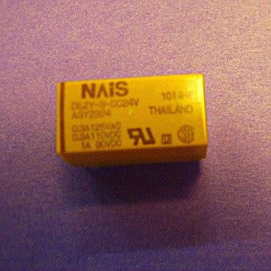

moamps said:
This isn't same. R78 and 74 and LED(?) make voltage divider (factor k) for sensing dropout of PS. Upper FET will very sharp switch off when PS drop below Vgs*k. With this voltage divider you can adjust that upper FET switch off at 30-35V, what is with your diode impossible.
Regards
Indeed. I stand corrected.
Jan Didden
Fred Dieckmann said:
24 volts..... I stand corrected by the gracious lady with all deference due. I am I right in assuming its a 2 form c?
And I think the 24 V relays are quite common as I could not remember ever seing a 48 V one in my catalogues. For instance http://www.elfa.se/ seem to have some 80 different relays using 24 VDC but only 3 that use 48 VDC (which I did not know about). As a matter of fact I thought 5, 12 and 24 was standard issue and 48 V was the exception in the everyman supply chain.
