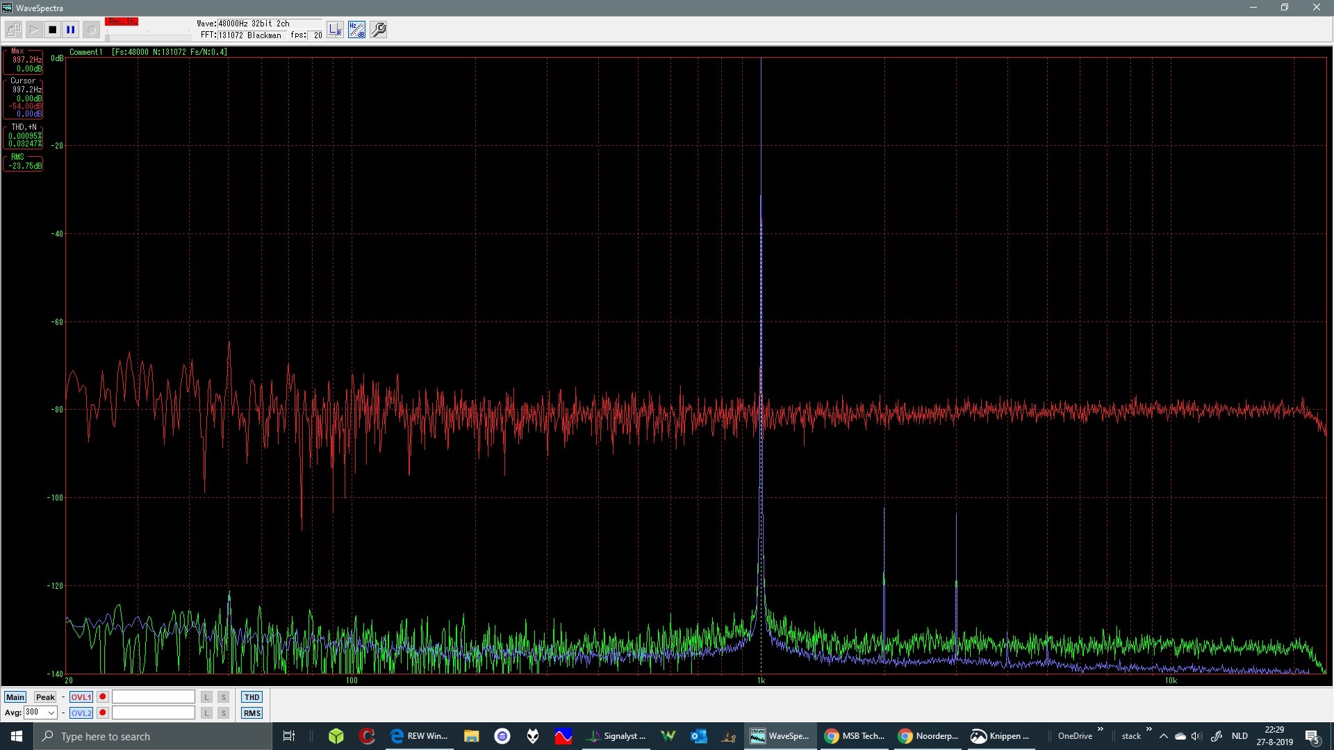

HQPlayer has many filters and modulators to process musical data. My best experience has been with a Twisted Pear Chronus together with a Beaglebone and Botic driver.
It is really easy to pick out the differences between the modulators. I've measured them many times, noise, thd etc can differ a little bit, but the SQ ranges from thicker, noisier, more laid back, to a thinner sound, more clean, more detail brought up front etc.
I am guessing the 2nd gen Sony's had just a lot better processing (dither etc.as mentioned here before), the power supply had incorporated a few more years experience, as well as the output stage. We'll never know for sure unless we change these parts with 1st gen parts, or one is sure the only difference between 1st gen and 2nd gen was the processor on the pcb.

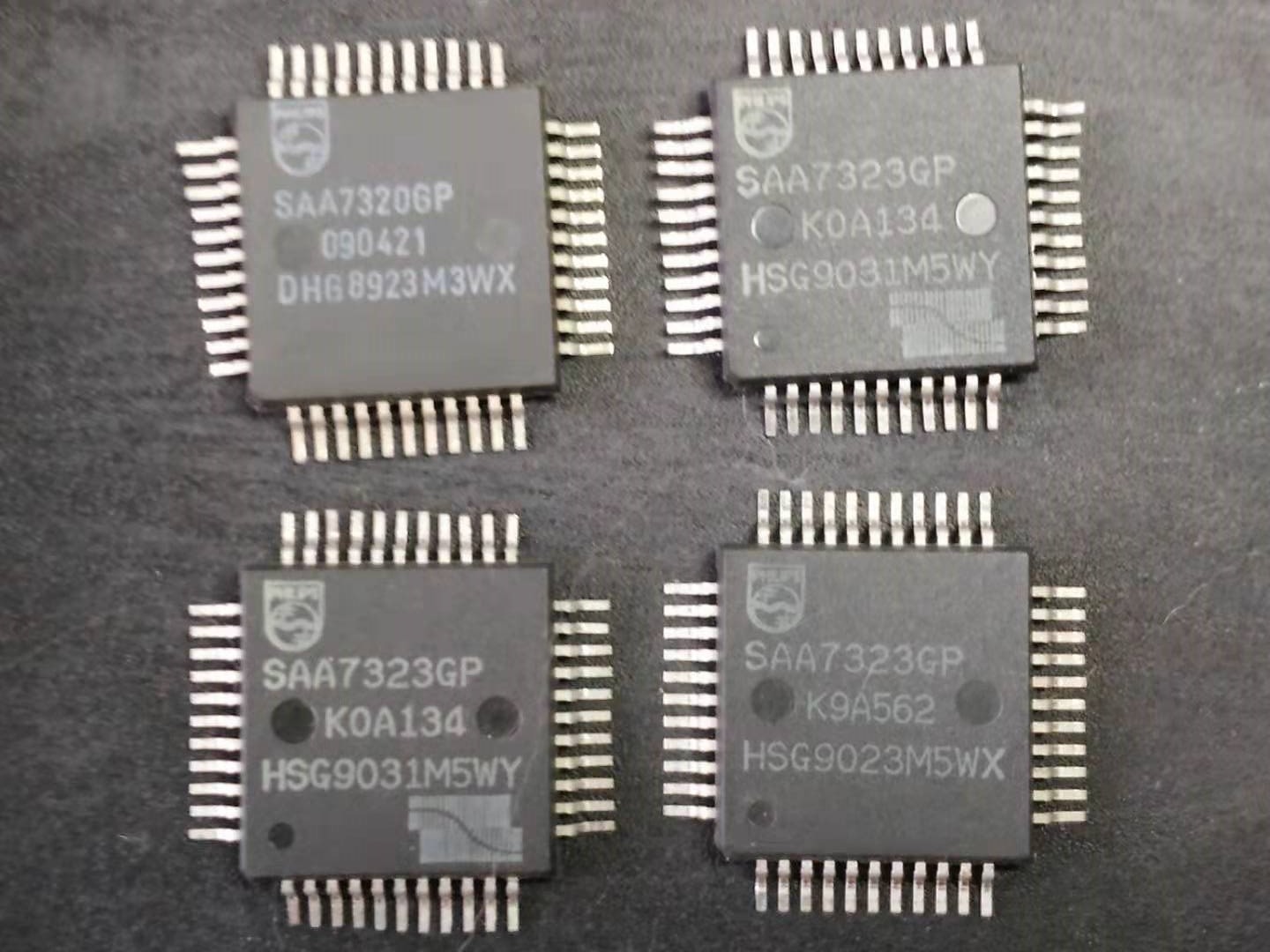

First gen Bitstream was SAA7320 and that indeed was 256fs. But TDA1547 was designed for use (originally) with SAA7350 which uses a 3rd order modulator (SAA7320 being 2nd order) so it wasn't necessary to have such high levels of OS.In that video he talks about Bitstream being 256fs. Afaik the TDA1547 could only manage 192fs.
Either he is wrong, I am mistaken or he based his experience on something else than 1st gen Philips Bitstream players.
There is also a SAA7321, but I hardly find any information about it.
Indeed after 7321 there was 7323, I still have a few samples in my box, albeit with bent leads after so many years.
