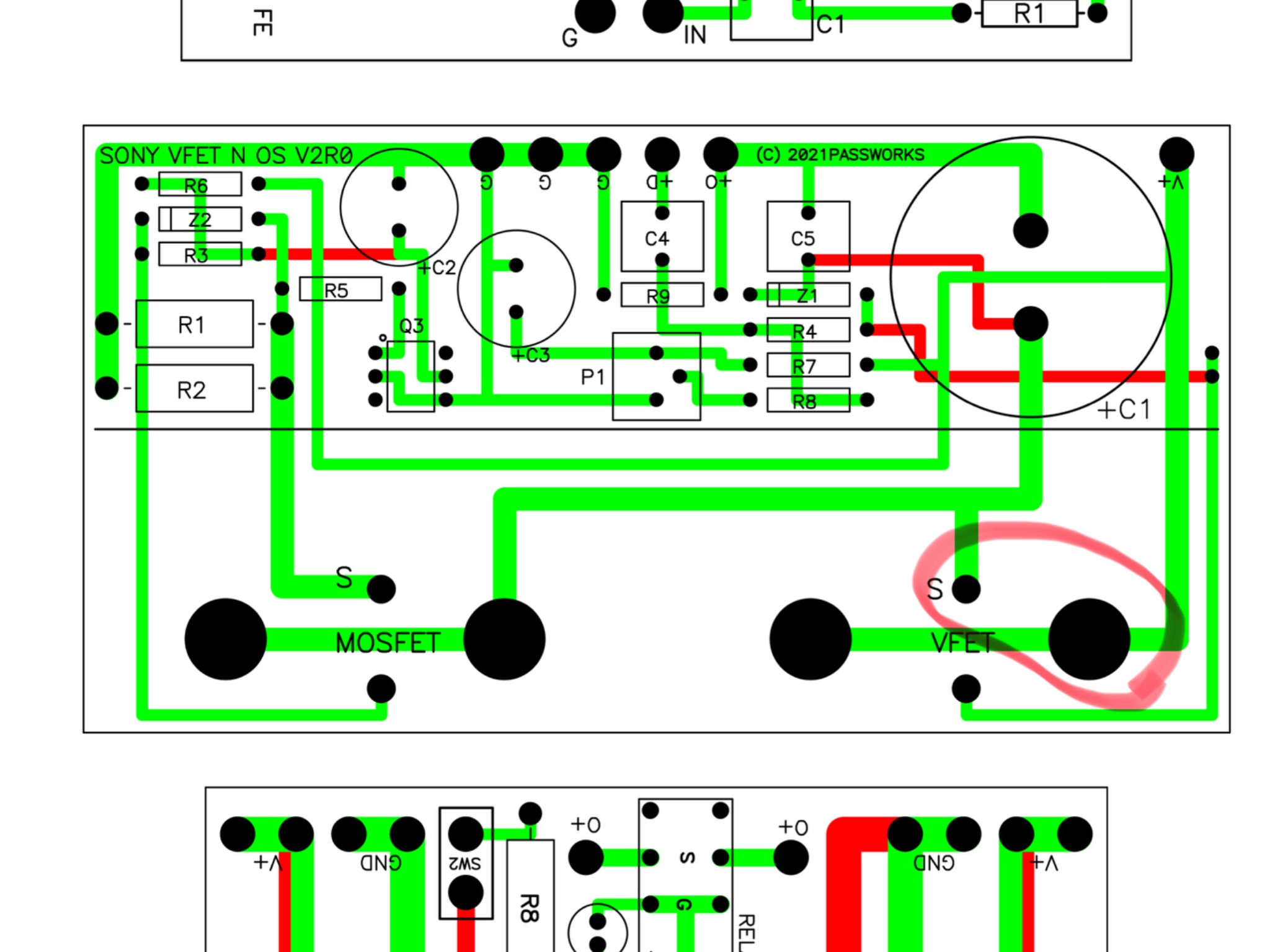

Is it possible to use 20V Zener or should I order 18V
And what could be the reason for this to happen in the first place, power spikes from supply

Hi
I change the two zener and the opto, still no power draw.

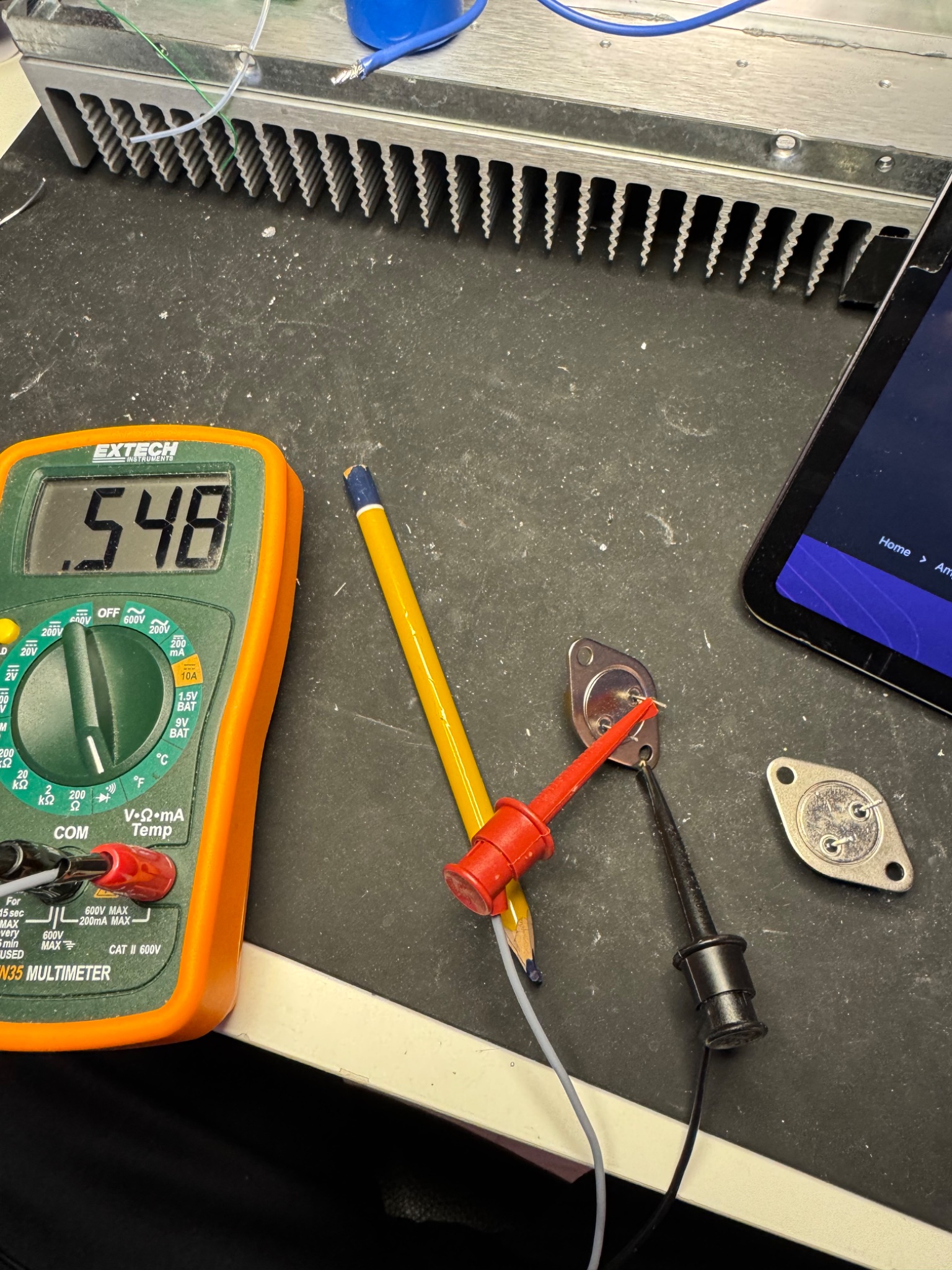

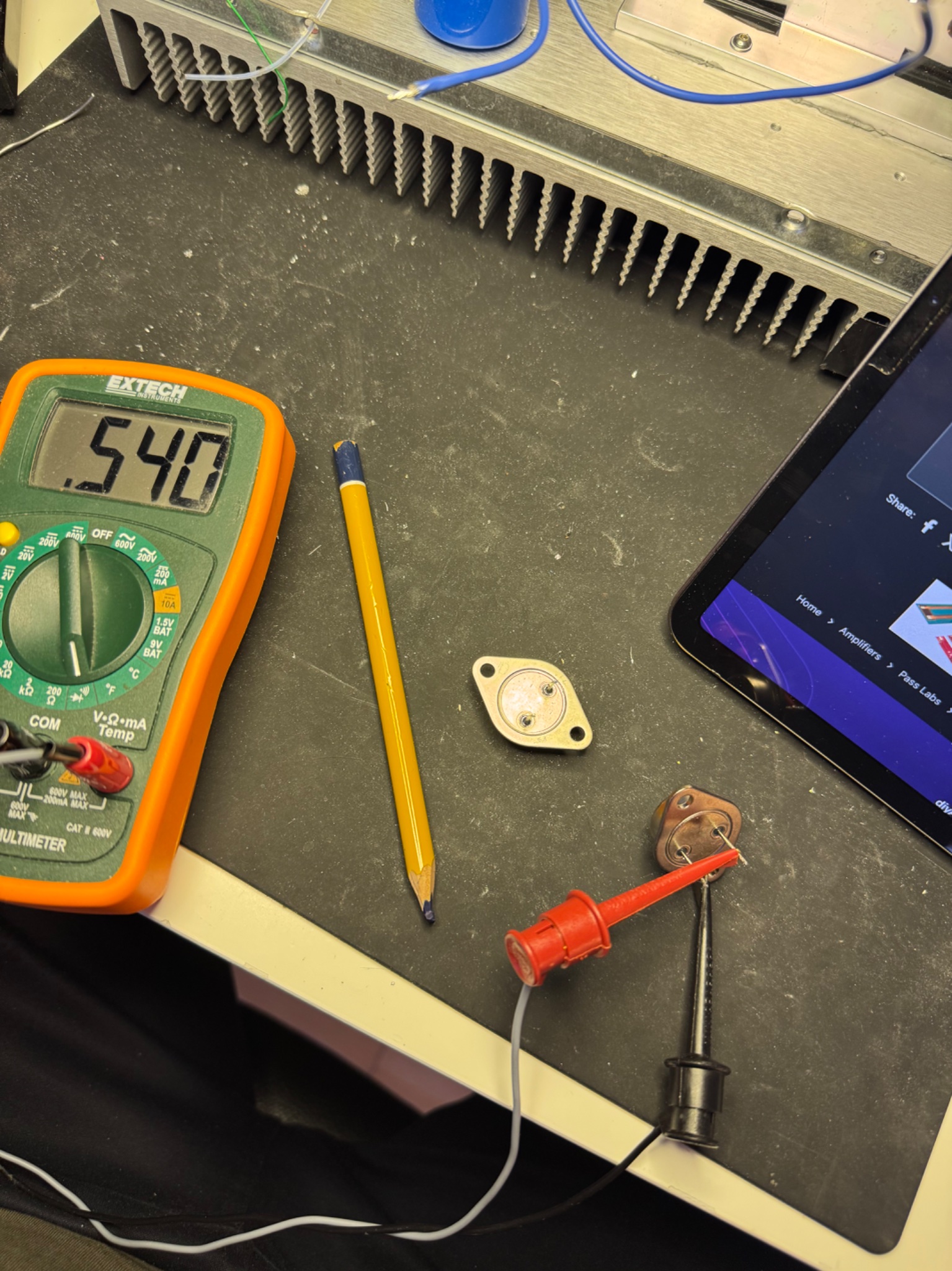

Did som noob measurement, between case (IRF250)and + on the good side it’s a short, on the bad side it’s 60Kohm
Between case/nut (Vfet) and marked S on schematic, short on good side, on bad side ≈40Kohm

remove screws, inspect, clean if needed, put screws back, check with DMM
inform here, pics if possible
