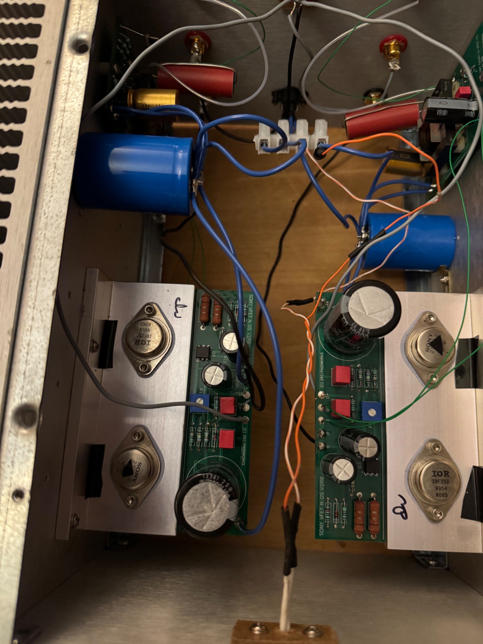

Sony vFET pt2 N channel help
in a meantime, read this, hoping it'll give you some insight in possible culprit
(check both zener diodes, too)
Hi
I change the two zener and the opto, still no power draw.
Did som noob measurement, between case (IRF250)and + on the good side it’s a short, on the bad side it’s 60Kohm
Between case/nut (Vfet) and marked S on schematic, short on good side, on bad side ≈40Kohm
Andreas

Hi
I measured between S and D on bad one, there is nothing, on the good one it’s a short
And measure between D and G and both shows the same, se picture. Bad one to the left.
It’s toast right?
