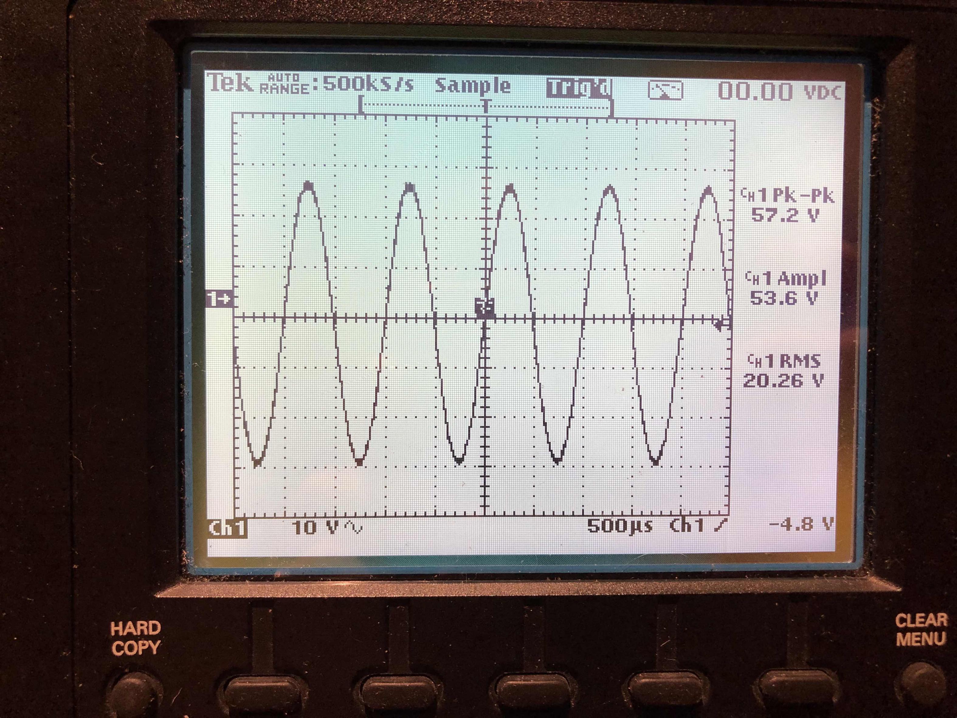

I got around to measuring the bridged Vfet output. I used a 1 KHz tone played from the computer to the network streamer, into the DAC and preamp.
I used an oscilloscope that has isolated channels and a 8.2 ohms measured dummy load.
In order to simulate how much power is output from the Vfet with normal volume, I first set the preamp attenuation to my preferred listening volume. With that setting, I had an RMS voltage of 0.374 mV. If my calculations are correct, that comes out to only about 0.017 W?
I would expect it to be much higher.
When I repeated the same measurements with the preamp attenuation to the minimum (max volume) I had an RMS voltage of 20.26 V, which gives an output of 50 W, without seeing any clipping on the oscilloscope.
Did I mess something up in my measurements or calculations?

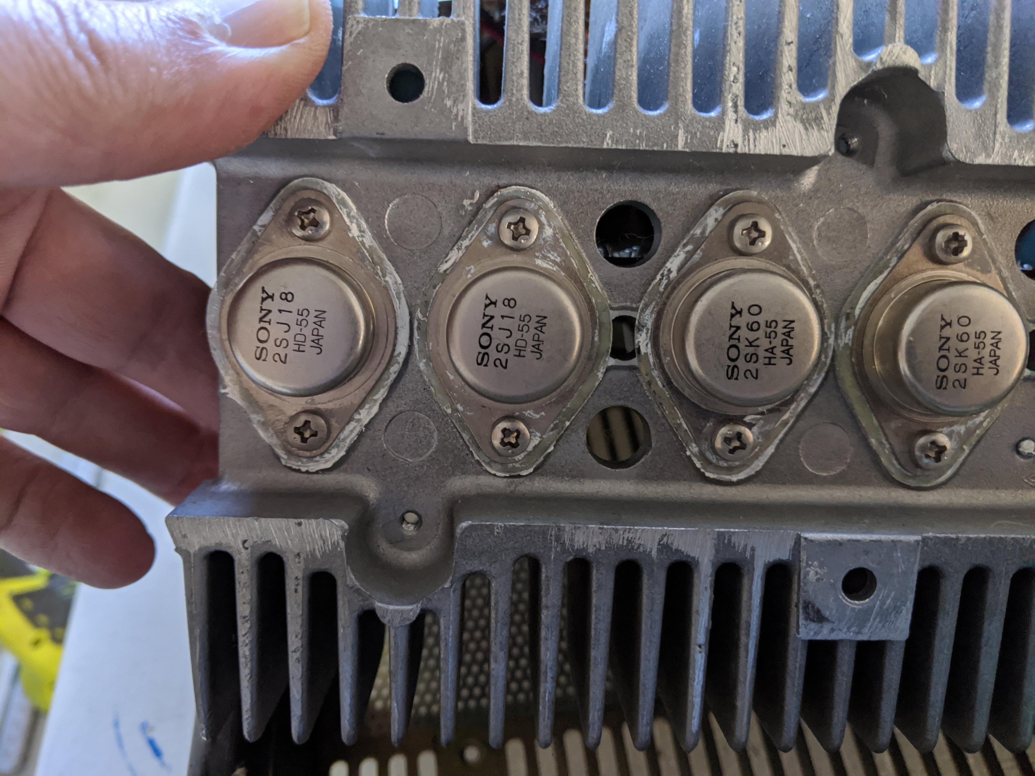

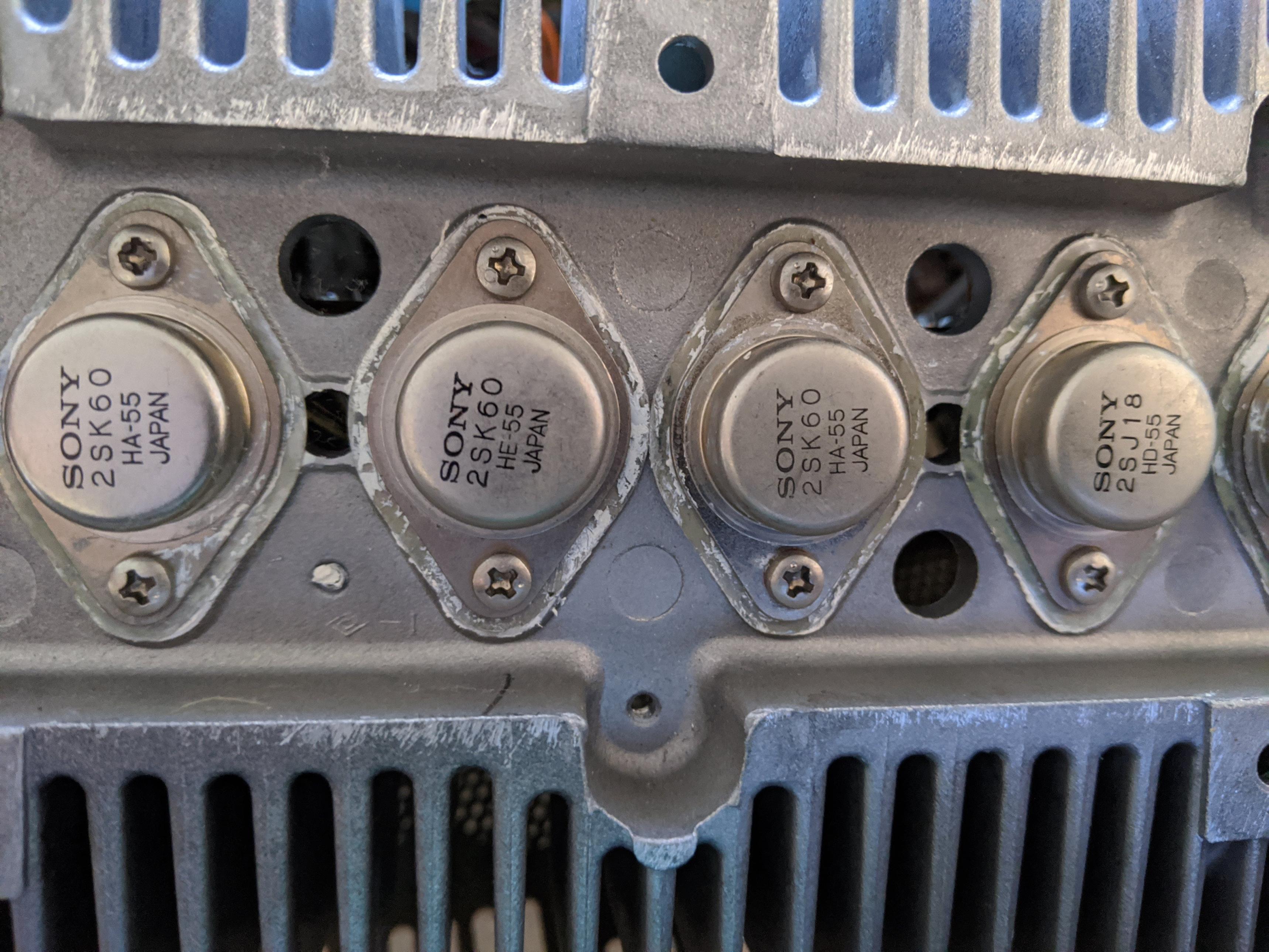

I received a different 5650, which was in working condition. I opened it up and everything looked clean. I opened it up to check the v-fets and they all ranked 55, but the only thing that seems odd is that there are 3 2SJ18 and 4 2SK60, I attached images of them. So they have not matched pairs, would this make a difference?

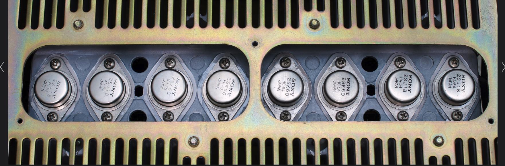

Here's a picture of what they should look like.I received a different 5650, which was in working condition. I opened it up and everything looked clean. I opened it up to check the v-fets and they all ranked 55, but the only thing that seems odd is that there are 3 2SJ18 and 4 2SK60, I attached images of them. So they have not matched pairs, would this make a difference?
I would surmise your unit might be working on single pair per channel. You should not operate it until you have bias checked and unit inspected.
