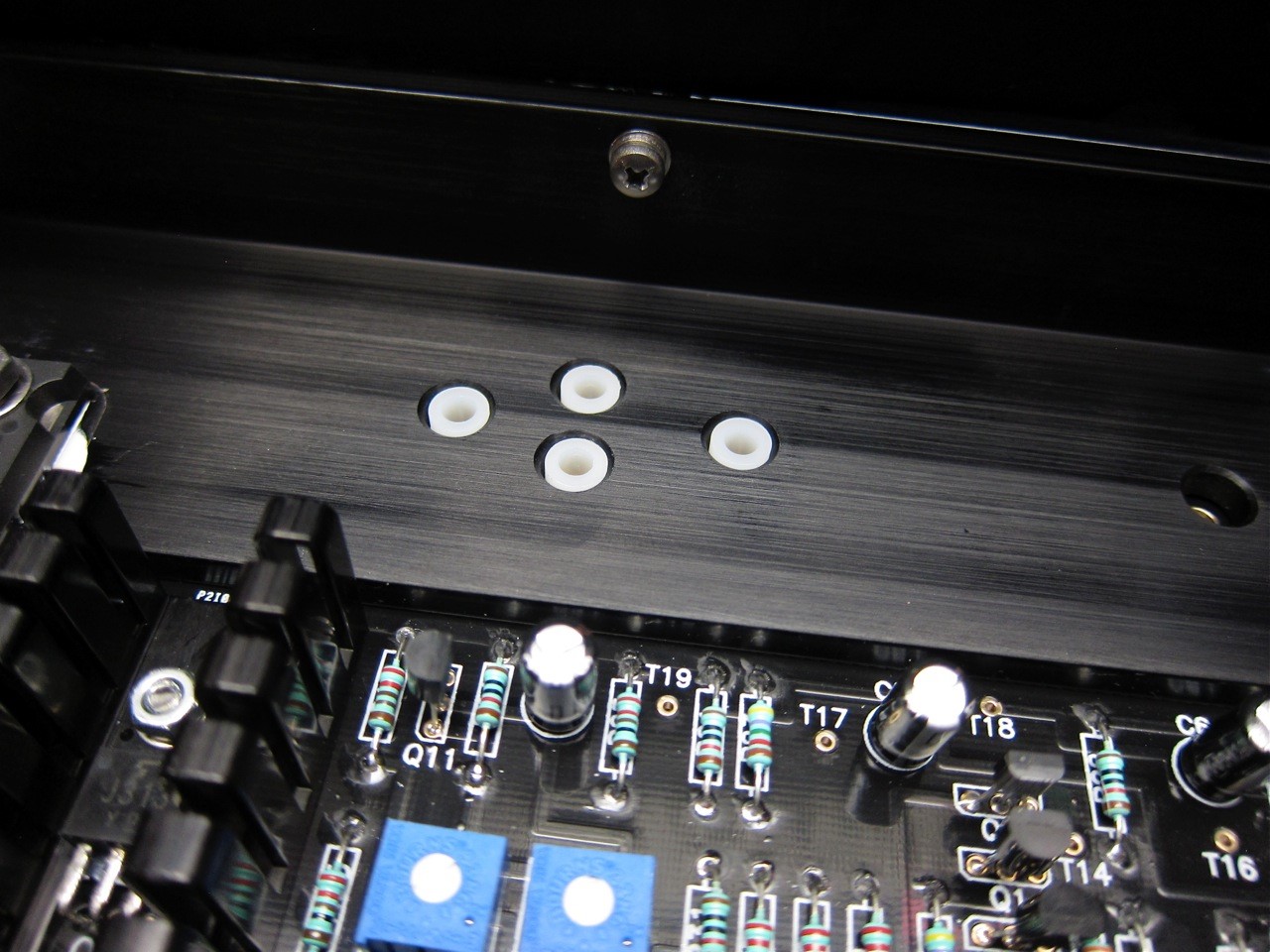

small white TO-3 insulators
Hi Jim
Thanks alot for the build guide - it has really been a great help to me. I have now managed to bias up the front end Mossfets and adjusted the DC offset (G - T18). The amplifier has been running stable for a couple of hours now.
I am now about to install the VFETS but have one doubt. The VFET essential package from diyaudiostore only contained 8 PC's of the small white insulaters - I noticed that even the picture from when I ordered the essential kit also only show 8 pcs. In your build guide it seems 16 pcs are needed (4 insulators per VFET). Can I get along with only 8 insulators or do I need to order additional insulators?
Thanks again - your help is really appreciated
Best Regards
Rolle
Hi Jim
Best Regards
Rolle
I didn't build mine from the Kit...
With only 8, I'd use the spacers on the holes with the screws to help align everything.
The pins could be insulated with a bit of wire insulation from stripped ends, small bits of heat shrink, teflon tubing, or something similar. If everything is lined up properly the pins shouldn't touch the metal holes of the T-bar, but having something on the pins would be good insurance.
