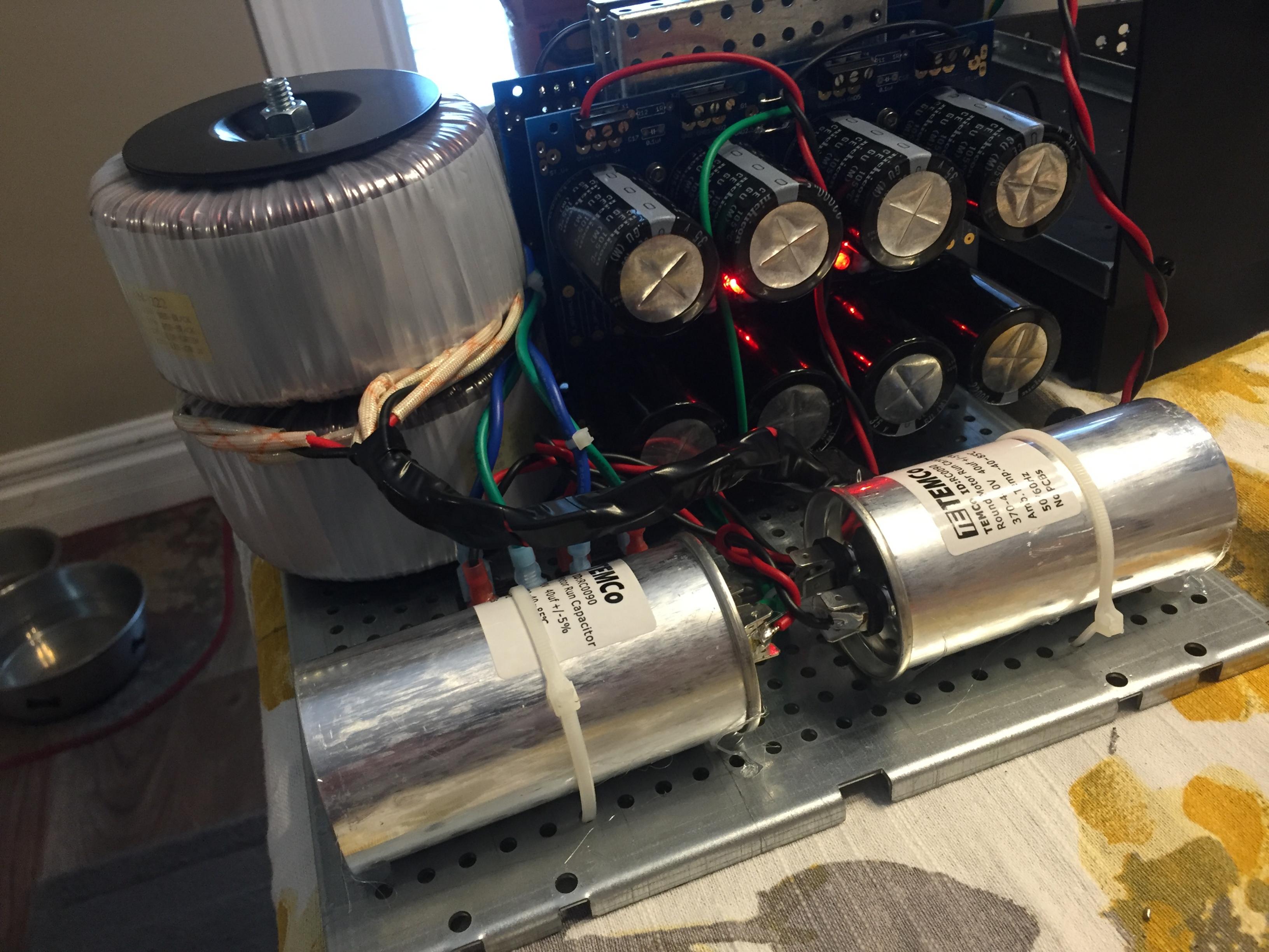

Is that 4 x 12,000uf + 2 motor run caps per channel ?
Cantilope gave his blessing for me to answer for him. I am pretty sure he is using 60K uf per rail plus one 40uf MR. That's 4 15K uf per rail, 8 per channel. A serious PS.
That's quite a number of caps to fit into one box.

He is building dual power supplies. I built mine with one PS section but split the rails using 2 resistors and 2 extra caps along with MR caps per F6 BAF talk. A compromise but it should help. Page 15.
http://www.firstwatt.com/pdf/art_f6_baf.pdf
Mr Pass used 3 caps per rail making 4 rails. I used 4 caps instead of 3 and then installed a MR cap. This is commonly done on tube PS sections for better channel separation, splitting the last stage into two using a resistor to separate the channels some and another cap.
