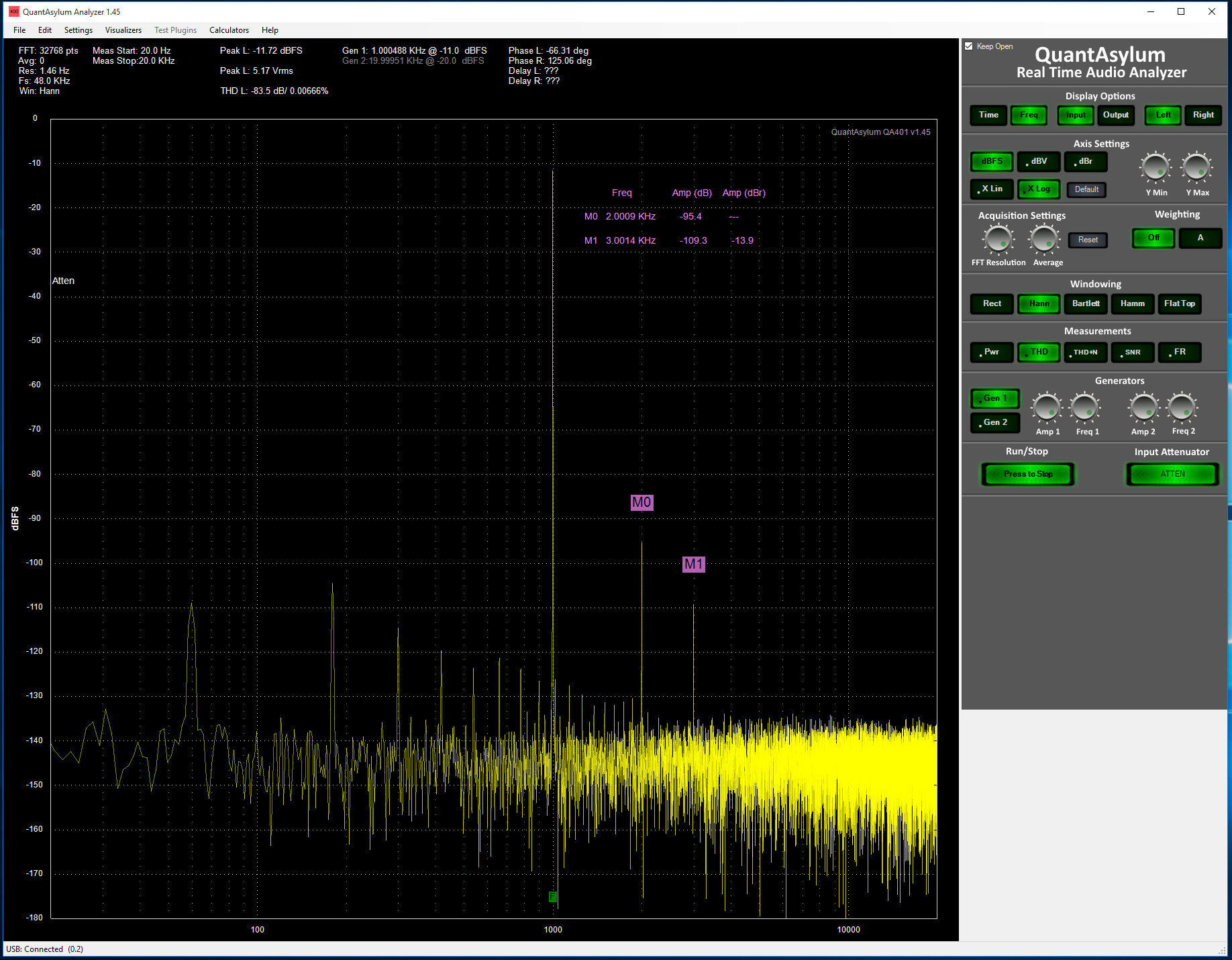

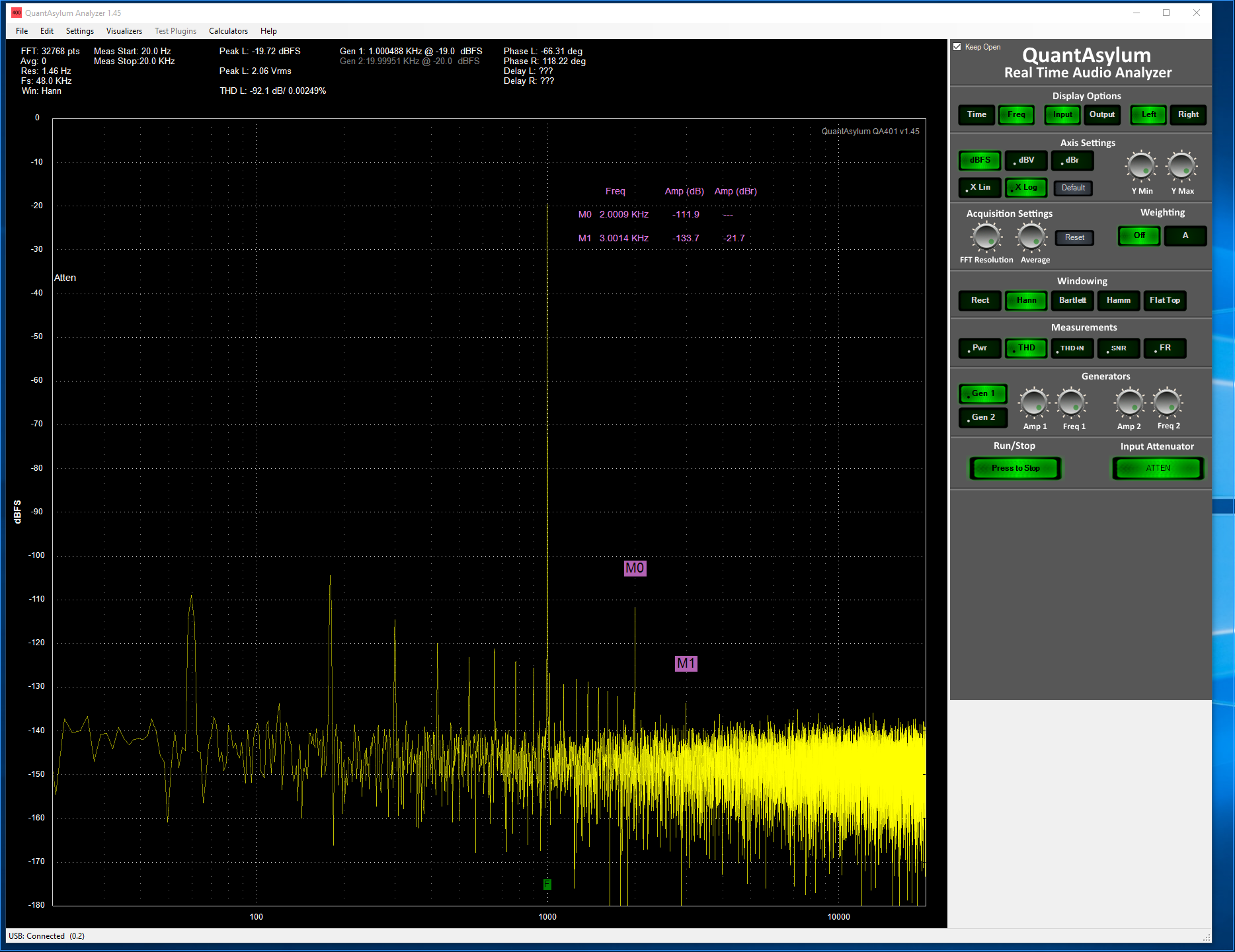

Sony vFET Amplifier Part 2
.. and with feedback
