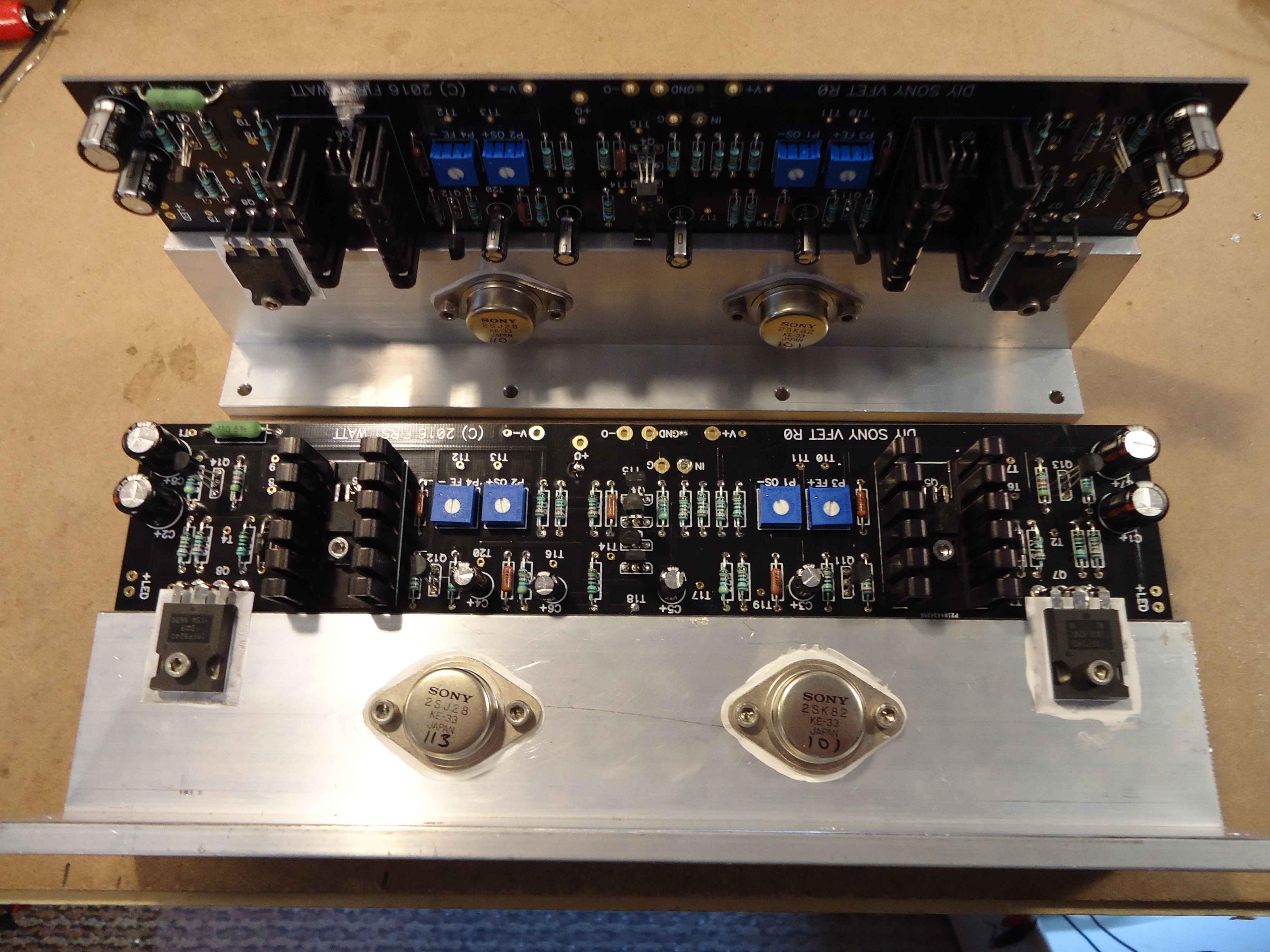

Here's an update:
The DIY versions of the circuit boards are here and will be tested for errors
later today. Also I am working up the test procedures for DIYers to check
their work during the process of assembly (don't want to lose any of those
VFETs).
The samples of the brackets contained errors which are being corrected, but
I am using my own samples to do the work.
6L6 is being provided with the materials he needs to get one of his
construction guides together for this.
400 pair of VFETs have been tested.
Shouldn't be long now.
:cool:
The one and only
Joined 2001
2 hours later...
It appears to be fine.
:cool:
