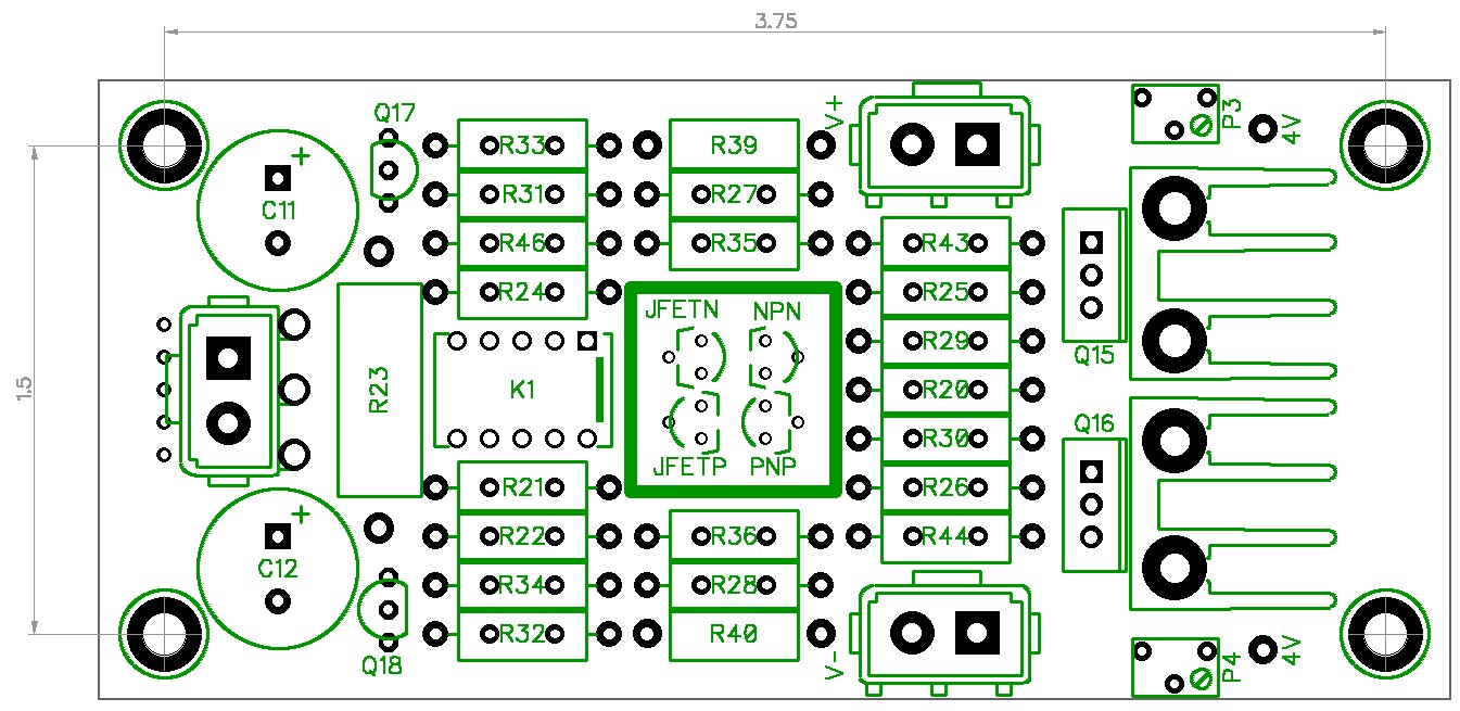

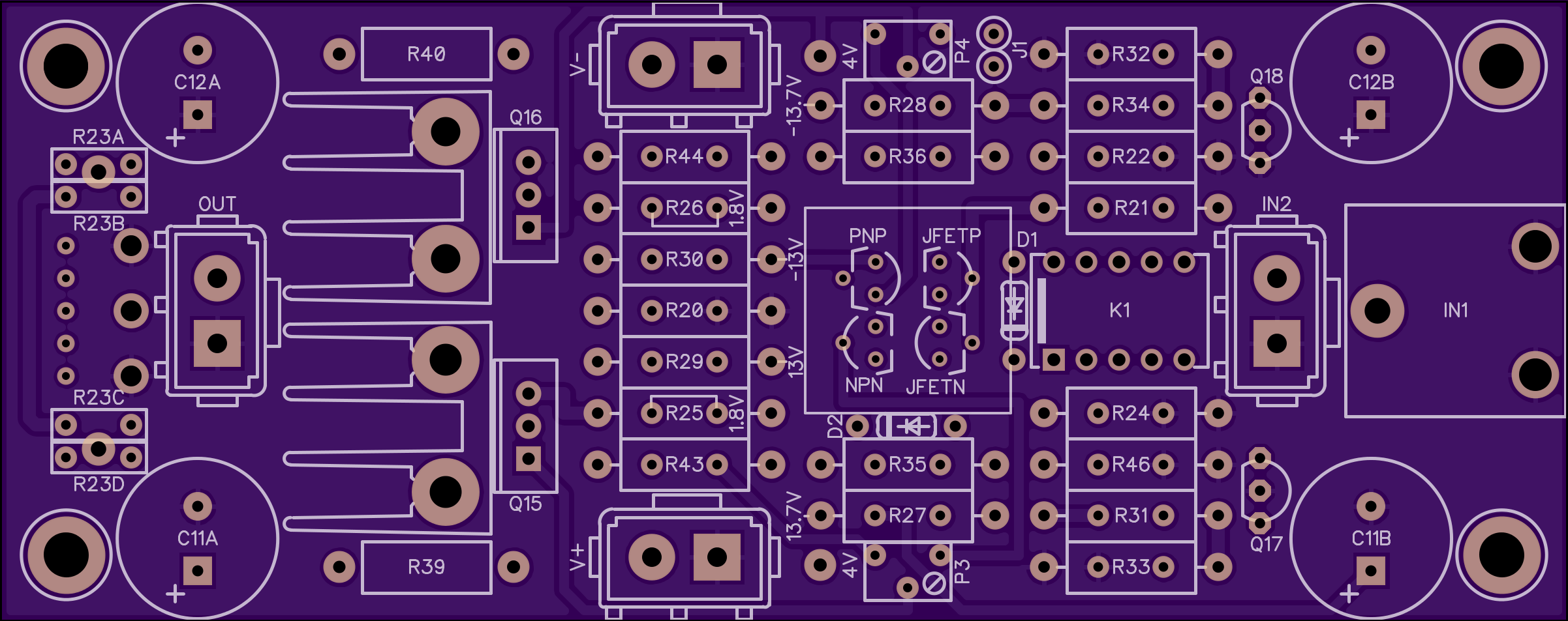

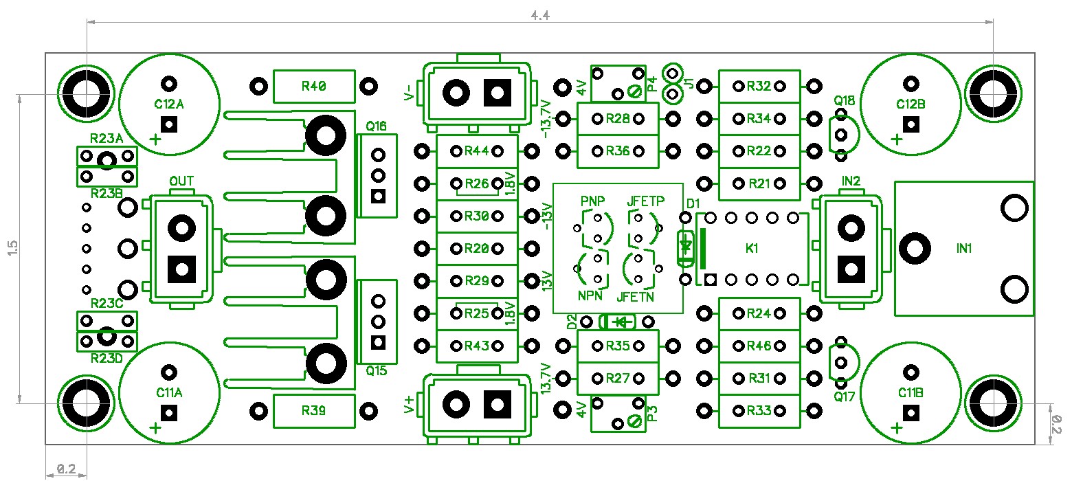

Here's where I am at with the combo output stage:
...just a small question luvdunhill,
- Different values for source resistors on output is your effort for tighter matching ?
Carlos
...just two small questions luvdunhill,
1- Different values for source resistors on output is your effort for tighter matching ?
2 - How long is main board ?....i am halfway to building a chassis and was counting on two pairs a side so now i am hopping this still fits.
Carlos
I am allowing for source resistors, they aren't present on the official VFET2 schematic. They will need to be jumpered with a bit of wire if not used. The article says they aren't needed and the lack causes some nice benefits, but with the extra device (3 deep) it seemed wise. I am open to removing them, but definitely wanted a prototype board to have the option.
All my posts should have dimensions on them - the width is on this very page.
Finally getting this project off the ground. Thanks to Botte and Flocchini for their help in building this project, and La Ode for the board layout.

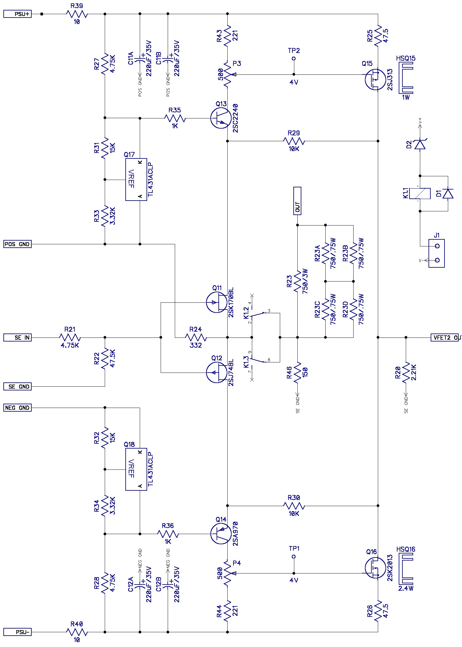

Here's the VFET2 Front End. I'm trying a different board house for this than the output stage (PCB Way versus Elecrow). Just put the order in for the front-end and the output stage already shipped from PCB Way.
