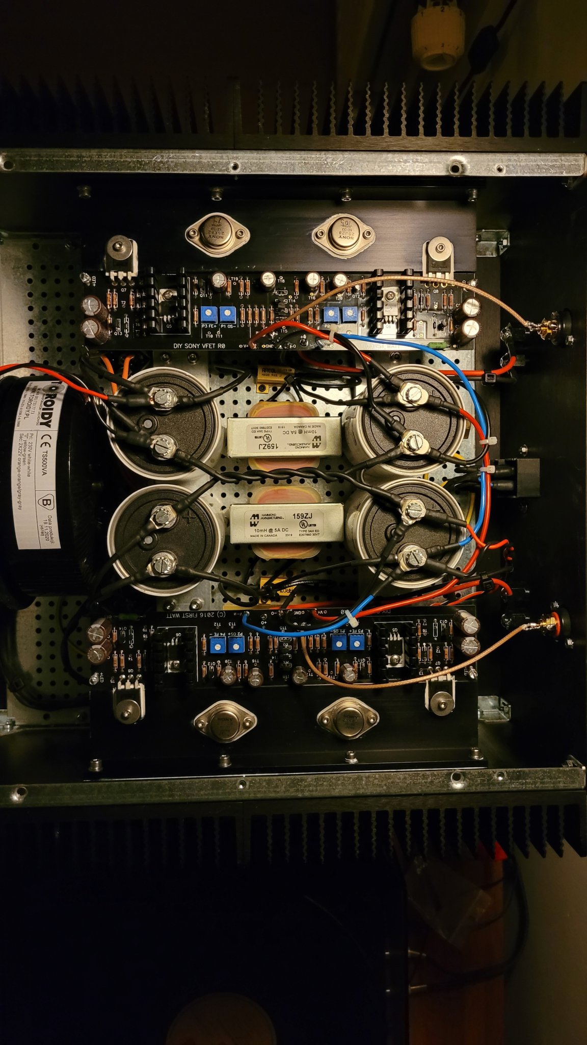

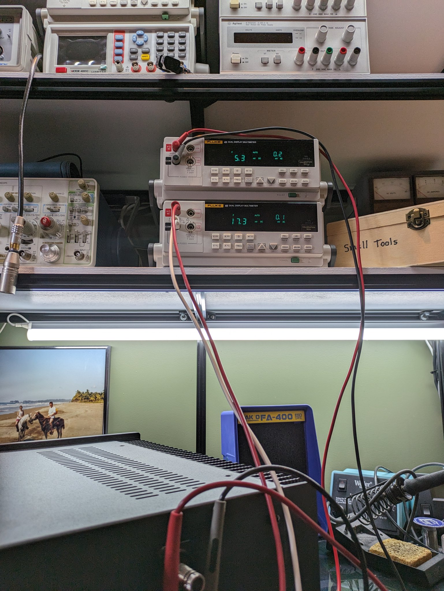

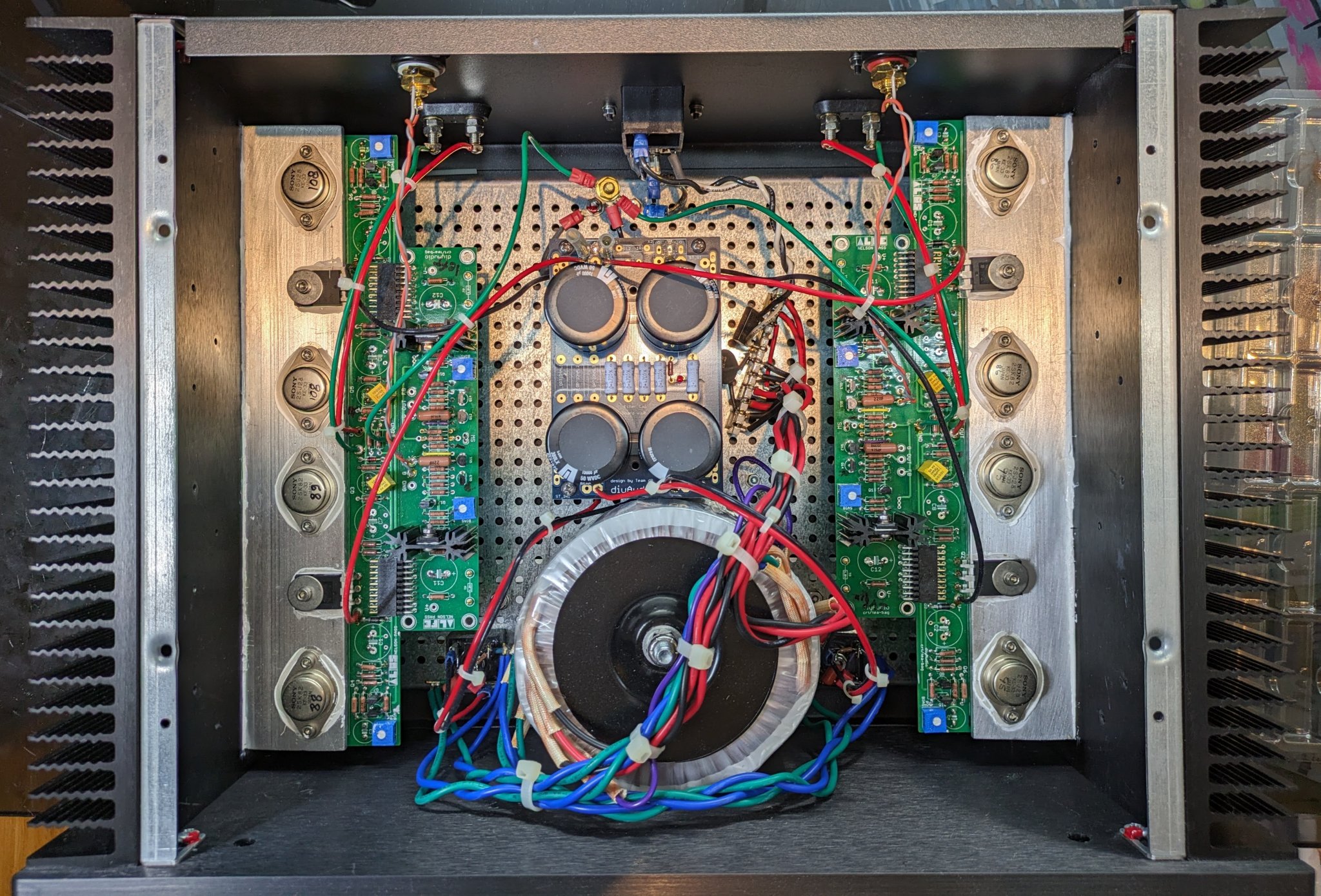

After a long time first collecting parts and then building with no rush, I finished this amp - finally. It sounds absolutely wonderful.
So, thanks a million to Papa for an exiting project and an easy to understand adjustment procedure, and to 6L6 for a great build guide with all the comments. Thank you.
I re-adjusted the front end after the Vfets were installed (with enough multi-meters and patience) as I was not happy with the T18 voltage. In one channel it was around 2 volts, with the feedback loop operating. These are my numbers now:
I have one question: The R32 voltage drop (bias current) is rock stable, when the amp is hot. At power on it shortly raises to around 130mV for a couple of seconds, but it drops rapidly as the bias circuit wakes fully up. After less than a minute it is below 105mV. As the amp heats up it steadily settles in at 100mV, but it takes 15-20 minutes. Is this too long running at the slightly elevated current 100-105mV - so I should bias lower, or is there enough margin with the VFETs?
No worry there at all. Just as a matter of comparison, the same parts in the single-ended Sony vfet amps run at similar Vds voltages but at 1.6A.
Enjoy your amp.
Enjoy your amp.
LOL. Very kind of you. Okay, I will pop the hood and take and post a few shots when I am back home in a couple days.

Thanks. I think this is my best power amp yet (counting 2 commercial and 2 DIY). Cool that you did the brackets yourself PierreQuiRoule, please share more pictures when you have time 🙂. I took the easy Modushop solution with finished brackets.

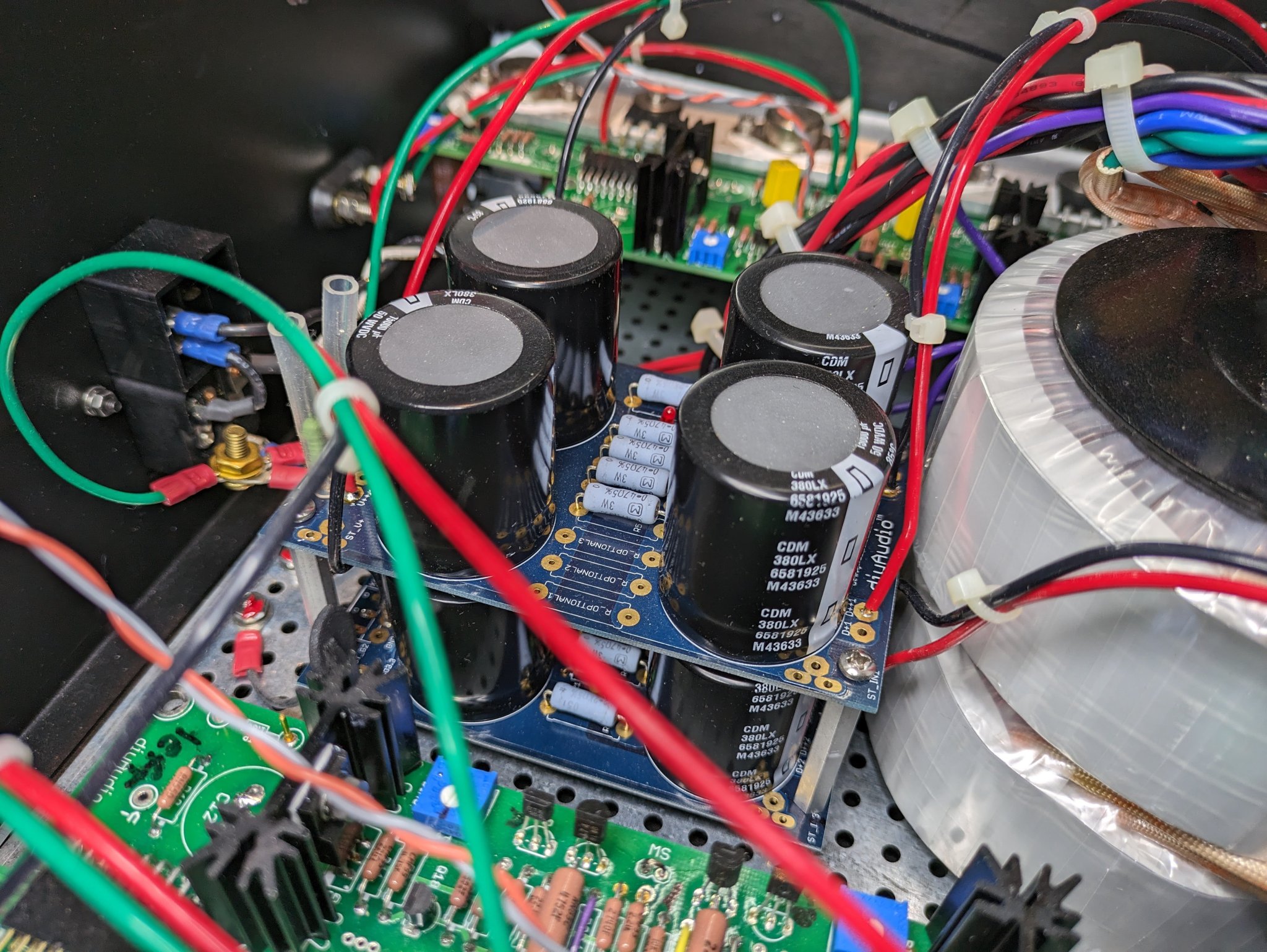

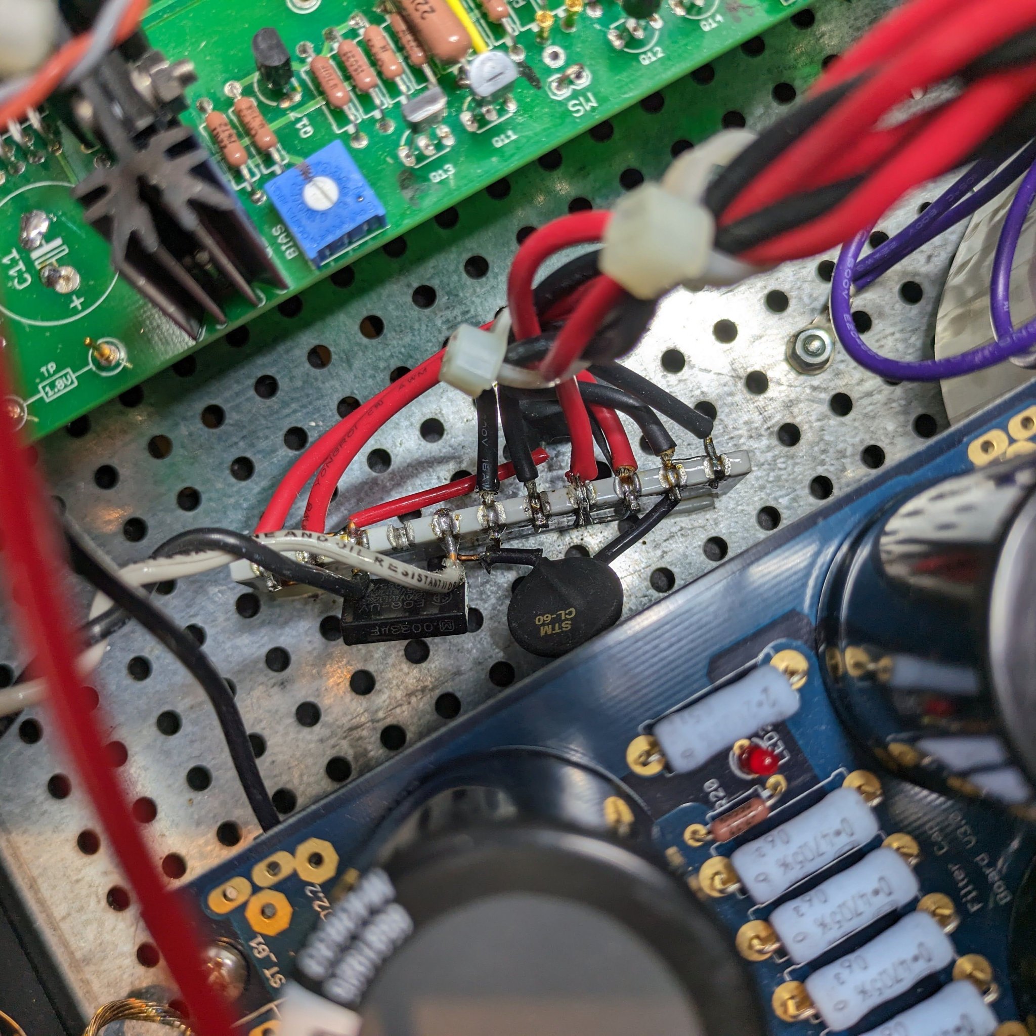

Mine is build with C-R-L-C power supply, the extra R is to improve the impulse response to disturbances. The front plate is inspired by the single ended diyaudio VFET chassis. Here are a few pictures:

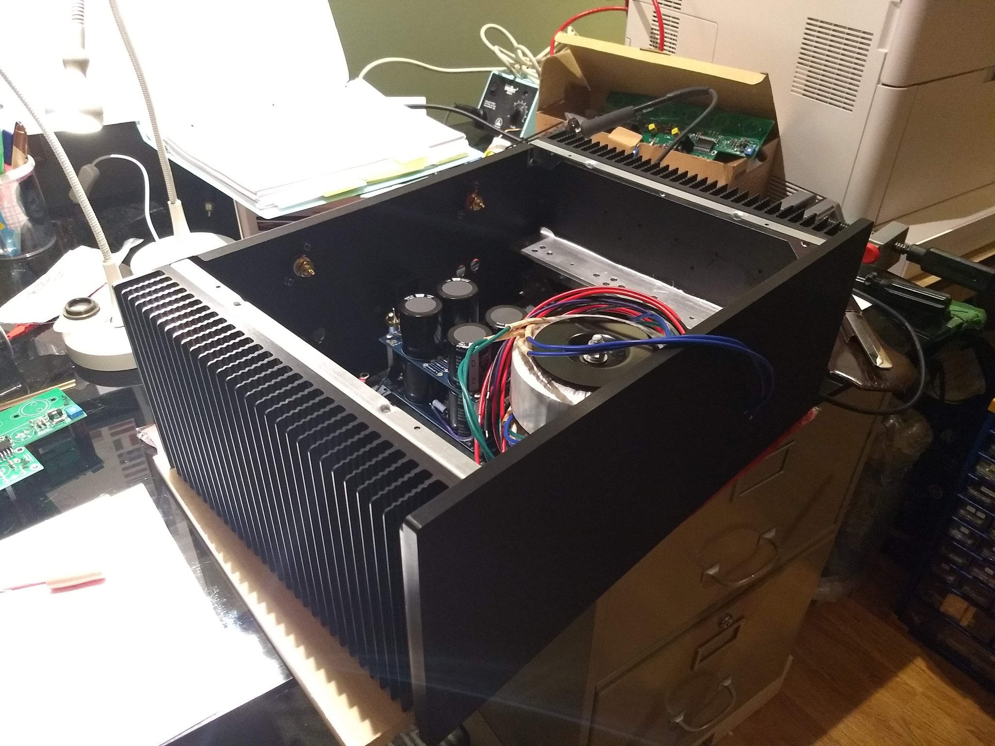

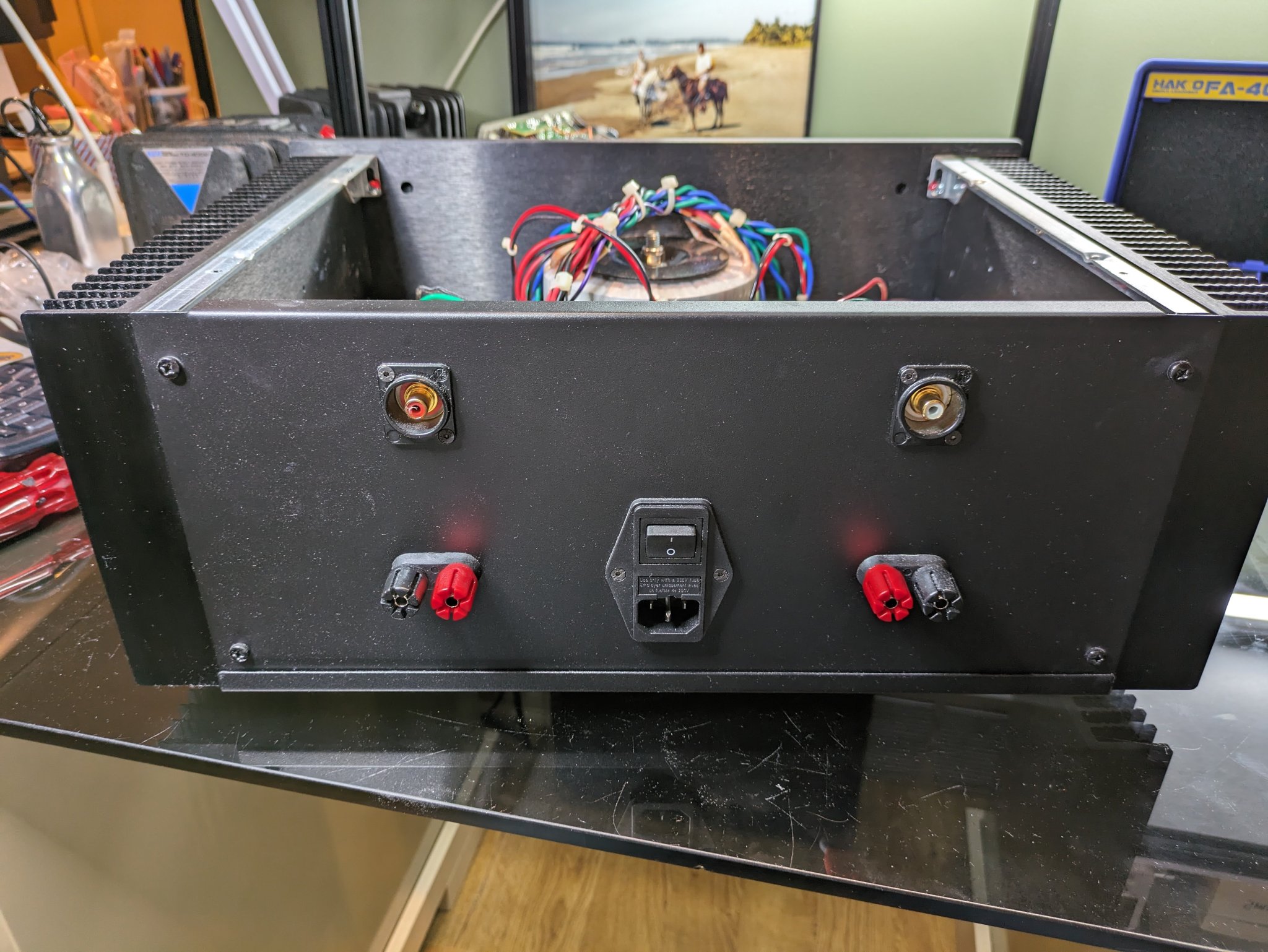

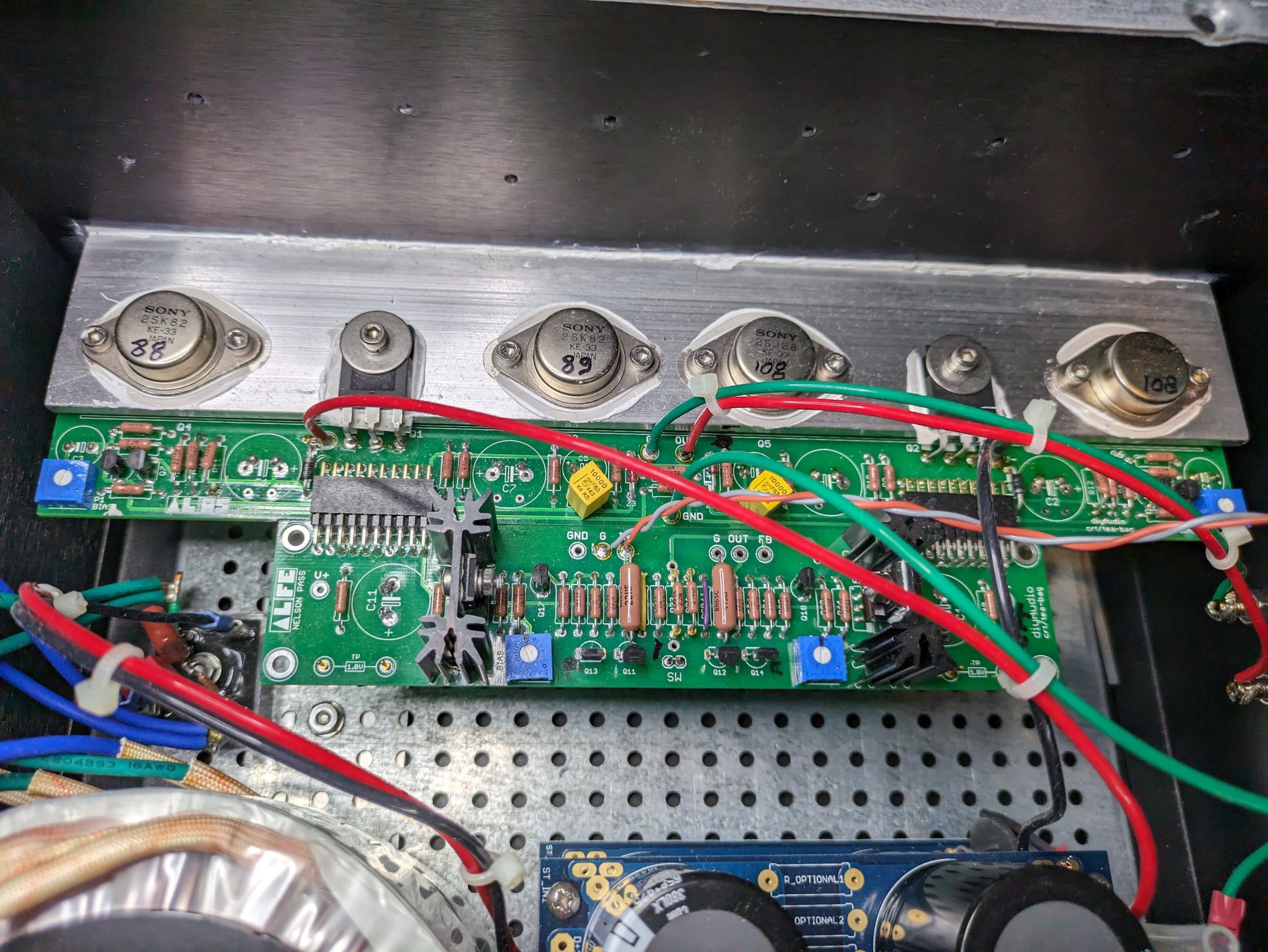

The construction of the Push-Pull VFET amp is straightforward but took me a while. Working with irreplaceable VFETs incites slow, cautious assembly and testing. I followed the original design published by Mr. Pass in 2015, using four VFETs per channel, delivering 20 watts into 8 ohms and 40 watts into 4 ohms. PCBs are from a 2018 group buy "GB Pass SONY VFET Version 2 - AL Boards" by @Tea-Bag.
Aspiring builders should note that Mr. Pass revised some resistor values after the original article. In his post on 2015-08-11 9:49 pm he writes:

Readers will recognize the Modushop 4U Deluxe chassis with steel covers. The chassis was tight and I chose to stack two smaller 22VAC Antek transformers to trade width for height. One transformer generates the positive supply, the other the negative one, and each channel gets its dedicated CRC filtering board. If I were to do it again I would use a single transformer to reduce wiring. Drilling holes in the L brackets took a while.

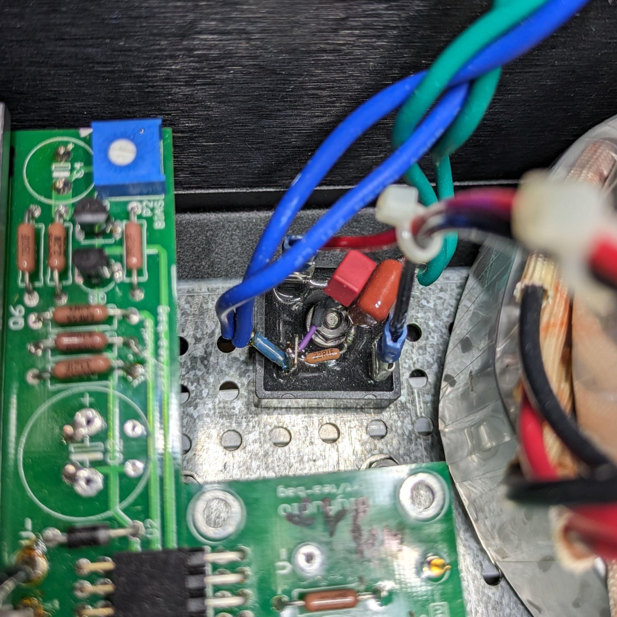

Tip: Transparent silicone tubing can be cut to desired length to make insulators for TO-3 pins and mounting bolts. Size 4mm x 6 mm (internal diameter x outer diameter) is readily available online, cheap, and fits perfectly.
As recommended, I adjusted bias and DC offset after warmup. To be on the safe side, I set bias current to 1A which worked fine in a 4U size chassis.
