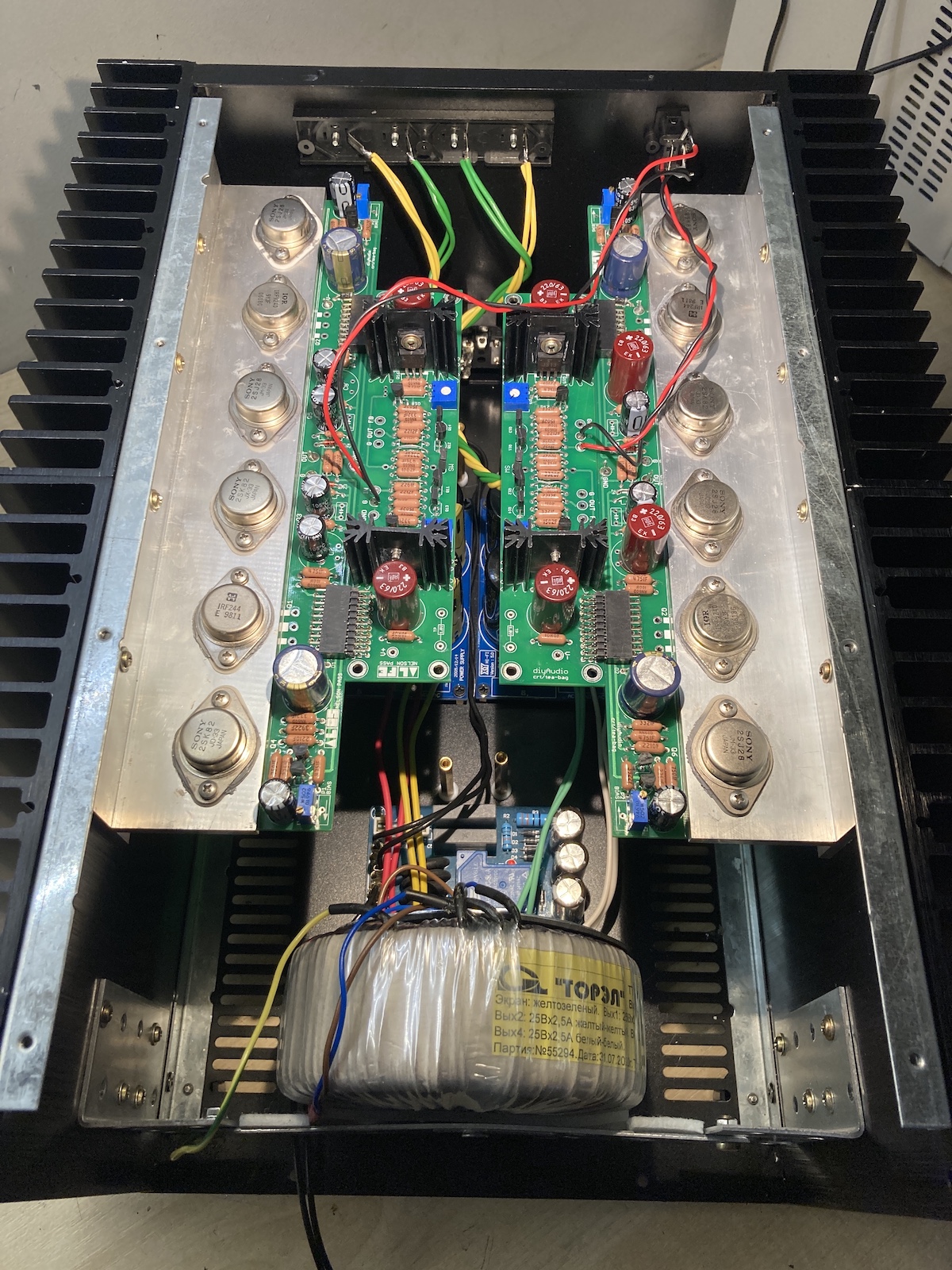

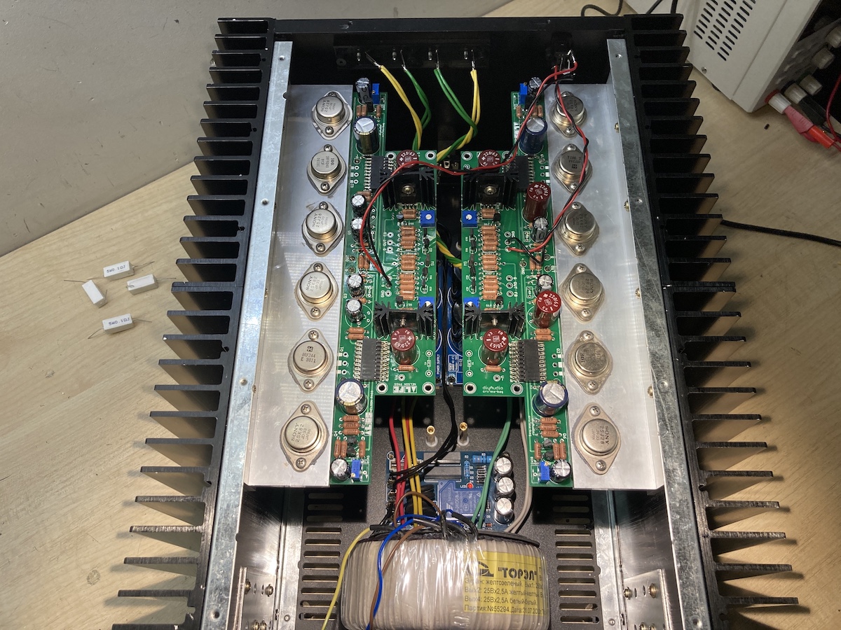

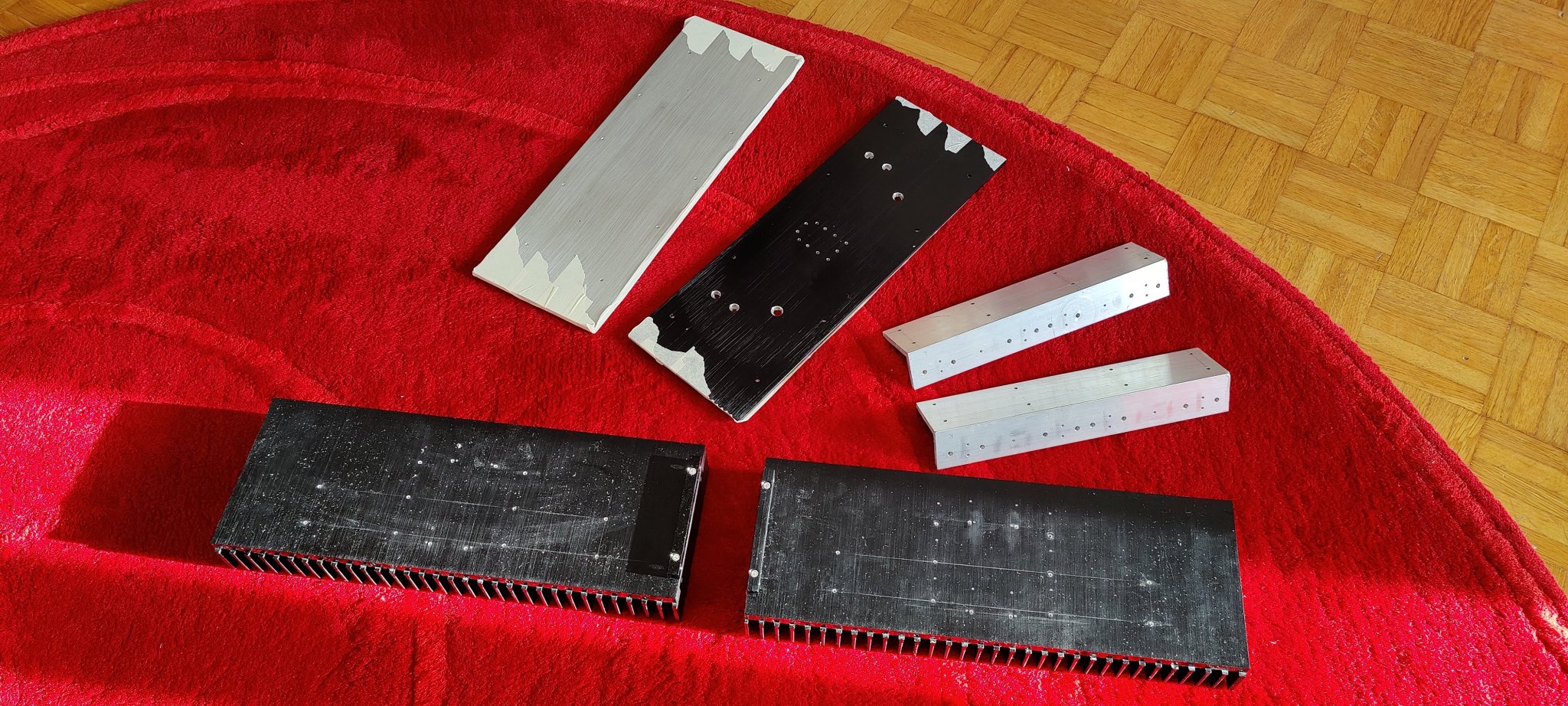

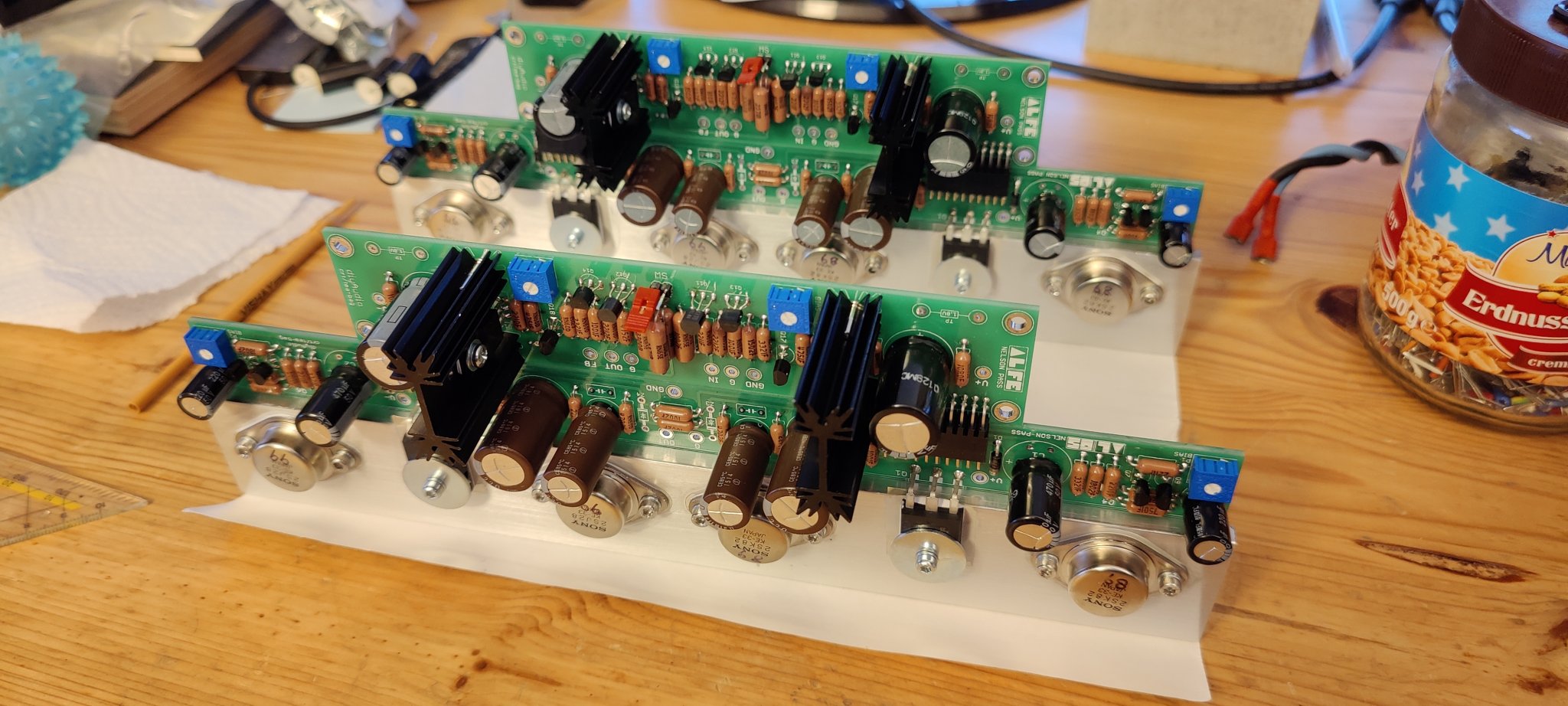

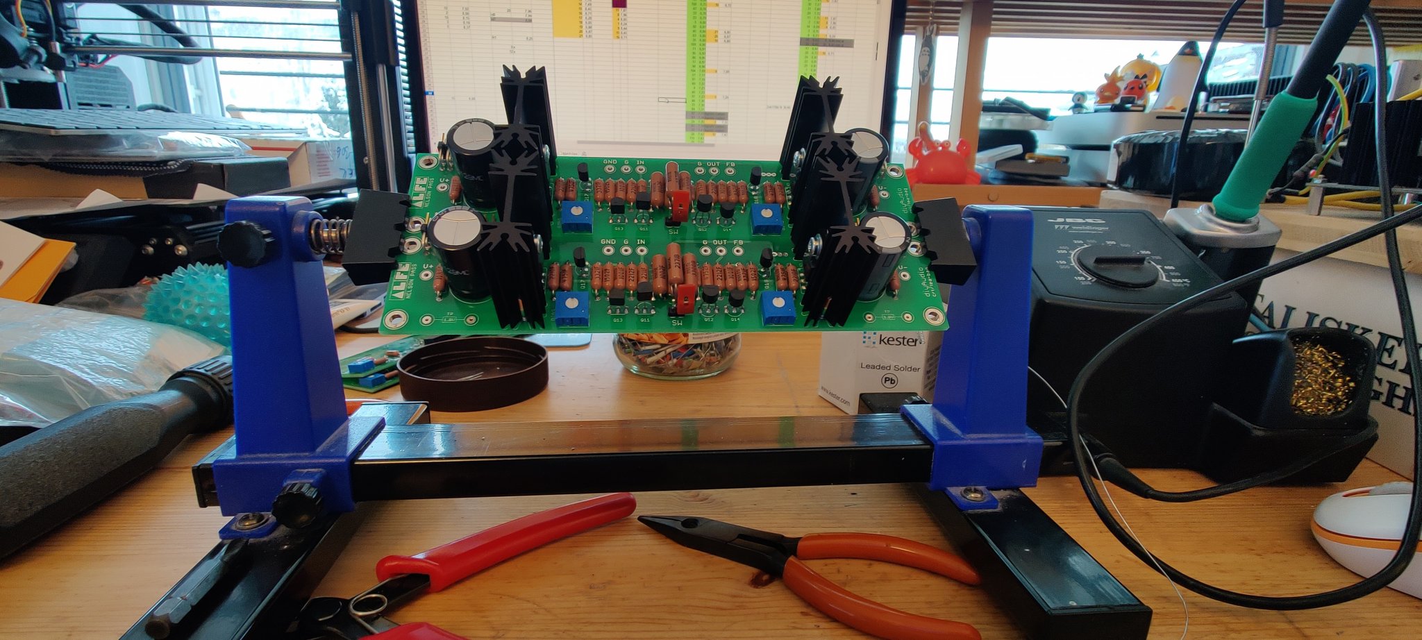

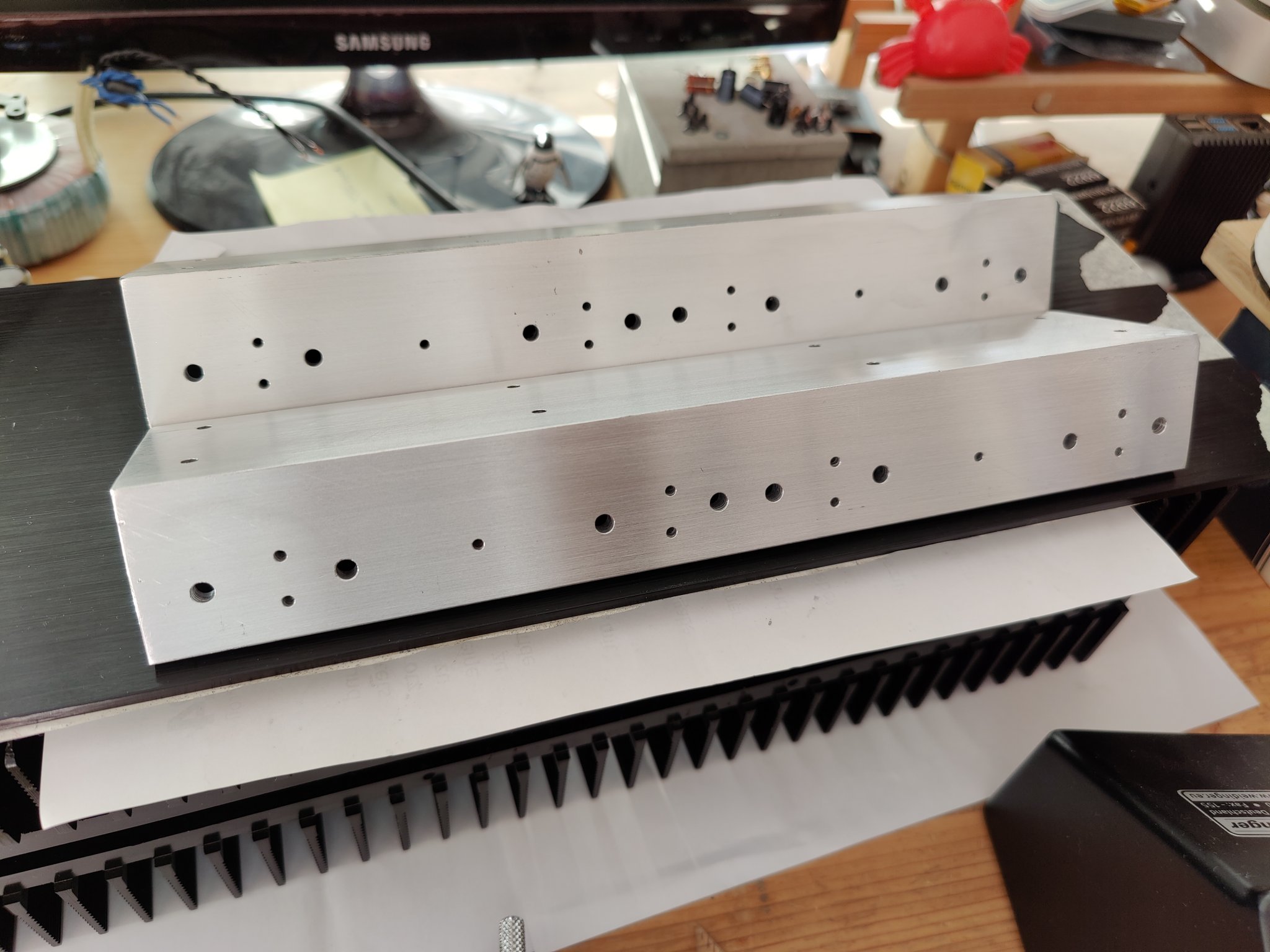

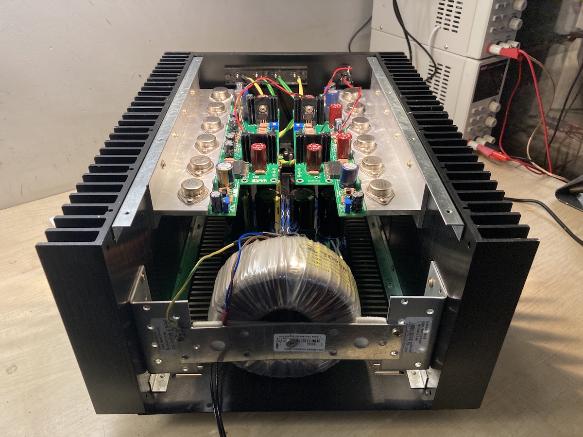

Another Sony VFET Amplifier Part 2 build with "AL" PCBs slowly coming to life. Took me ages to get moving, mostly because drilling and finishing the brackets takes a special kind of motivation that's not always easy to come by.

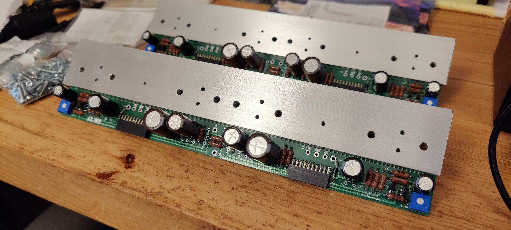

Putting together the frontend was more familiar terrain. RN60D resistors mostly, with some RN65E in the feedback network. I'm using a 5R degeneration resistor for the p-channel Jfet (and slightly higher Idss, so that it matches the N-channel with degeneration) in the frontend to make them more complementary.

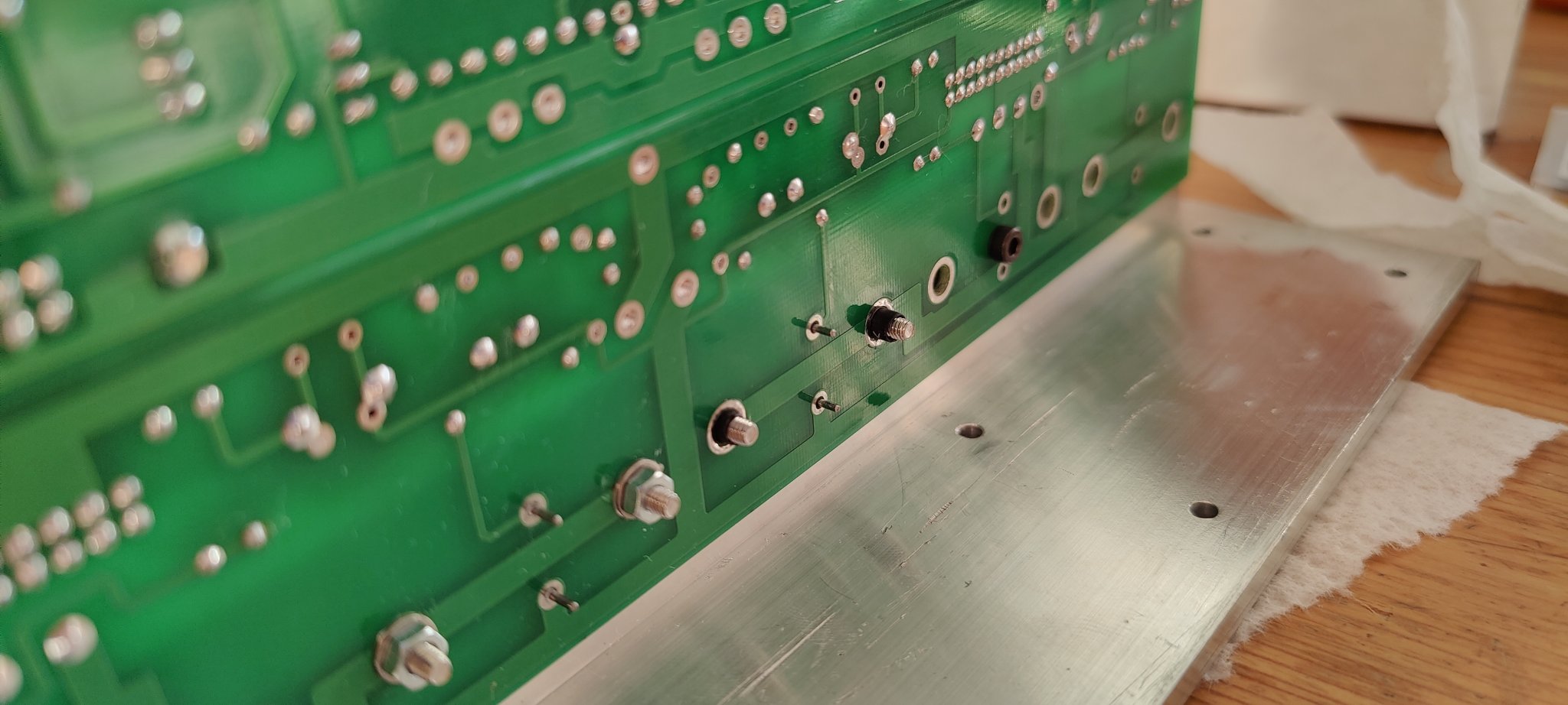

Output stages mounted to the brackets with two short screws from the back.

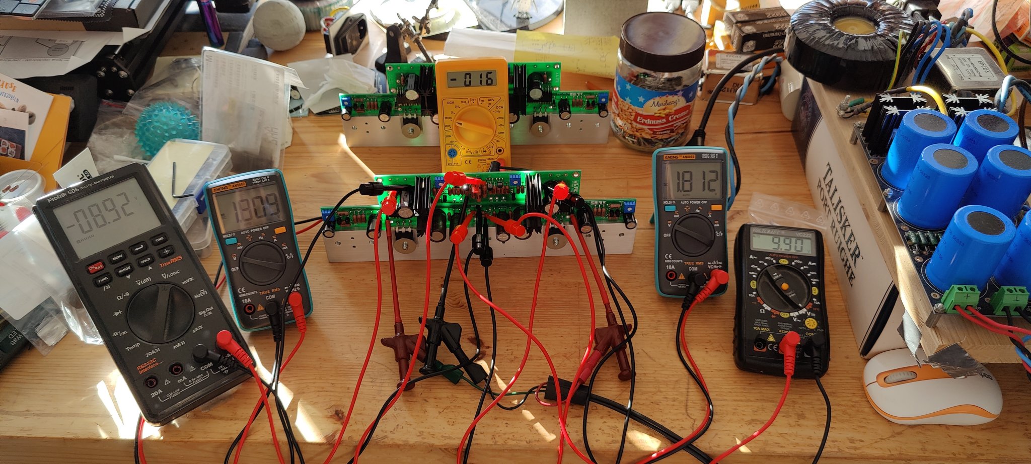

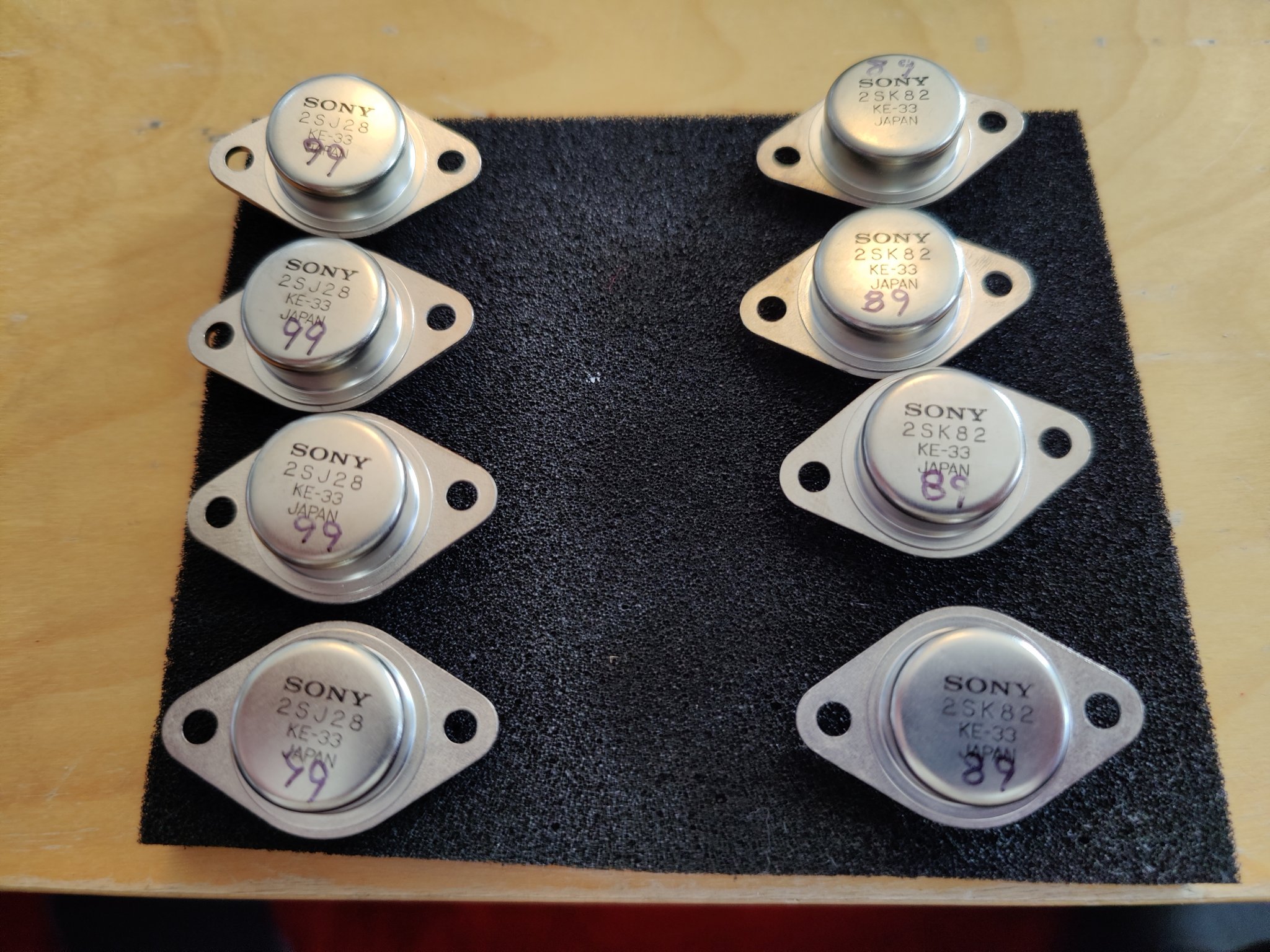

Now mated with the output stage, and powered up from a bench top PSU providing +/-28V. No smoke, and reaching all the bias points with ease (and the help of a fleet of DMMs). Final bias setup involved adding a Volt in the respective direction to the output stage bias.
No words necessary.
Beauty cream. (Kerafol Keratherm KP 97)
Shrunken heatshrink tubing to insulate the pins and bolts from the brackets.
I added a tiny dash of solder to the eyelets so that the washer would make good contact with the somewhat soft solder deposit.
Done for the day 🙂
Next up is mounting the output stages to the heatsinks and biasing them up with the V-Fets in circuit.

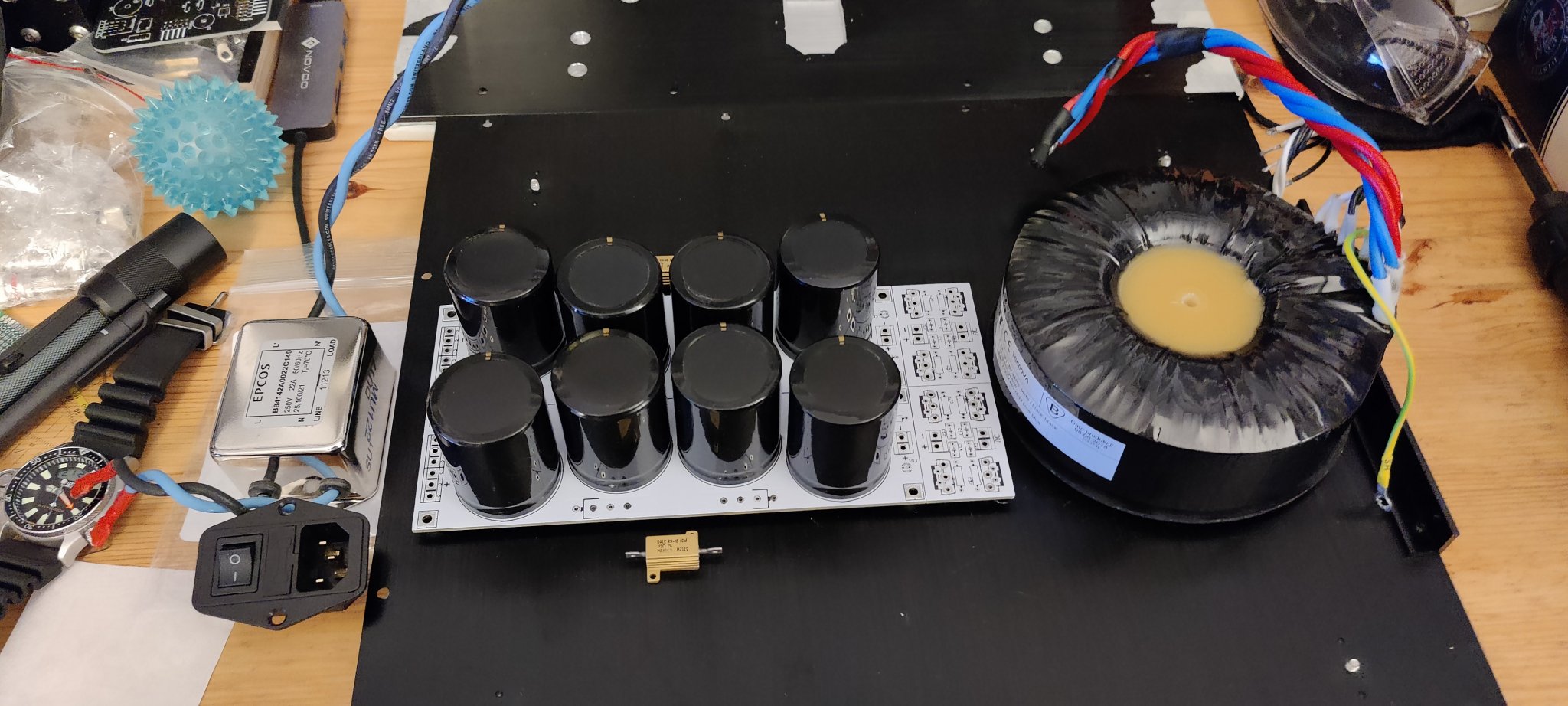

And then on to finishing the PSU and case. Here's what the PSU will look like, CCRCC:
Toroidy 2x22V 600VA, 8x33000uF 35V BHC caps, 10 0R15 wirewound.
Stay tuned!

Oooo-la-la! Nice looking build! I’d be curious to hear your impressions of the amp with and without feedback engaged.
I’m still sitting on parts for a CSX1 build and am curious to compare to my single pair vFet version and the single ended lottery amp.
