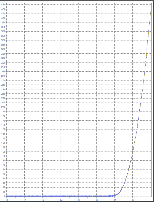

It looks like one of your 2sk82 has the marking. Try wiring up the circuit for 2sk82
with the vfet heat sinked and start with the pot adjusted so the gate voltage is at -19V.
Monitor the voltage across the 1 ohm resistor for current. At -19V you shouldn't
see current. Gradually increase the gate voltage (moving towards zero) at some
point you the VFET should start conducting. See if you can gradually
increase the current to say 0.5A.
The current to gate voltage should follow a curve like the sample
attached.

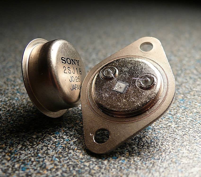

Can someone tell me if SK60/SJ18 from SONY TA-4650 can be used for VFET amp ?
I have collected the VFET board from diystore and everything except for the VFET transistors. I'm currently bidding on Sony TA-4650 but not sure if SK60/SJ18 in place of the SK82/SJ28 as listed in the PASS Vfet schematic.
If it can be used, do i have to adjust the bias, resistors, caps, or voltage rail higher/lower for Sk60/SJ18 ? Anything i need to look for if Sk60/SJ28 are used ?
Thanks,

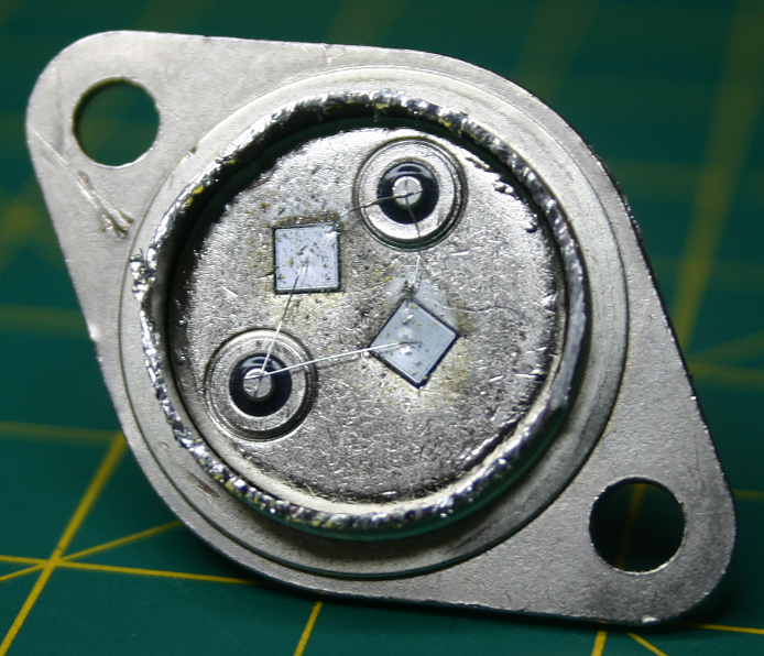

Well rumor has it that the 2SK60/2SJ18 (single die) are exactly half a 2SK82/2SJ28 (twin die). The electrical data suggests the same.
The attached pics show the internals of a 2SK82 and a 2SJ18.
I suppose you could build the amp with half the bias current using the 2SK60/2SJ18, giving you about half the output power.
I believe just lower Iq for, say, 30% and you're good
Ahh i see, thank you Rodeodave and ZM, so 2sk60/2sj18 are exact drop-in replacement for 2sk82/2sj28 since they have the exact same pin out, the only caveat is lowering Iq to 30% to 50% as they only have single die vs dual die as in 2sk82/2sj28
