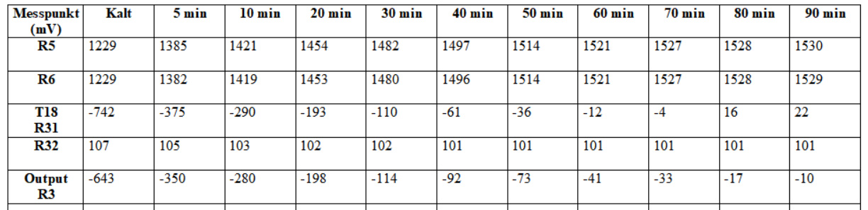

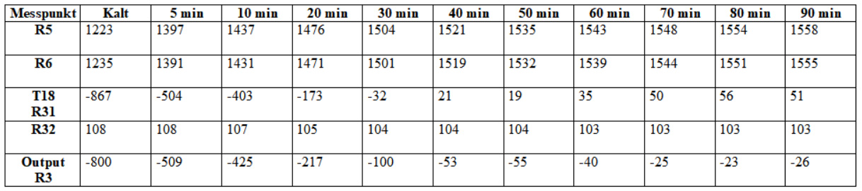

today i was wondering if there is any drift in the bias setting with the time , so i measured the amp after almost 18 months. the result : yes there is some 🙂
at the left channel T18 was drifted from initially 7mv away up to 270mv but the rest of measurements were within the range.
at the right channel T18 was around 190mv (initially 6mv) , but the output DC offset was 350mv!(initially 19mv).
so to stay on the bright side of life, it is probably good to check the bias at least once per year and re-adjust. ;-)
any similar expediences with your vfet amp?

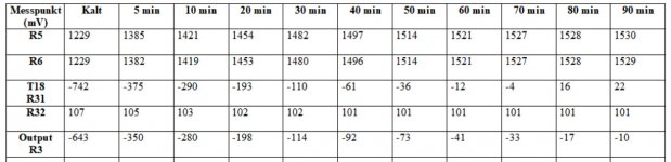

yes, you are right; this is why the settings have to be done always with the lid on and i have been doing that as well. for that reason i use 5 DMMs for the ease of work 🙂
usually i measure the the bias every 10 minutes to get an idea how the changes are for about 90 minutes and fine adjust. the values over R32 , R5 an R6 do not change that much, but the rest (output DC, T18) continue to change and there no "saturation" even until 90 minutes. However, the most of the changes (highest slope) happen within the first 30 minutes, so i am good if i set up the amp after 60min and fine tune after 90 min. 😉
