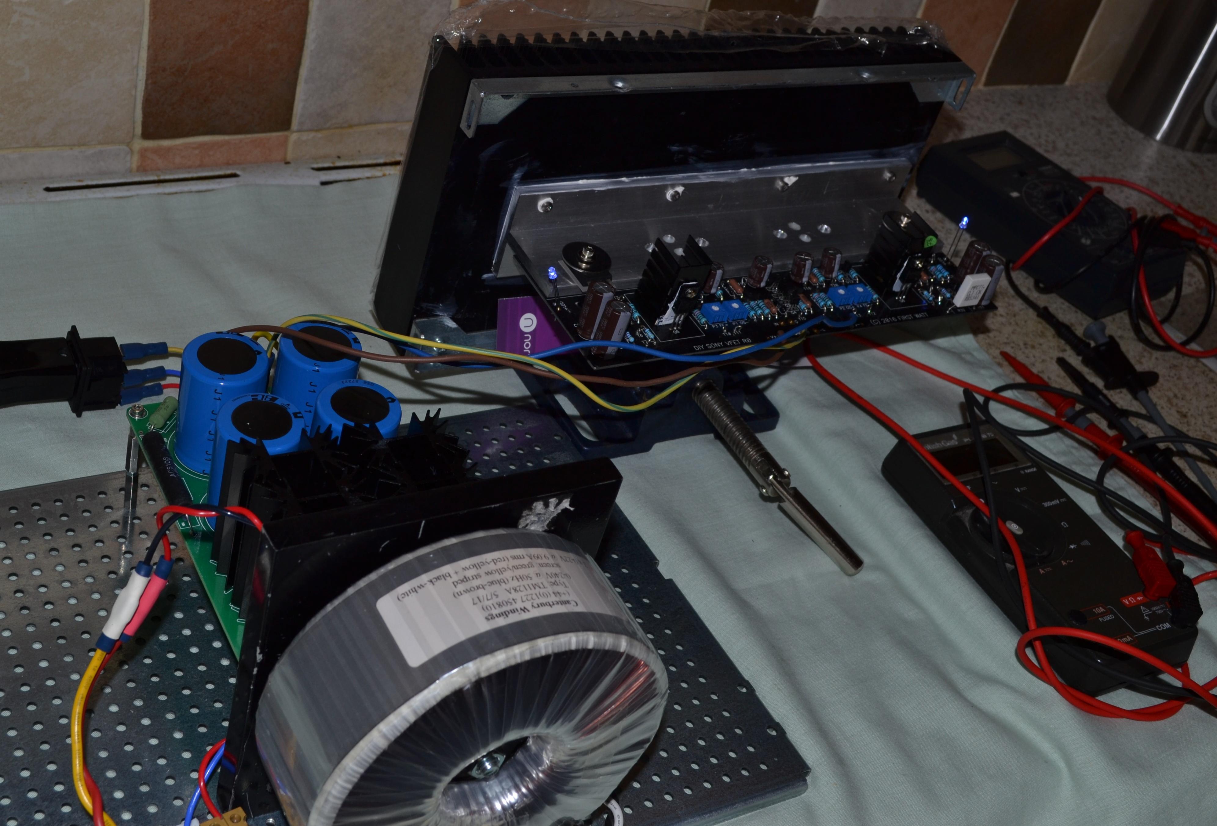

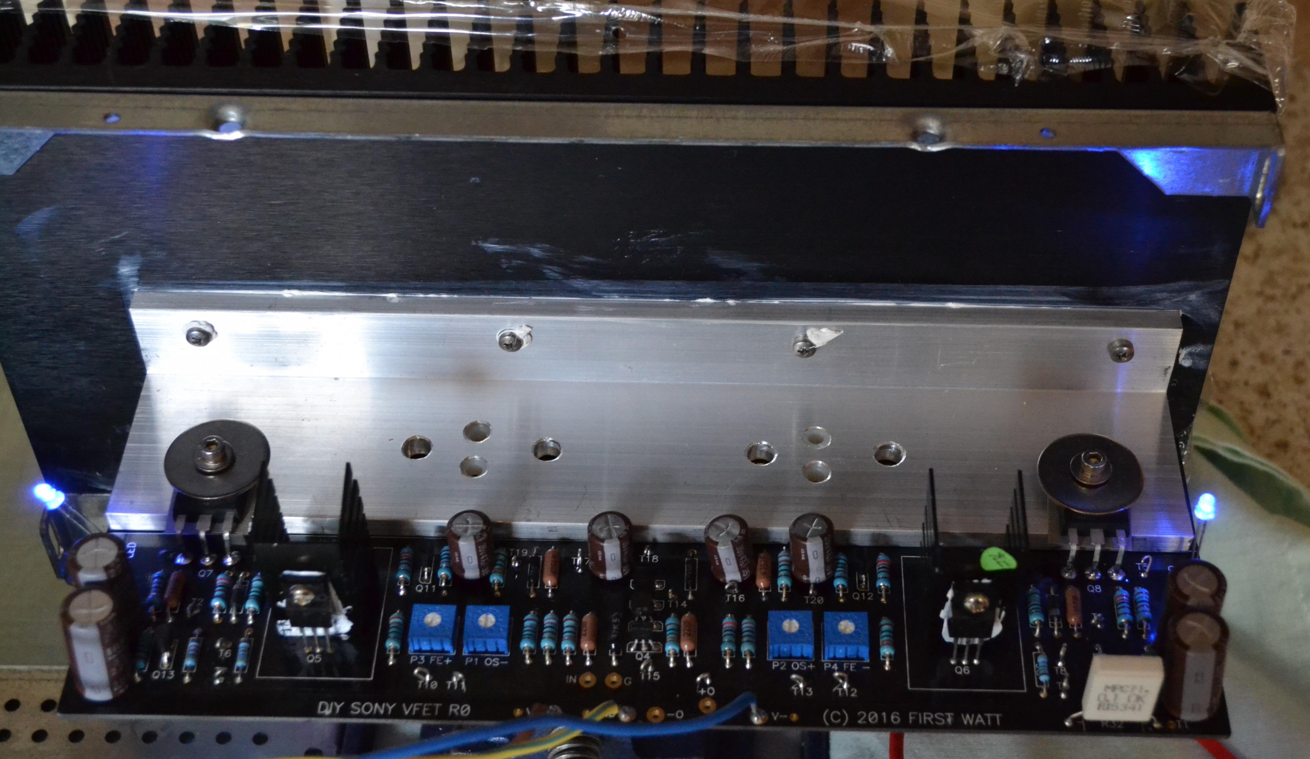

Here are my right and left channels.
My VFETs were not the best matches.
The front end outputs were at about .01% distortion with no global feedback at 2.8 Vrms. No third harmonic. Offset minimum.
I haven't had a chance to adjust the cascode feedback resistors, but I will.
I have been trying 2.3K and 4.75K and no feedback

Hi Marra,
I suspect your G-T18 reading is mostly coming from T6-T7 and T8-T9 being different. Are P3 and P4 fully counterclockwise? It looks like you are using
Toshiba mosfets and perhaps a combination of low Vgs and high Idss of the jfets
mean they are already on and conducting.
If you increase P4 slightly so that T8-T9 increases closer to the 0.124 T6-T7 then
the G-T18 voltage should drop.
Dennis

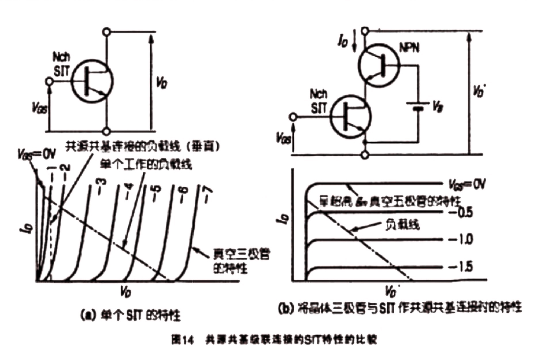

Not really - there is still a lot of Vds variation with signal. The original intent was
to shield the VFETs against rail noise and provide low turn-on currents. The small AC
modulation that you do see is to maximize the peak swing.
However, it points out an opportunity to trim the AC voltage experienced by the
VFETs against the load values.
