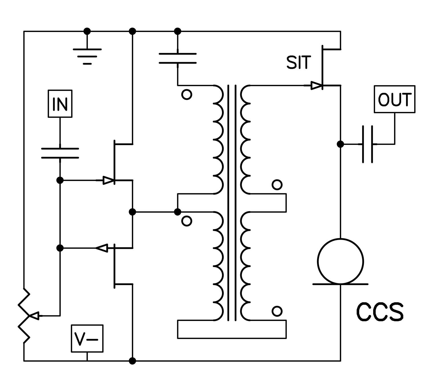

Call it the SIT-2s for all the twos. Two jfets, two primaries, two secondaries and two output transistors. Keeping in mind the CCS could be a resistor or a mosfets that doesn't amplify.
More about the visual symmetry for me. 🙂
