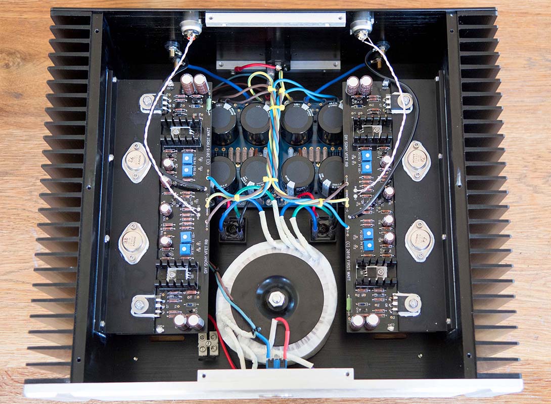

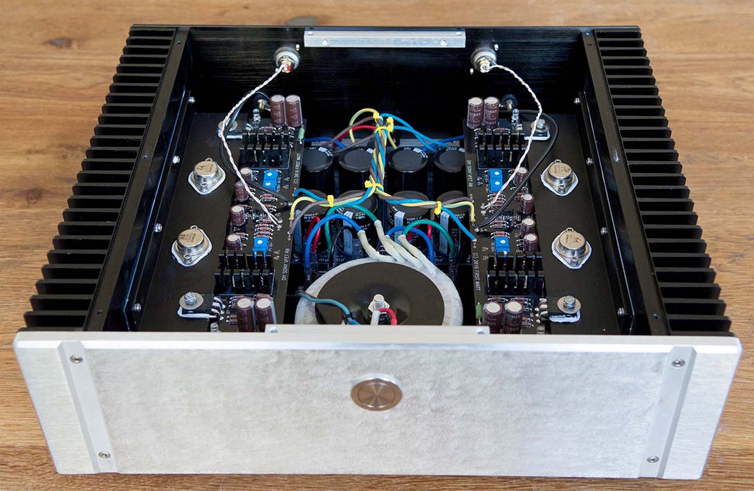

I finished my Pass Sony VFET amplifier. Big thanks to Nelson Pass and diyAudio store making this project possible. I love it, sounds great. Was fun and easy to build also thanks to this forum, the members and all the good info and tips, thanks 🙂.
